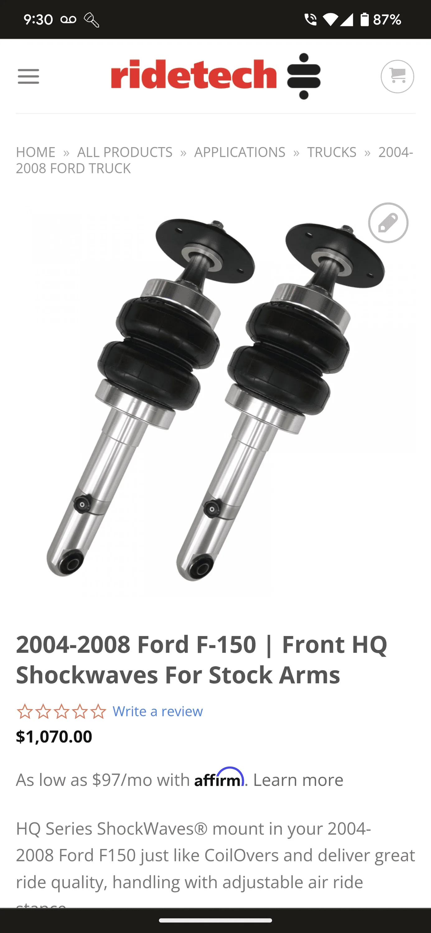

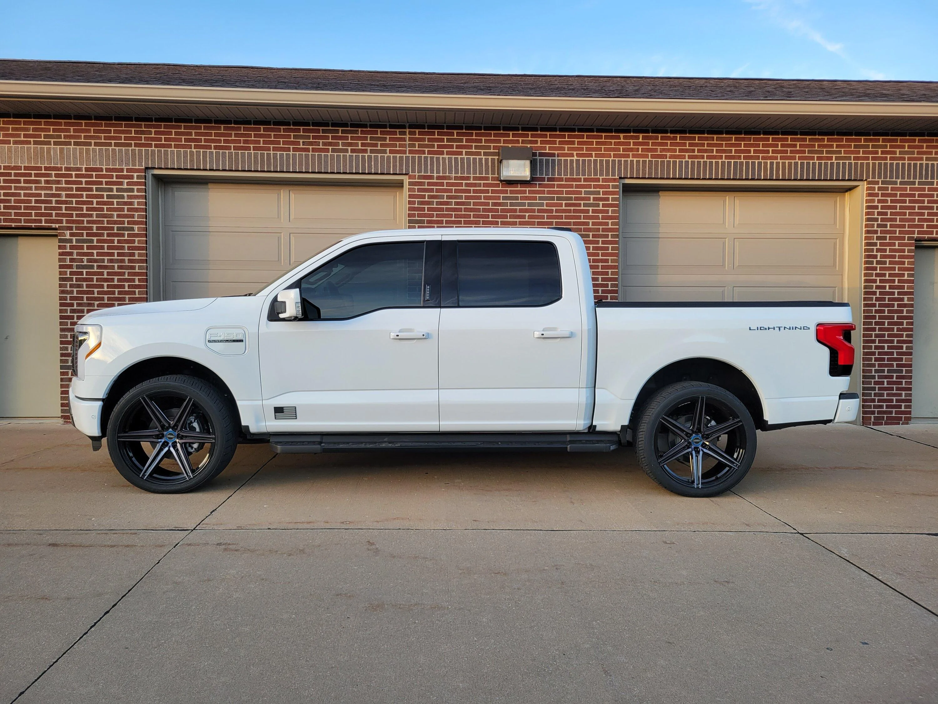

Hey Guys, belltech part number 25001 is bolt on for the rear and gets 3" of drop. Everything works as per factory specs except on board scales. There's a ridetech air strut that bolts into the rear for a 6" max drop, which is what I switched to now. Front is basically any ICE f150 lowering strut.

@GurmukhHundal what is the ridetch part number? How do you like the air shock?
I heard there maybe a camber issue at >3” drop on rear, did you have any issues?
ridetech says “vehicles weighing 1,500-2,500 lbs. per axle.” I would think this is not strong enough?

Great looking stance!
How big of a front drop did you do?
How did you fix rear camber issue?

Hey, there's definitely negative camber but the tire shop maxed out to minimize it.
