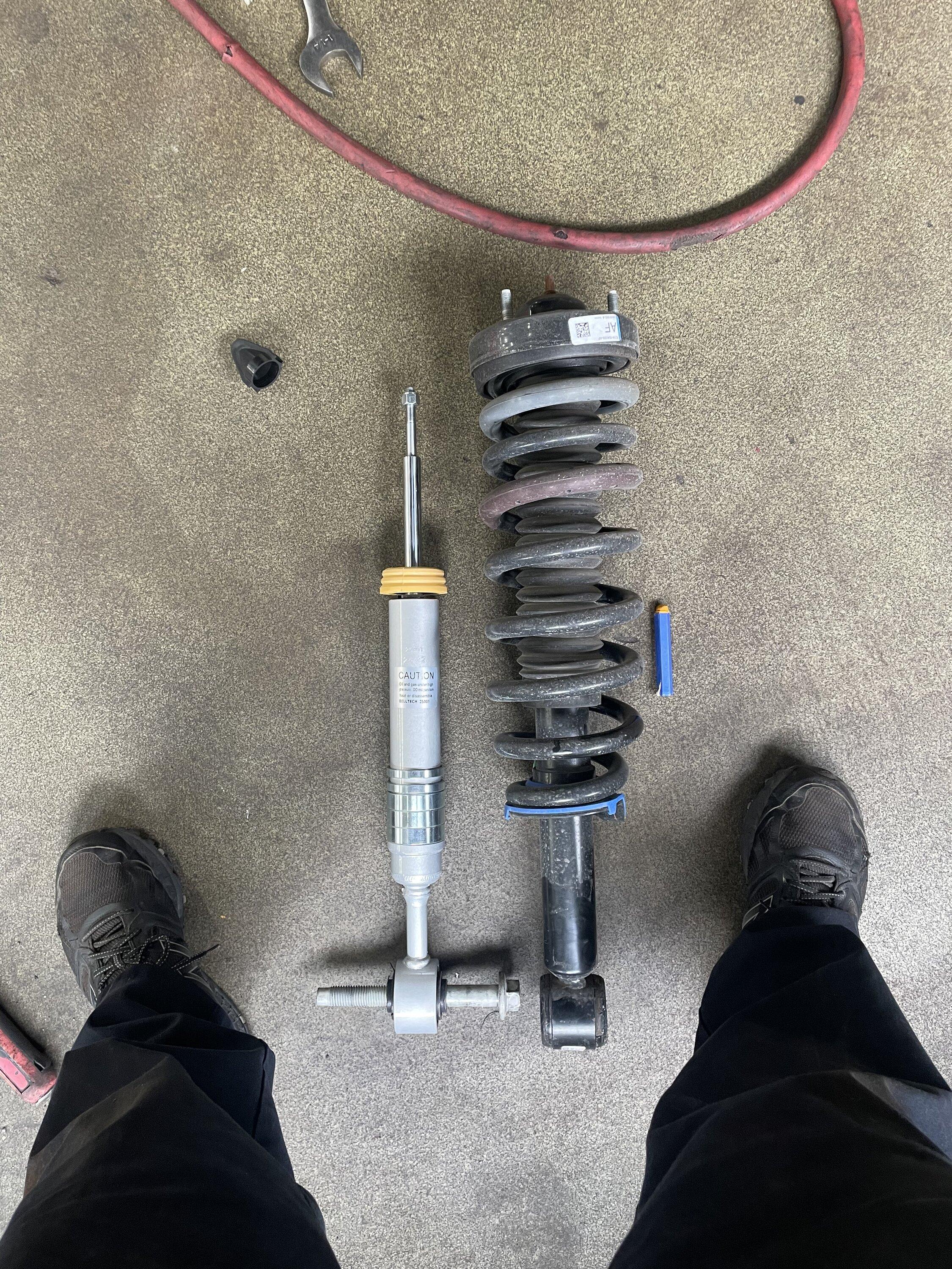

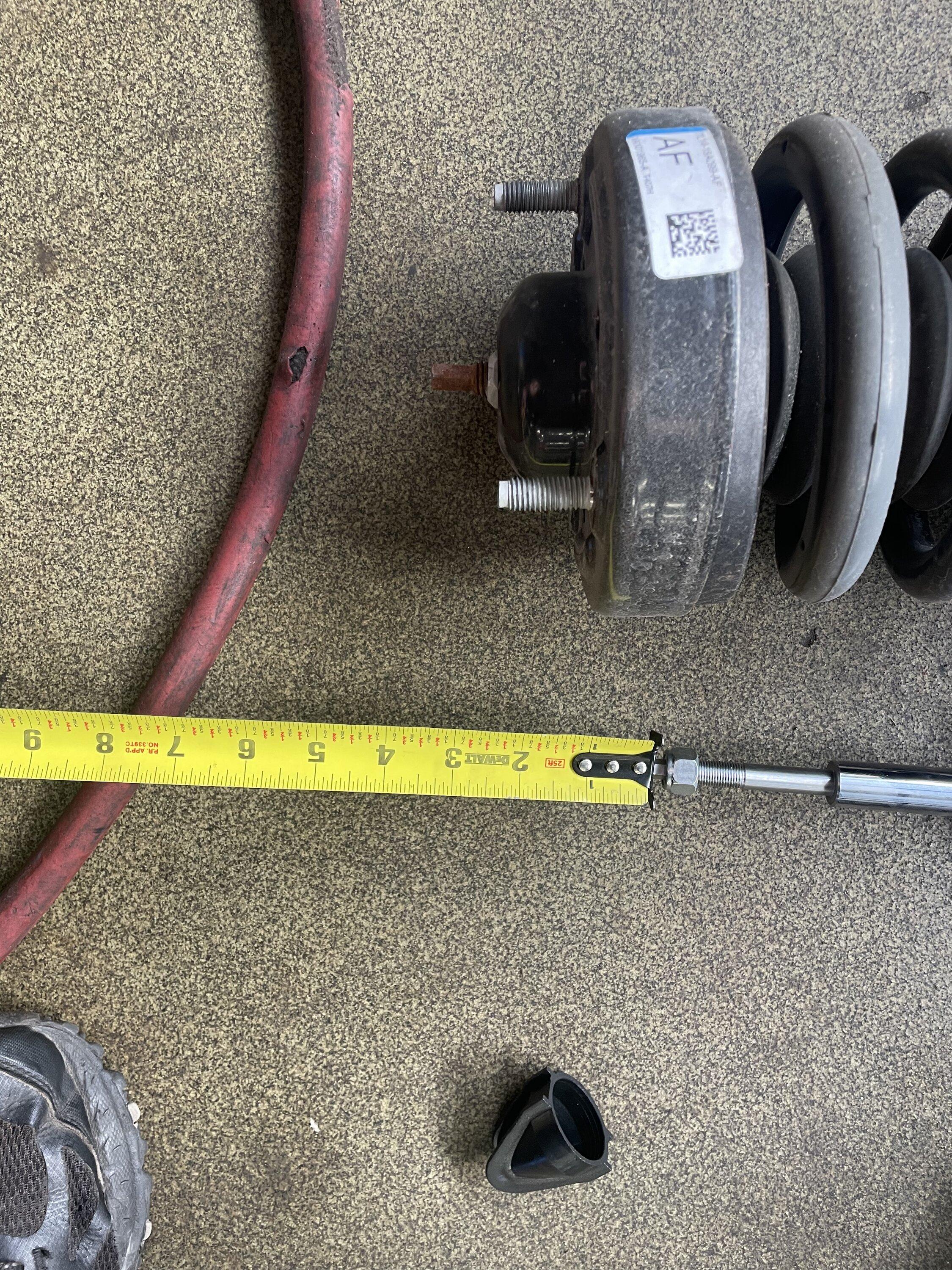

Just tried using the belltech 25001 to lower the rear of my Lightning 1-1.5”. Did not work. Looks like it would be great for 3”. The strut is about 3 inches shorter on the spring installed side. So less than 3” would increase spring tension and have reduced travel

Not for me. I only wanted a one inch drop.

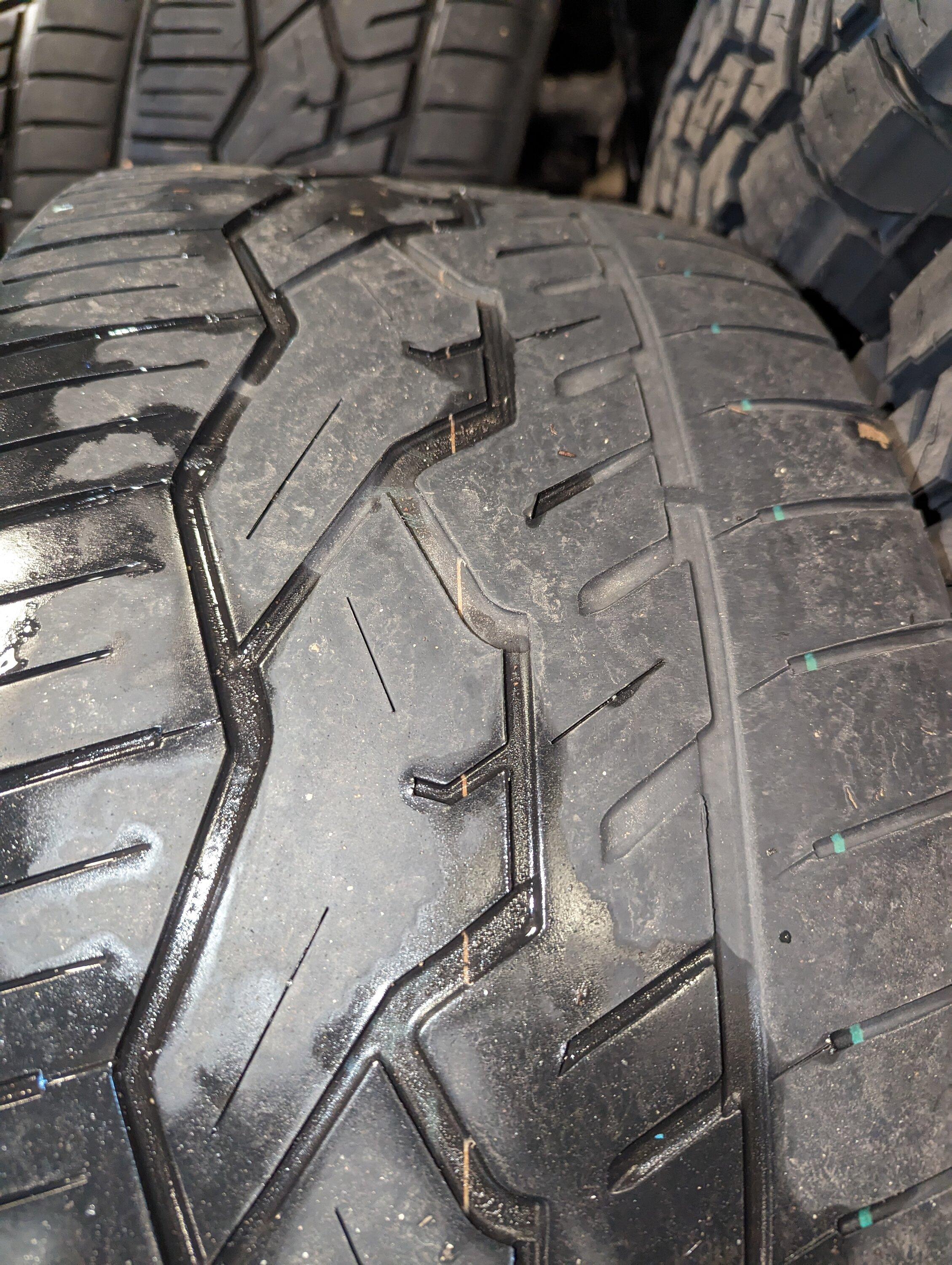

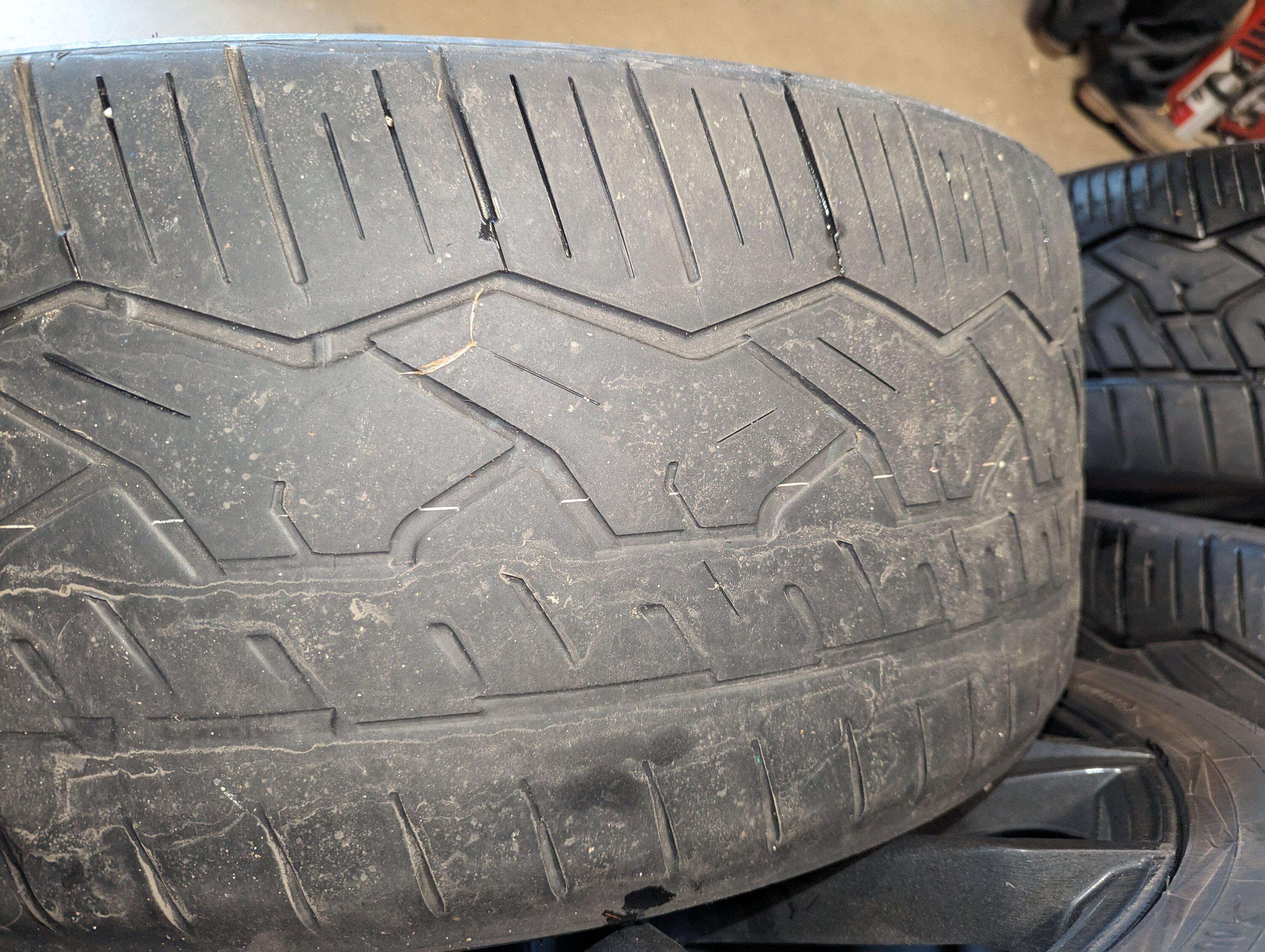

Tire wear has definitely been uneven for the rears. These were the rears after about 35,000kms. I've now switched to a 10ply tire that I should get a bit more life out of.
Got it. and is that mostly on the 3" drop or the 6" bagged drop? Im putting together my own now, proj just doing the 3" version
