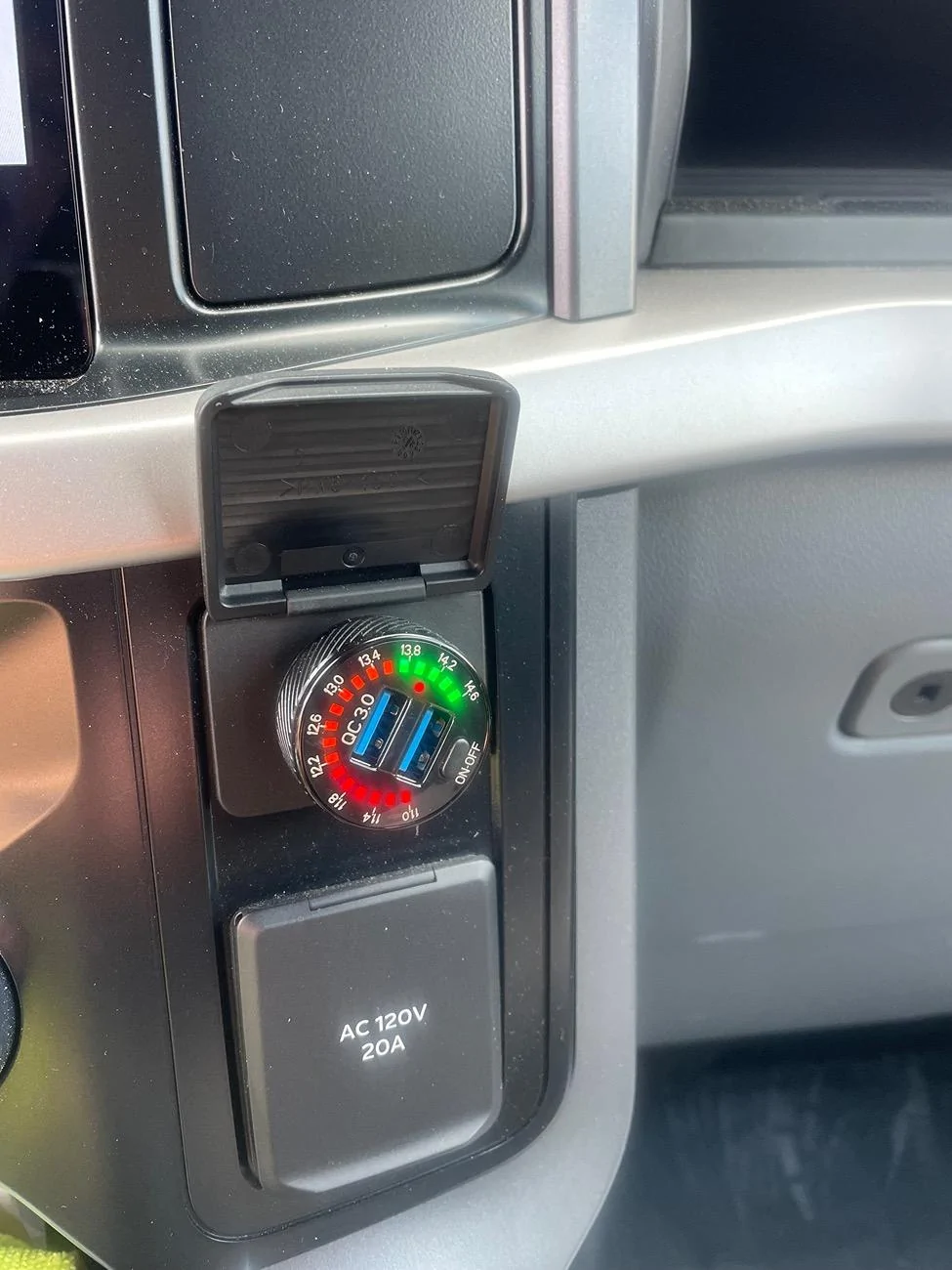

LVB simple check via cigarette lighter for $15 from Amazon, you can see the battery volts or charge at a glance ,

Ford F-150 Lightning LVB simple check via cigarette lighter for $15 from Amazon, you can see the battery volts or charge at a glance , where to connect to LVB

As important as this battery is, why do you as the owner have to go out and purchase another piece of equipment to show the LVB state, when it would be good to add to to the dash!
I got spooked by all these forum posts . But I also did this with my previous trucks as their voltmeter gauge was not helpful.

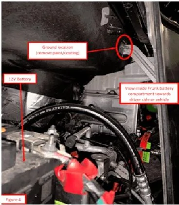

Ford F-150 Lightning LVB simple check via cigarette lighter for $15 from Amazon, you can see the battery volts or charge at a glance , where to connect neg for battery charger
This image shows one place to connect the negative of a battery charger inside the access panel in the frunk.
"...External customer loads must only be connectred [sic] to the vehicle at the customer battery connection point. If an eternal customer load is connected at the negative battery post, the Battery Monitoring Sensor accuracy cannot be guaranteed. It is recommended that the Battery Monitoring Sensor pole clamp is not removed unless a battery replacment is required. Shoud the battery need to be isolated, this should be done by disconnecting the ground eyelet at the chassis ground...
