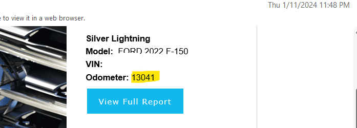

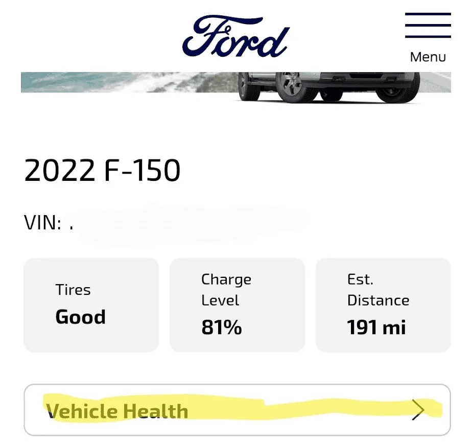

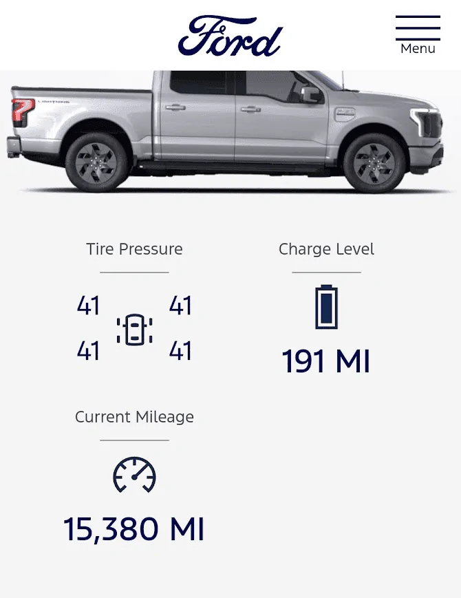

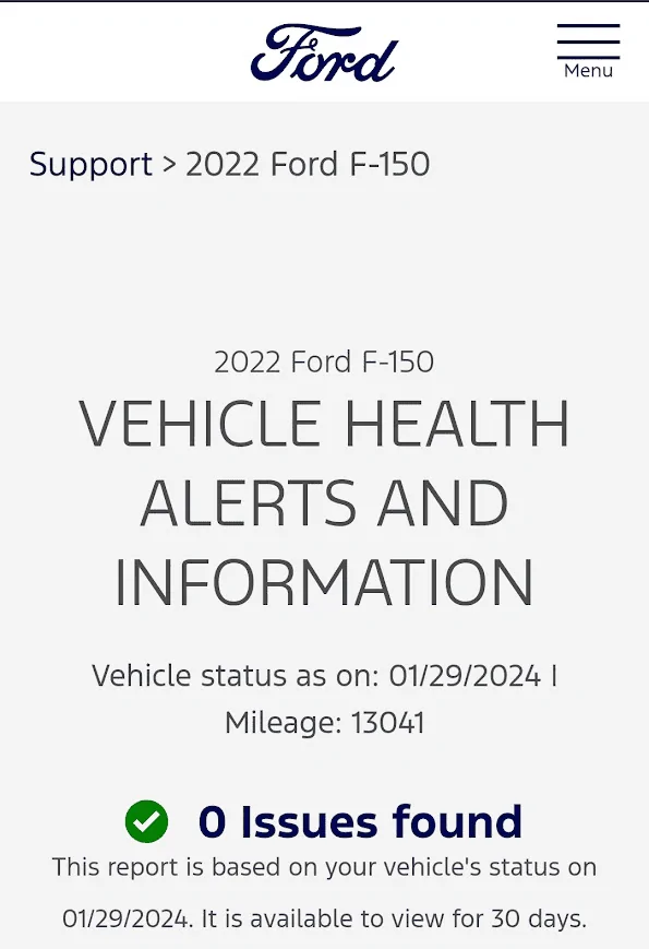

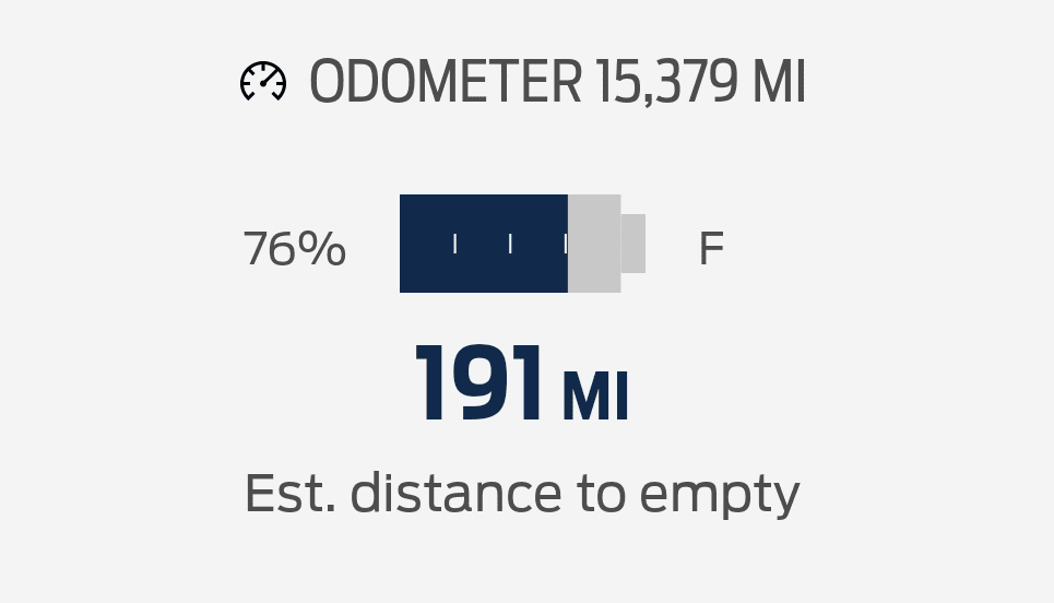

We've observed and reported about this problem in older threads, tagged @Ford Motor Company , I've also submitted FORD.COM site concern reports and random survey feedbacks about the issue, crickets about them fixing the issue. The discrepancy is in the VHR {Vehicle Health Report} that you request manually or receive as scheduled email if requested previously.
True mileage match to IPC 15,379 total miles
Ford F-150 Lightning Mileage in truck doesn't match website 1706561027238
Ford.com vehicle information screen rounded up to 15,380
Ford F-150 Lightning Mileage in truck doesn't match website 1706561074707
FORD.COM Vehicle health report screen shows 13,041 which was my milage the week of 10/16/2023
Ford F-150 Lightning Mileage in truck doesn't match website 1706561141537
Ford F-150 Lightning Mileage in truck doesn't match website 1706561157352
Most recent emailed VHR on 1/11/2024 stale data of 13041
Ford F-150 Lightning Mileage in truck doesn't match website 1706561318731
