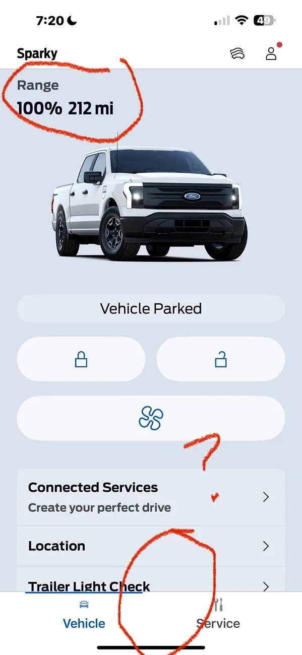

All of a sudden, the 'Energy' tab at the bottom middle portion of the app is gone (see pic). This means I cannot start/stop charging whenever I want, set charging times, etc. I have taken it to the dealer and they performed all software updates, checked the modem, 12v battery (I heard there was an issue with some), etc.
They said everything is working as normal and it's a @Ford Motor Company issue. I have updated my phone's OS, deleted and re-installed the app several times, tried the app on other phone...everything. Has anyone experienced this issue? It's such a pain and never realized how much I relied on the Energy tab before. Thanks!

-iPhone 14 Pro with OS 18.1.1 Didn't work with OS 17 either.
-No PAAK - I believe Pros can't get it
-What do you mean connectivity turned on?

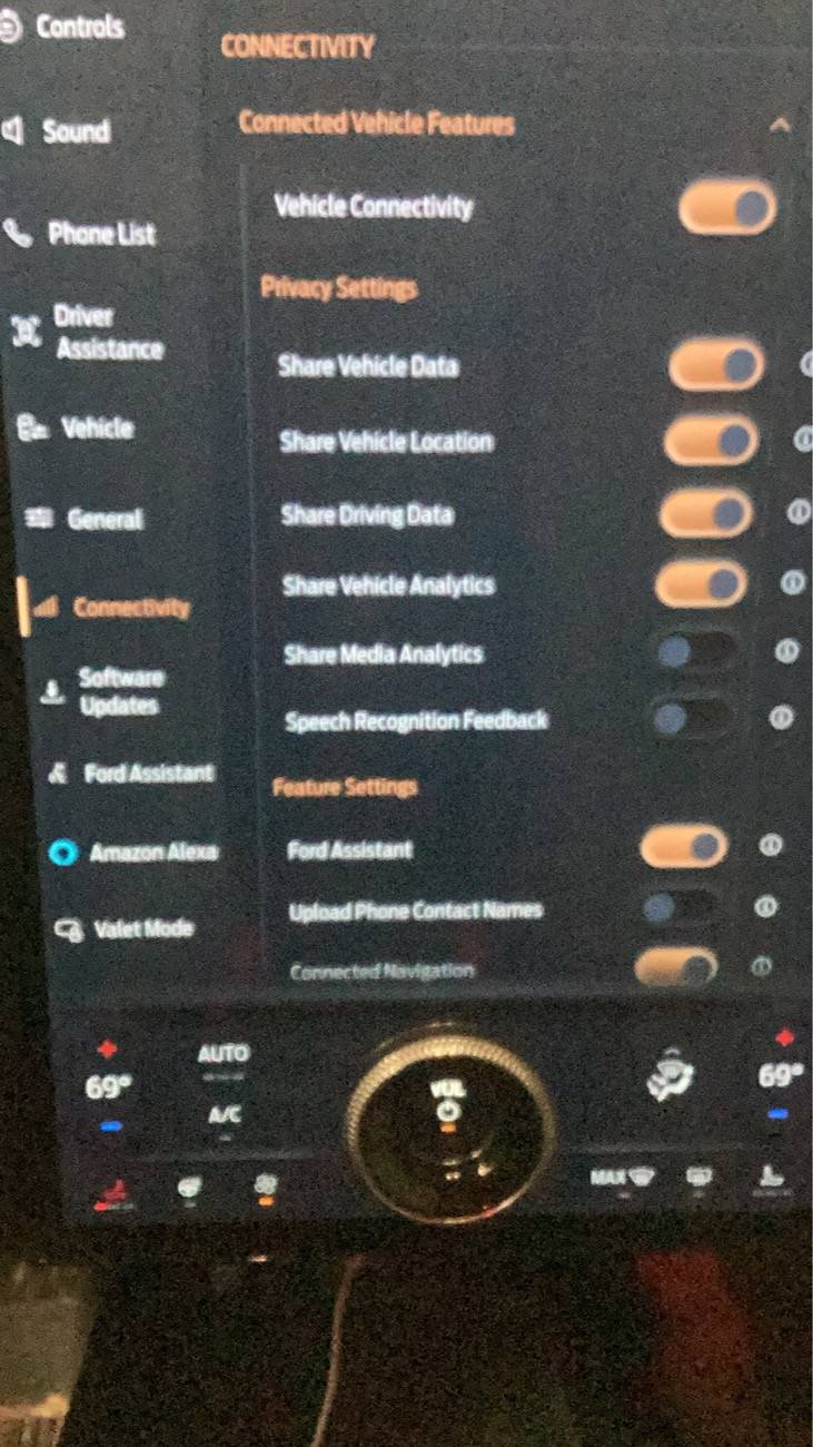

In the truck, there are settings to turn the connectivity off and on. I would maybe try those settings, turn off then back on.

Make sure to consent to most if not all the privacy approvals on the screen @Maquis is showing you, note the drop list items below "Connected Vehicle Features" some of these settings might have changed due to an update.
