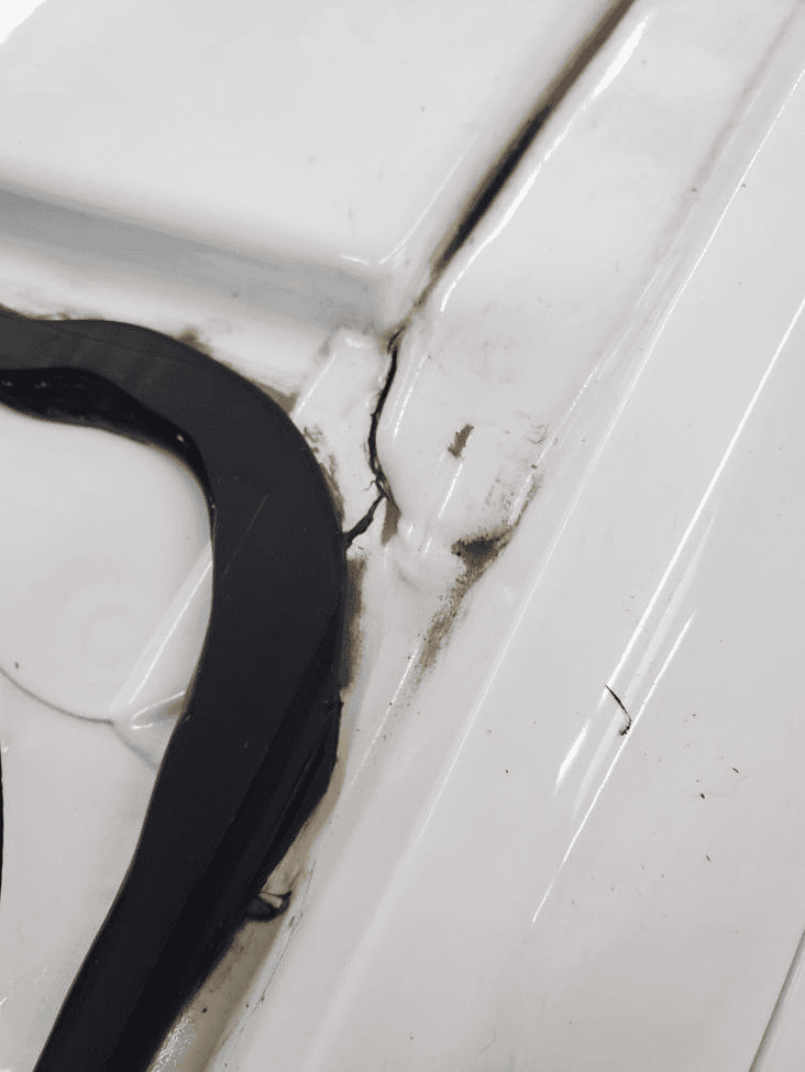

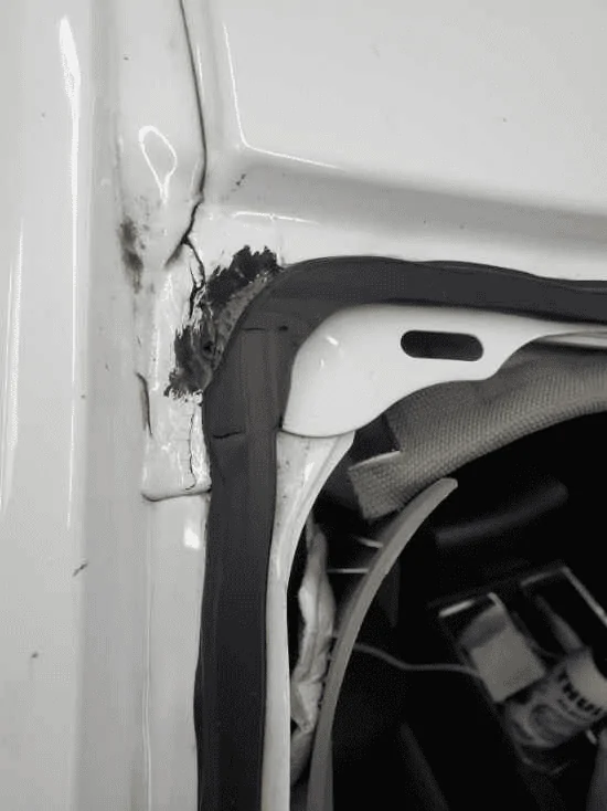

Update on this, for anyone interested...
My moisture infiltration issue wasn't like any of the others I've seen reported on the forums, to date.
Dealership technicians found extensive mold and mildew throughout the cab of the truck.
The removed the floor carpet, seats, headliner, and dashboard and discovered a faulty pinch weld on the passenger side front pillar.
Upon reporting the situation to Ford, they were instructed to fix the faulty weld and replace all of the above interior components, except the dash.
They had my truck for 6 weeks, but completed the work as instructed while I burned up the miles on 3 different loaners.
When I picked the truck up they noted that the issue appears not to be exclusive to Lightning, as they had just taken in an ICE F-150 with a similar issue.
Took the truck on an 1,100 mile road trip last week - SOOO glad to have her back!
P.S. - the pesky Air Dam fault is still there!

Passenger A pillar.
I wasn't given a chance to see the actual faulty spot, but was told it was mid-way down the pillar.
Dash had to be removed to find it, as they did not find it upon an initial, quicker, inspection.

The documentation and verbal details on what was done were slim I'm afraid.
They only said that a pinch weld on the A pillar was repaired and resealed.
Good news is that so far I've had no further issues, of either water infiltration or anything else residually related to the work done.

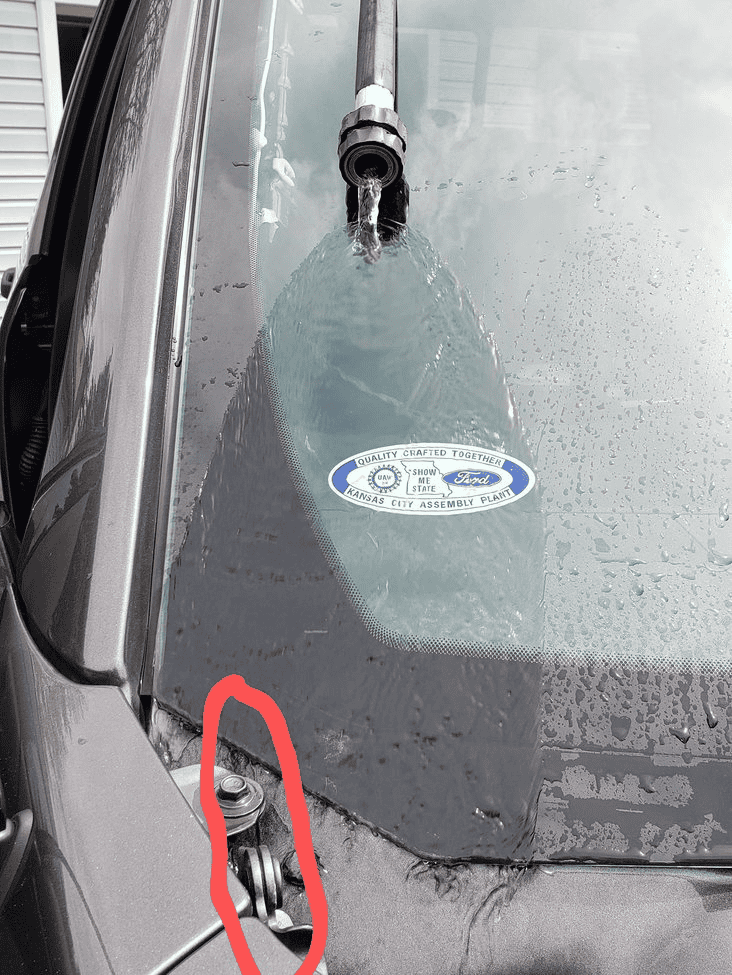

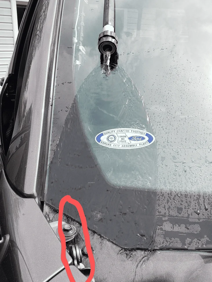

Read this F150forum.com thread: https://www.f150forum.com/f118/water-leak-cowl-seam-474781/?ispreloading=1
It is the same problem that exists on our trucks. Water is making it's way into the cabin via the firewall cowl or the body seams at the top and bottom of the windshields. This is why even on trucks without sunroofs, water still finds it way into the cabin.
