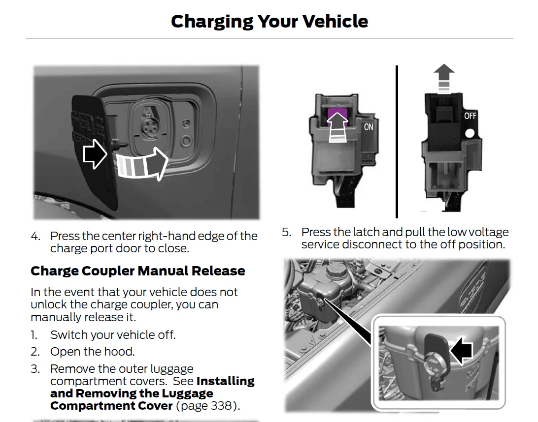

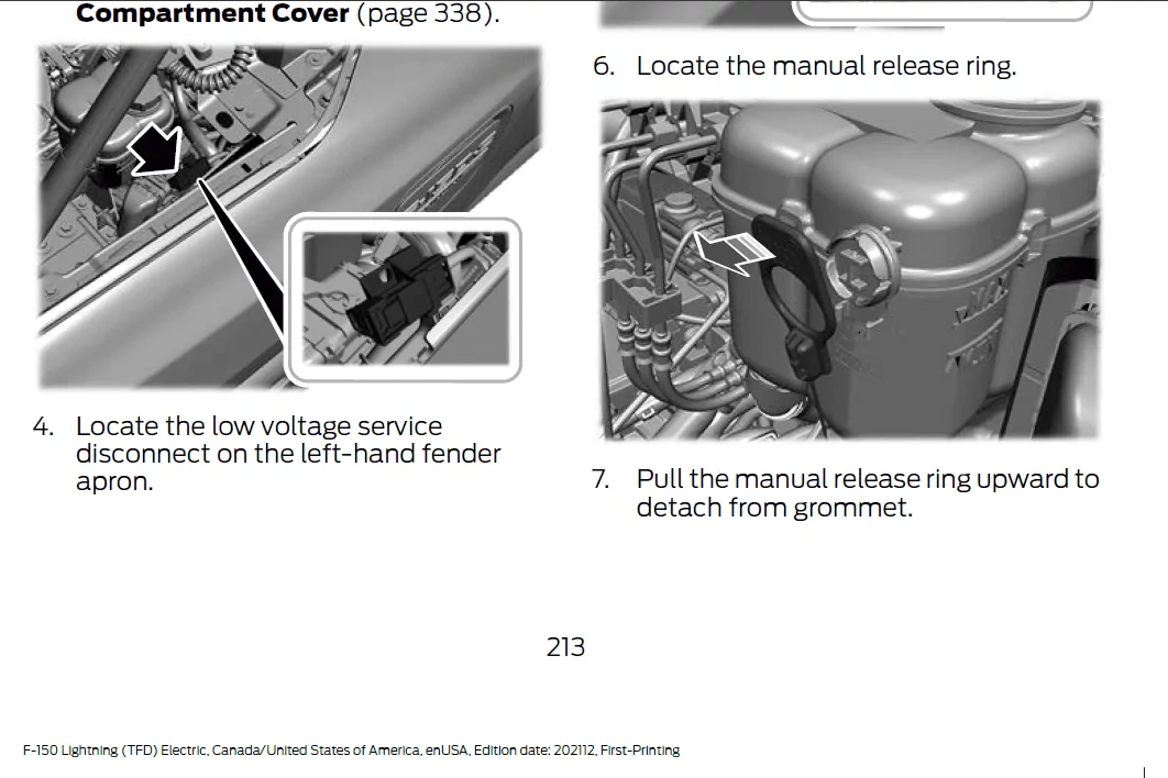

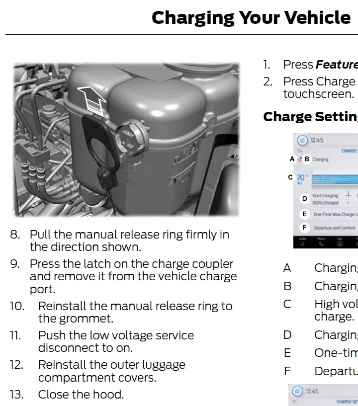

You can't unplug with the manual release?
Yes, I was able to u plug that way, I’m glad Ford included that feature. Two stations shut down, one dude on the third station is pissed because his Ioniq 5 wont charge. What a mess.
