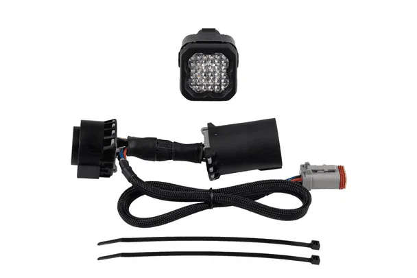

Diode Dynamics have done it again! They just announced their new HitchMount LED Pod Reverse Kit.
If you want a quick and easy way to install a single reverse light/brake light on your truck, then this is it.
They took their SSC1 and re-vamped it to fit in their patent pending hitch mount. This slides right into your existing hitch mount and plugs in-line with your factory 7-pin trailer connection (behind the bumper, where you won't see it).
It's available in 2 configurations.
The C1 is your standard reverse light. Comes on when you go into reverse.
The C1R kit integrates a red LED so that when your lights are on, there is a faint red glow. Step on the brakes, it glows brighter. Go in reverse, you guessed it... white reverse light outputs.
A quick and easy option if you want a bit more light back there for backing up.
Available now for pre-order. Shipping ETA is currently 11/18/2022.

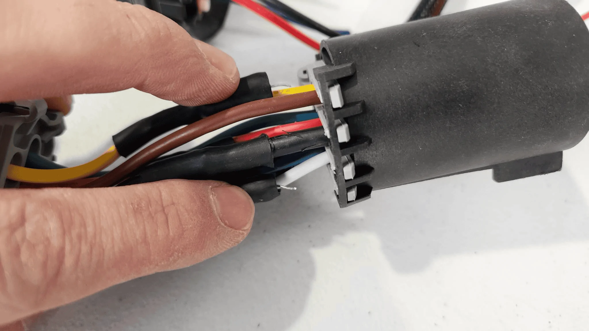

For those who have received these from us your truck MIGHT think a trailer is connected. This a known issue by Diode Dynamics and they are fixing all future kits. It's a VERY simple fix if you already have your kit.
1) Remove the black tape on the trailer harness
2) There are 2 resistors. One resistor goes from BLACK to YELLOW and the 2nd resistor goes from BLACK to WHITE. Look for these
3) CUT the resistor wire (it's the exposed metal wire). I recommend cutting it FLUSH with the resistor/wire.
4) Re-tape your harness
That's it.
Basically Diode Dynamics installed 2 resistors on the harness which don't work on Ford vehicles, as the Ford trucks think a trailer is connected and will disable your cross-traffic alert system.
If you don't do this the Hitch Pod WILL still work, but your cross-traffic alert system will get disabled. So simply cut those 2 resistors and it'll fix the issue.
We tested this in-house AND Diode Dynamics tested this in-house also (they provided us the instructions to test on some additional Ford trucks like a Lightning).
Here is one of those resistors shown with the wire still sticking off (cut it flush)
