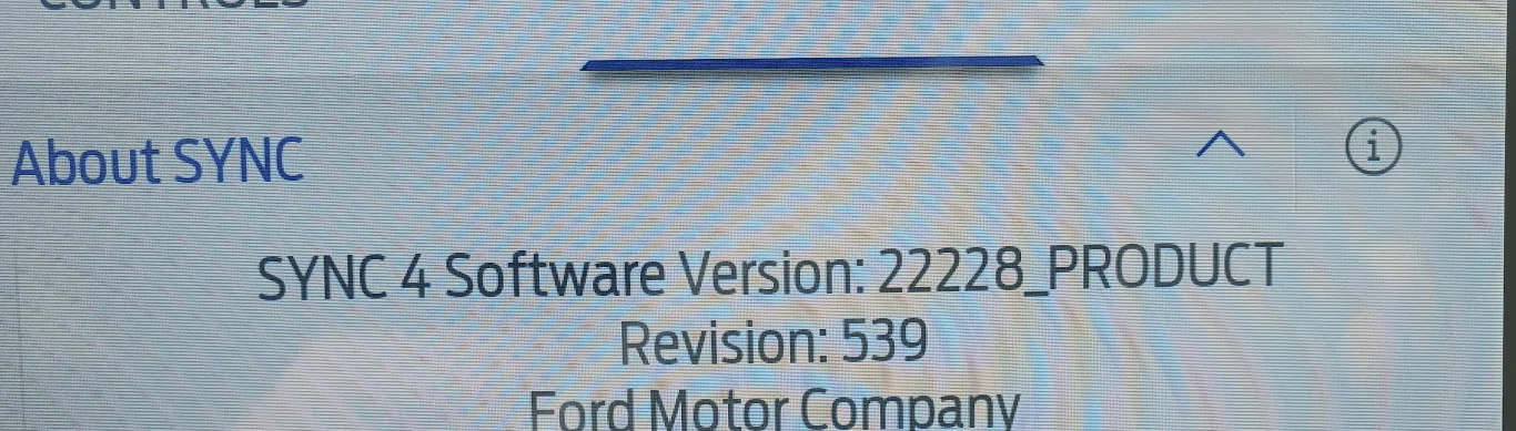

My Sync screens says all updates are updated at 3.1.
A month connected to WiFi and still nothing.
I am going to take her into the dealership to find out why.

The snap shot in post 9 was from the trucks Sync screen, showing version 3.4, this was done 8/16.
My truck updated sequentially from 3.1 over the course of 12 days from when I took delivery, this is what it showed on delivery day 8/4
The Sync screen will always show the version of Sync you are on. It tells you nothing about OTA (Power Up) updates.
The screen that shows you the Power Up updates will eventually say "you are up to date". You won't know what the last update was, nor are you "up to date", although you have no pending queued up updates.
You CAN log into Ford.com on a PC, and view what the last OTA update was by looking at the code on the page. There's a hack around that explains that.
Any dealer-applied updates don't show up anywhere. However, if they update Sync, it of course does change the version.
