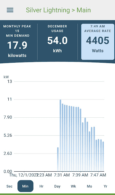

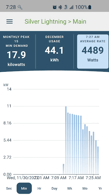

This event was timed to occur while I had the TOU set to a non-charging period, to verify the FCSP would still provide the required power to accomplish pre-conditioned cabin.
Here is the Emporia graph, by the minute this snap shot was at 7:27, peak rate was 11 kw at 7:12 then , slowed to 9, the 4.4 kw, at 7:27, it continued to maintain the temps until we walked out and unplugged the truck at 7:47 am.
Chart by the hour, showing a total of 3.42 kWh was consumed or 92 cent, much cheaper than idling a diesel for 20+ minutes!!
Thanks for the data! Curious, what do think was the temperature of ambient air/battery temp before the truck began preconditioning?
I’ve observed a similar Power draw after cold starting unconnected, and then warming my truck (a peak of ~8 kW, to ~4 kW and then holding at 1.5-2 kW) over a similar time period.
It looks to me like battery warming function/component may be pulling 1-2 kW….I really need to test this😵💫….or, just get a life!
