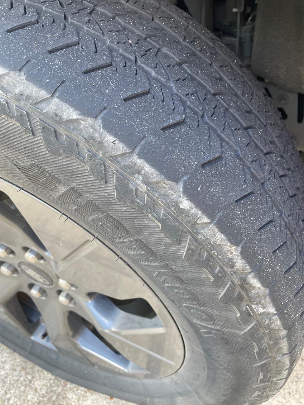

These are my stock tires at 33k. Outside edge is completely bald almost to the unsafe point, yet the middle has plenty of tread left.

My recommended is at 36 according to the door, but I am running all of them at 42-43 cold. I just took a 5000 mile road trip which finished them off completely. My dash display showed 45-46 usually because of how long I drove each day.
I think this tire just cannot handle the cornering pressure of the truck.

The inner edge is the outside edge depending on which direction you are turning.

Exact same issue with the Hankooks. 22k miles and all 4 tires have zero tread on inside and outside edges but 3/4 of the tread width with normal wear.
Dealer wants me to pay for alignment, but after reading this thread I need new tires not an alignment. Michelin Defenders seems to be the go to choice if your not going for the Toyo's which are probably over the top for my needs.

it really sounds like 36 psi is underinflated. I might try mine at 42 psi like the 116 all season tires and see how the hankook’s react. I’m leasing for 36K miles, if I have to buy a set of tires during the lease period I might as well buy a set of the Toyos now and get the use out of a better tire rather than buying them half way through.

This! Excessive wear on both inside and outside of all tires is underinflation. No alignment issue is going to cause this.
