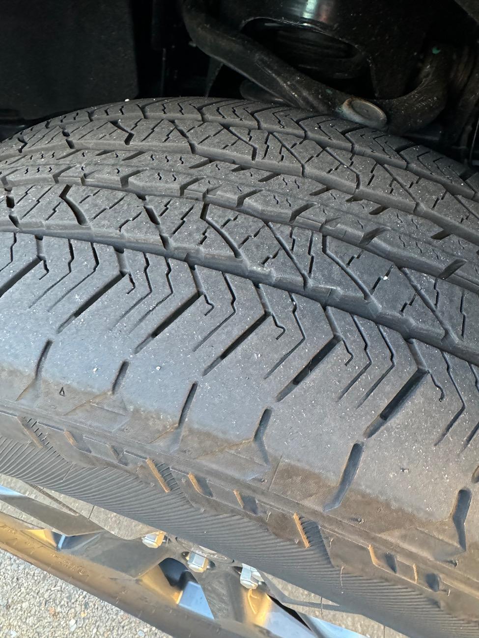

Same issue on the Hankooks. And it is not due to aggressive driving. I drive like an old man. And even if they can provide some pro-rata warranty on new tires, I really don't want these garbage tires on my truck. I'm thinking the Michelin Defender LTX MS/2, which is what my dealer is recommending. Given that there really isn't any other maintenance on these trucks, I suppose I will have to call it even...
Inflated to the recommended 36 psi, rotated (the rears are worn like this, but not as bad). About 20k miles. Truck is currently at the dealer, they are also checking the alignment to be sure. They also said that since all 4 wheels have independent suspension, the concept of rotating to the rears to "help even things out" doesn't really apply, since the rear axle is not fixed like the ICE trucks.

Just talked to my dealer service manager, who agreed the Hankooks are super soft. They are going to do an alignment, in fact he said that they now are recommending an alignment to be done every 10k miles! Crazy.
And I'm going with the Michelin Defender LTX M/S 2 tires. Not happy with this unexpected early tire replacement, hopefully I will get many more miles on these than those Hankooks...

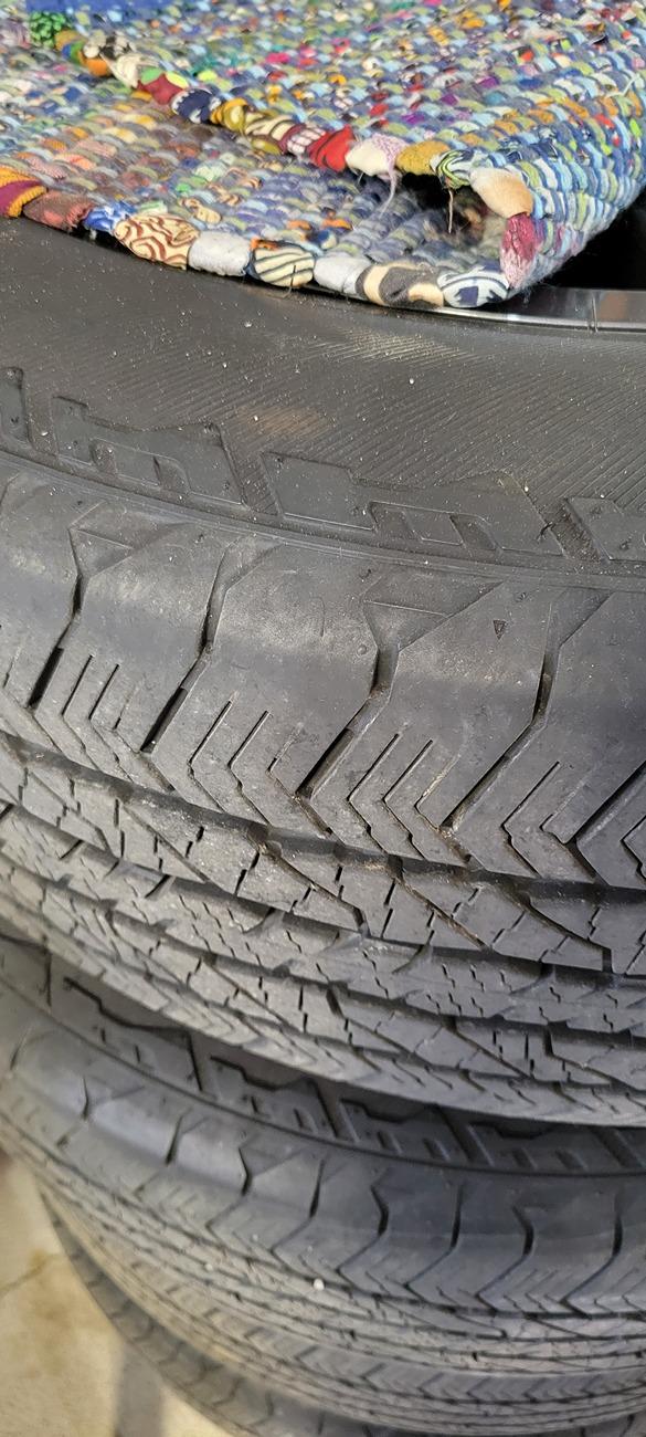

I'm backtracking on what I said here. Aggressive driving can increase tire wear and EVs are heavy which also contributes to tire wear but the edges of the Hankooks definitely wear quickly. Might be more aesthetic than anything if people are getting 40k out of them but it's happening.
Hankooks at 10k.

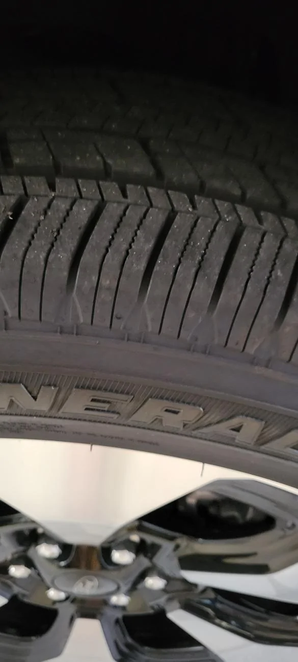

General Grabber at 10k on same truck rotated between sets regularly.
