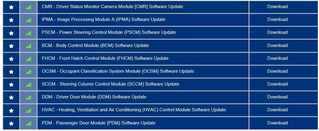

Oh, you're good. Your truck is already on the latest Sync version and 6.4.0 is the last power-up update you got. The SCCM is 6.5.0. Once you do that, it should release an IPC update which would be 6.8.0 and give you the % on the cluster if you don't already have it. The CMR is OTA 6.13.0/CMR-FX.
The powertrain updates that @mr.Magoo mentioned seem to have been pulled from FDRS so you don't have to worry about avoiding any updates. The BCM update will ask you for a password and you won't be able to do. This is due to an issue Ford needs to fix.
Bearing no issues, you have about 6-8 hours worth of updates to do. The CMR will take 45-60 minutes. The PSCM and IPMA are tied to each other and the IPMA takes 3 hours, so don't start either one unless you have time to see them through. The PSCM/IPMA updates are part of the package for Bluecruise 1.4. Because you decided to take the FDRS plunge, once you update your truck, I will tell you what you need to do to activate BC 1.4.
You can count on my support throughout the process. Message me when you're ready to start. Which power supply did you order? That piece of equipment is very important.
I just saw the BCM error in the FDRS thread, and sounds like you also mentioned it here. So for now just hold off on the BCM update? Any word on when that might be fixed?

Yea, just hold off in it. It'll come OTA eventually. No idea when they will fix it, but Ford has to know about it by now.

Will not getting this affect my ability to turn on BC 1.4 like you mentioned earlier?

No.
