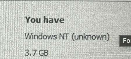

Plus now I just discovered per FDRS software my current laptop needs replaced as not meeting the software system requirements. It’s always something…Time to buy new computer too now before I can proceed….i’m computer shopping now. lol šŸ˜‚

I'm thinking you might be a bit past due for an upgrade anyway.

Yep been using MacBooks past 10 +|- years and have let all my windows machines I guess get out of date. Between iPhones and iPads just don’t use windows systems much these days. I’m shopping now for a decent Laptop with 16gb ram, decent ssd drive and touch screen or not have not decided yet.

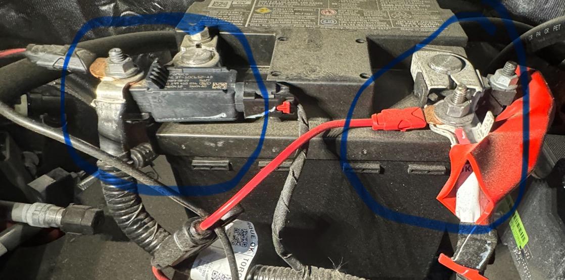

Good to know thanks. Glad you averted any tragedy. I’m ordering new laptop today before I can proceed. FDRS says only lists INTEL processor, I’m an AMD fan usually. Out of curiosity what is your laptops processor you are using..? So I might have to switch back to the INTEL camp lol.
On the power supply hookup I hook mine up like this so the bms correctly reads and monitors voltages. I may be mistaken but was told by EV tech this is the way to do it..?
Yes, that is the way to do it. I am not sure what happened with @pkirby11; he texted me last night after he was able to get it resolved on his own when his battery died while updating the IPMA. Crisis everted in his case, but he probably spend a total of 5-6 hours doing that one update.

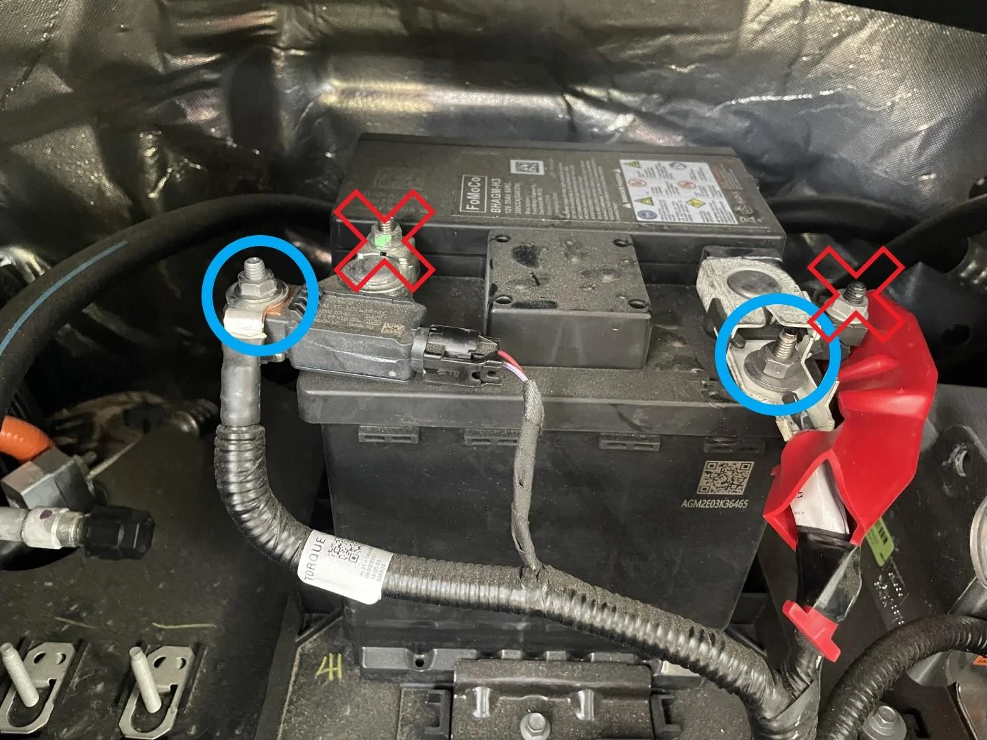

Only because you kinda circled both the negative terminal and the BMS connector, here is a pic for others showing the proper locations (use blue circles , not red X's). Looks like you have the power supply ring terminals attached correctly.
If you have 6mm nuts you can attach those on top of the existing nuts (piggyback) so you don't need to disconnect the existing nuts to attach the ring terminals.
