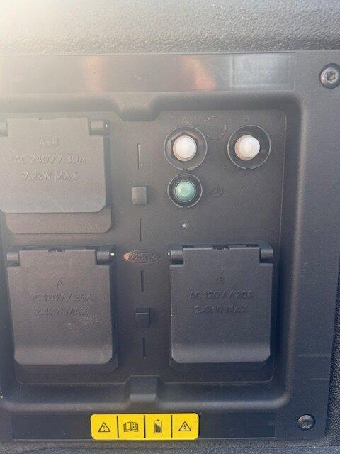

It clearly says on the cover for each outlet A and B (AC 120V/20A or 2.4KW max)

You can draw more than 20A up to 30A from each bed outlet (one on each split phase of the 240v inverter). I am not sure how Ford got approved to do this on a 20A rated outlet and it certainly begs the question of safety since you can run a single residential grade 15 amp extension cord and light up 30A of gear across it. There may be a few melted cords out there for folks not knowledgeable enough to try this.
I expect this will be fine-tuned in next year's T3 models.
