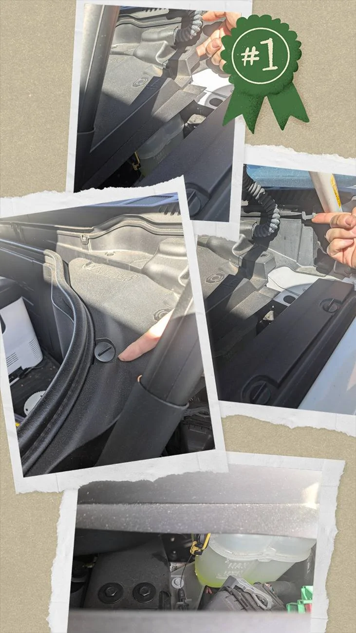

Mine blessed me with this problem this morning. Wouldn't recognize phone despite Android Auto connecting and playing music. Refused to bring up the keypad to enter a pass code. Rebooted phone and truck, no dice. Had to call my wife for a key.
What a joke @Ford Motor Company.
Villa Ford of Orange. 1FTVW1EV5NWG10205. Tony Rodriguez is my Service Advisor.
Oh, and when you contact them, the trim rattles and it's drank almost all the coolant from the last time they dropped the battery. And the clips under the frunk are missing or broken.
