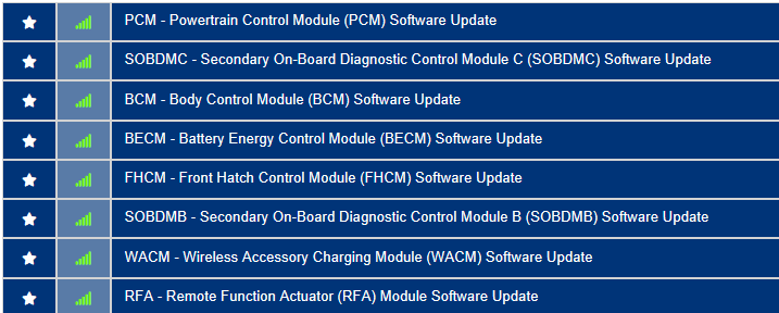

Here's the list as of now:
The BCM/FHCM pair showed up the same day (8 Oct).
I think you're waiting for that RFA update for PAAK to be enabled. At least that's what it took for it to work on mine.
@Mike G if you are in FDRS again soon would you mind pulling another list for VIN 1FTVW1EV3NWG03253. My PAAK finally rolled in yesterday and I received 3.5.5. I'm curious how many of these they might have applied or how many are still outstanding. I know I need to buy a Mongoose, but then I'm afraid I'll spend $50 every time another module update shows up.

Here's the list:
Ford F-150 Lightning Phone as a Key issue 1FTVW1EV3NWG03253-19-Nov-22
Picking the PCM will start the update of all the other updates with the exception of the WACM. They were all coordinated when I did them. The WACM is a separate stand-alone.
