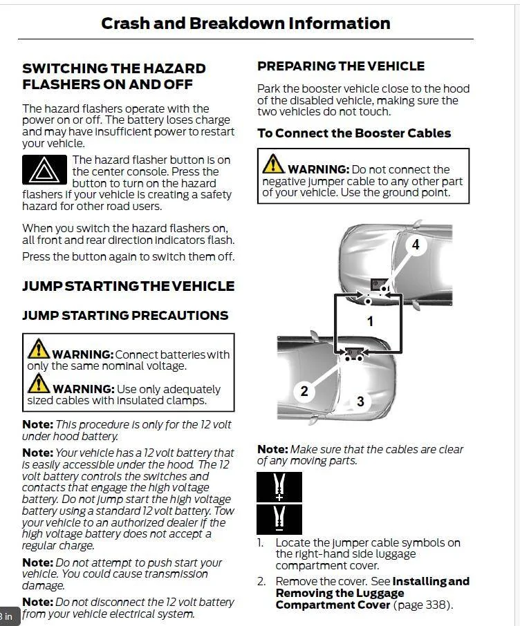

Thats what I thought and why I have NOT deleted the app or reset ny settings as of yet. Now Ford roadside is telling me they are not allowed to try a jumpstart of my battery because it’s an electric vehicle. Ugh.
Then what's the purpose of having the battery post under the passenger side panel? It's certainly not for jump starting others only, or is it?

14,164
15,272
