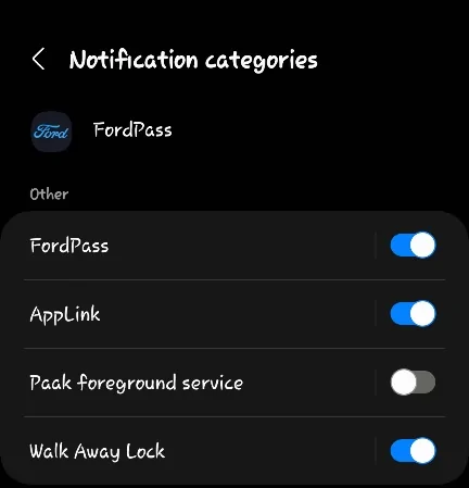

Android users, is there always a "Phone as a Key is trying to connect to your vehicle" notification in your status bar? Can I make this go away? How does it affect battery life?
3,760
6,831
I turned the notification off. It's your phone notification settings for the app. I haven't seen any abnormal effects to my battery life but it does run constantly in the background.
