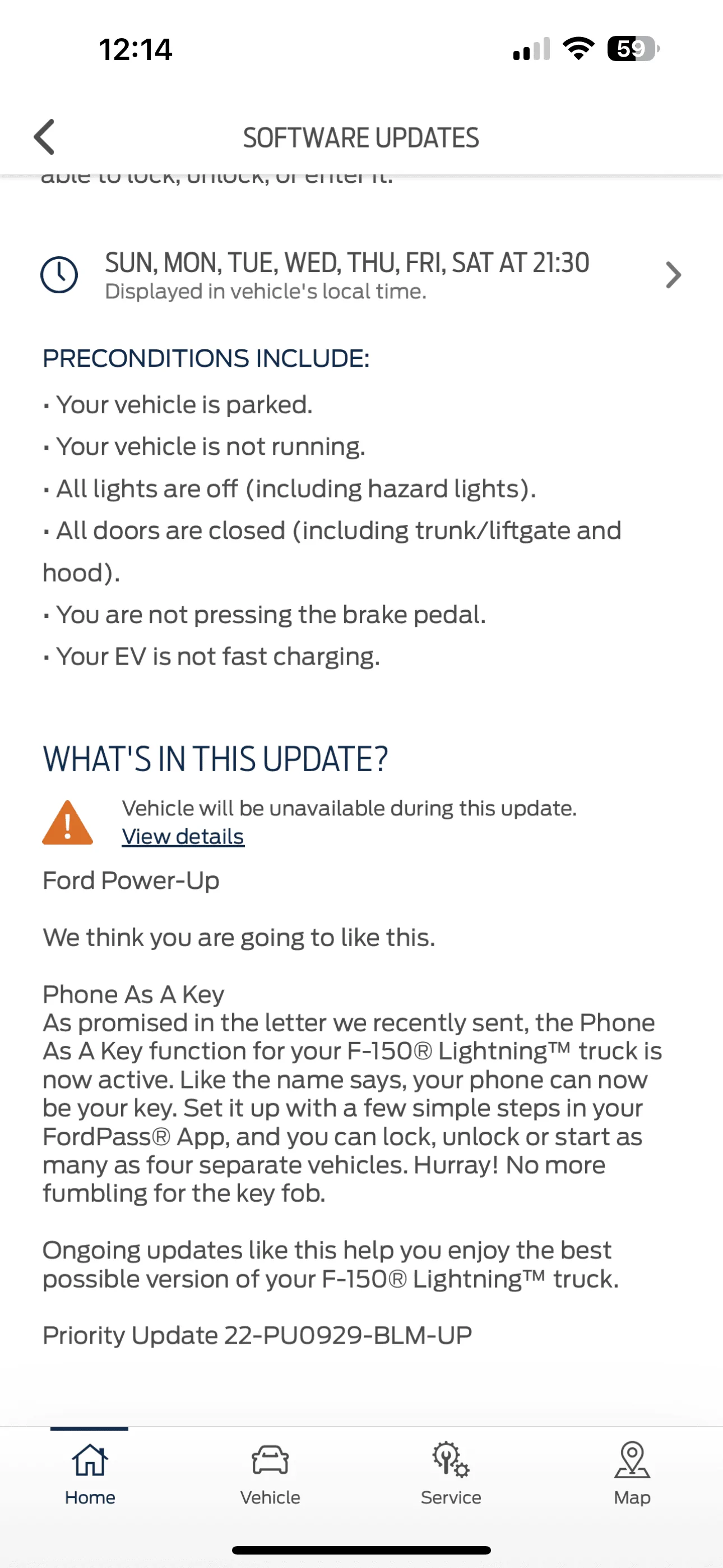

I had trouble getting PAAK to work, and I found the following Mach-E forum instructions to work great with adaptation to an iPhone. https://www.macheforum.com/site/thr...on-android-to-enable-a-backup-startcode.4544/ (Post #1).
I tried the simpler iPhone instructions offered in Post #2 of the same thread, but they didn't work for me. YMMV.
My Sync screen says I have all the latest updates. But when I tried to set up PAAK in the FordPass app, after copying the pairing code and waiting a few minutes, I'd get NO input dialog for the pairing code, and a message pairing had failed. I'd be told to reset PAAK in the vehicle, but I'd immediately get a message that the PAAK reset failed.
So, I pretty much followed all of Post #1 instructions. I have an iPhone 14 Pro Max running iOS 16.5. Deleting the FordPass app is supposed to remove all data and cache. I went into the phone Bluetooth settings and disconnected all other paired devices. I turned off CarPlay under the General settings on my iPhone. I turned off BT on my Apple Watch Ultra. Turned off low-power mode for my iPhone battery(although, in the end, PAAK works with the battery in low-power mode). Went to my Ford account and verified vehicle and VIN # were there. (I may be skipping listing a step or two listed in Post #1 in this recounting). After rebooting my iPhone, I reinstalled and signed into the FordPass app. This time, after starting the PAAK setup, after the Wait Two Minutes, the pairing dialog popup appeared. When I pasted the code in and tapped PAIR, the FordPass app went back to the COPY THIS CODE screen, and I got a message the pairing had failed when I clicked CONTINUE on the bottom of the screen. I went through the setup again. Same deal. Input the pairing code in the popup dialog but then went back to the Copy THIS CODE screen. But the 2nd time around, I just sat in the vehicle dumbfounded and then noticed on the vehicle Sync screen that the PAAK pairing had been successfully completed. So to anyone else who tries the Mach-E recipe in Post#1, I suggest just waiting the first time around after returning to the COPY THIS CODE screen, and maybe the PAAK setup will work in one try.
