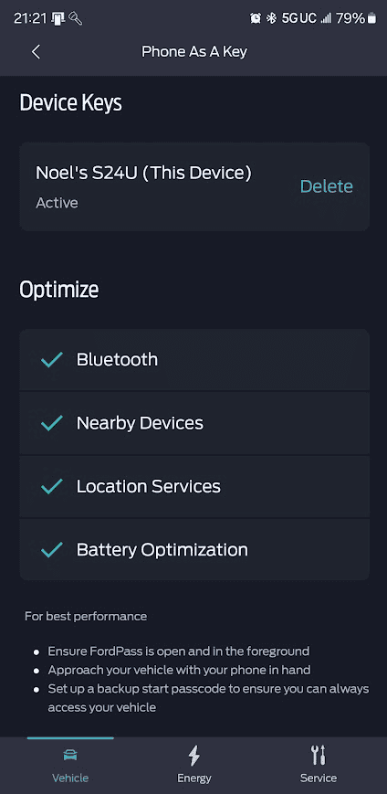

What am I missing or doing wrong here that I don‘t have this functionality?
Confirm that your install of FP has all these functions optimized for PAAK.
Ford F-150 Lightning Phone as a Key fails after FordPass update 1720315388556-mh

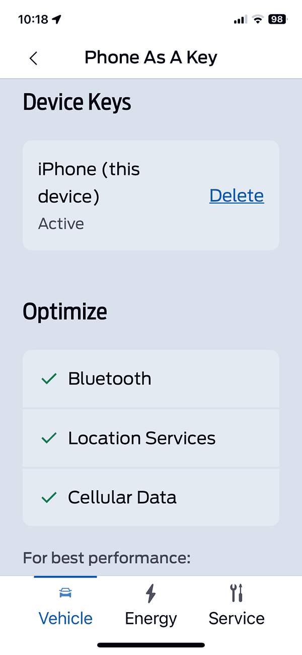

Ford F-150 Lightning Phone as a Key fails after FordPass update 1720315388556-mh-
I don’t have Nearby Devices or Battery Optimization options, but the other ones are selected:
Ford F-150 Lightning Phone as a Key fails after FordPass update IMG_2342
