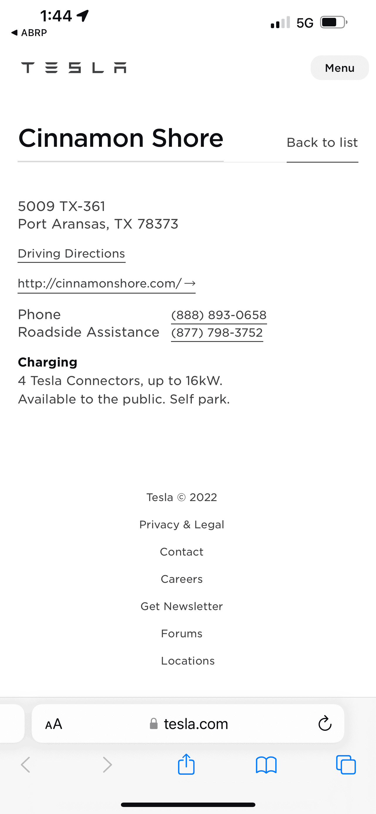

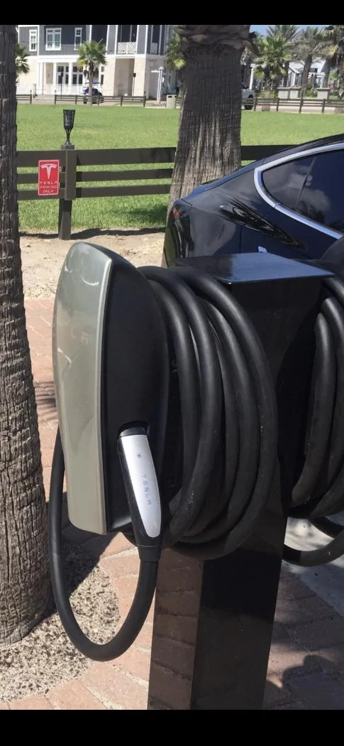

When you reference HPWC, does it mean I
need to fret over public Tesla destination chargers?
Asking in part because next Friday I’m considering taking the F150L on a 4hr family trip through a near absolute charging desert (Austin, TX, to Port Aransas), with destination charging being the key to returning home. That destination has several Tesla-only chargers.
According to the Tesla website info on those destination chargers:

Meanwhile ChargePoint has some (potentially dated?) photos of the chargers
Ford F-150 Lightning Please Help New Owner - Charging Questions 978827B0-D61C-49F1-9B73-EFFD66AE7B8A
I like he great to avoid fires, and also to make it back home
