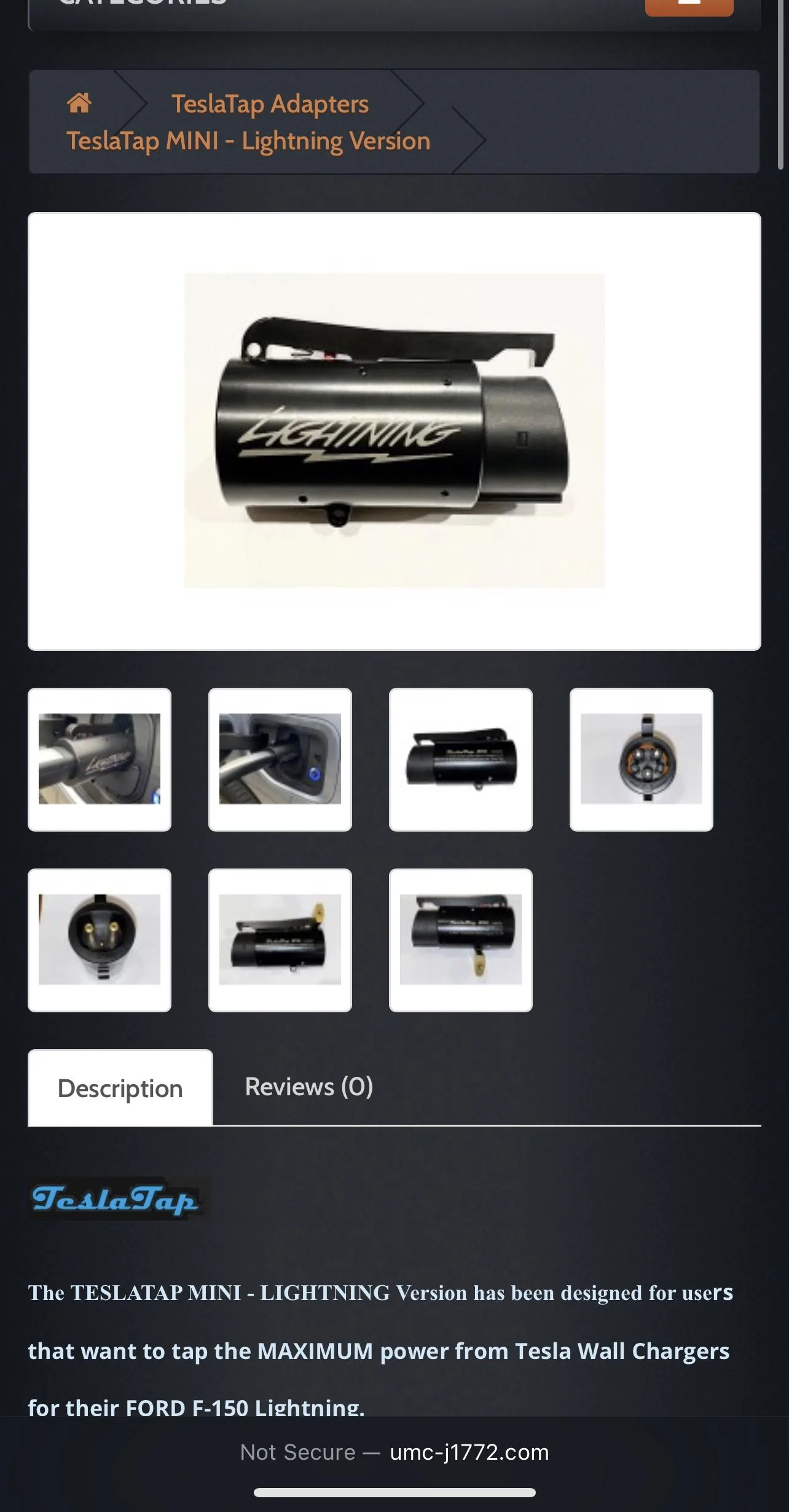

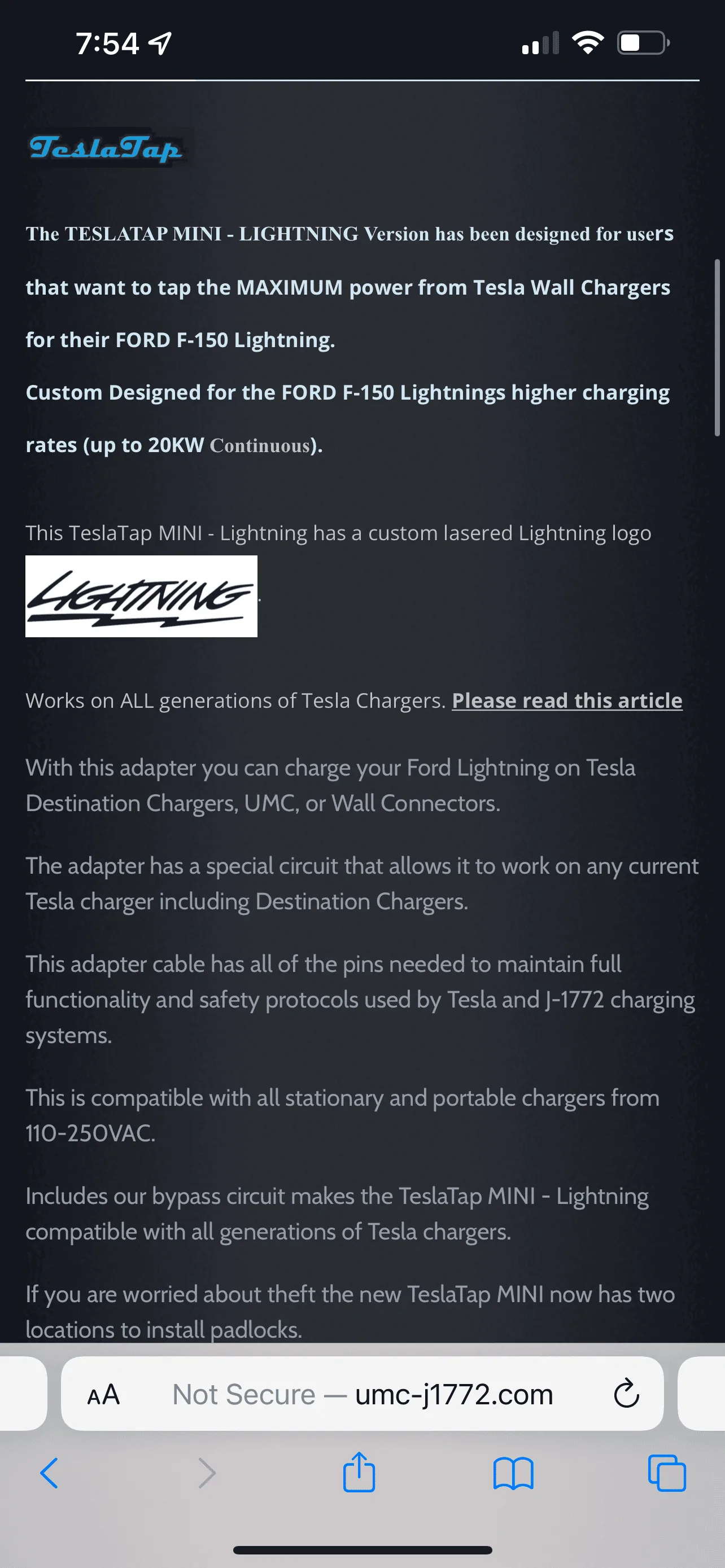

thank you - btw, have you seen this yet?
Bought one ~3 weeks ago when the company was giving forum members a discount….it’s in my Charging Kit…have yet to use it……
damn, here I am bringing up old stuff AND missing out on discounts
