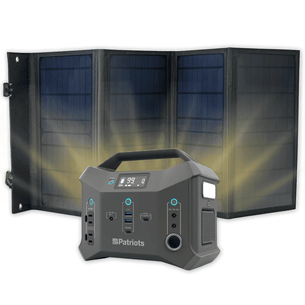

rather than investing in a 'gas' fueled generator, which requires not only the additional fuel tanks you would have to bring, but is also noisy, of course... and, has to be 'cranked'... with it's OWN battery to start it, unless you have a 'pull rope' type...
now, maybe a better and more 'up to date' technology is simply ANOTHER battery - the 'generator battery' that you see all over the place now, whether from 'Patriot' brands, or 'Echoflow' Delta, etc., and some of these with integrated or add-on SOLAR, as well.
NO NOISE. PURE SINE WAVE OUTPUT. NO FUEL. EASY. .... just in case.
Ford F-150 Lightning Portable Gas Generator to Charge the Lightning? 1714821039087-zh

That thing probably can hold 1 or 2 miles worth of power
