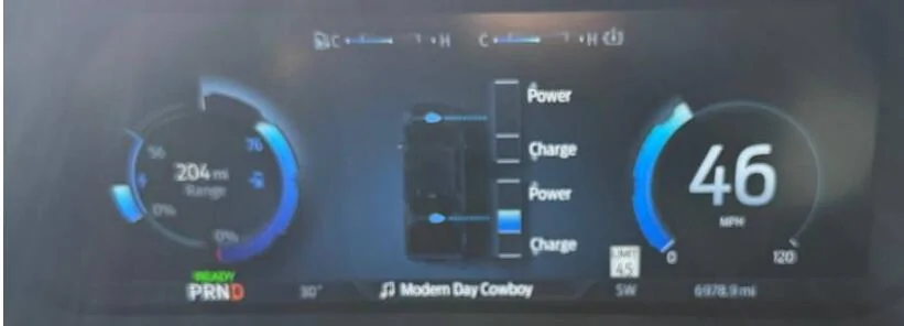

Had this happen when going to lunch today. Made 1 stop on the way back and when I restarted the truck it was 100% then dropped back to 56%
Makes sense that this would happen today when I’m heading out to go camping Saturday.
This exact thing happened to me today. I shut it down for about two minutes, restarted, and it seems fine.
sorry for the lousy pic. I was driving.
