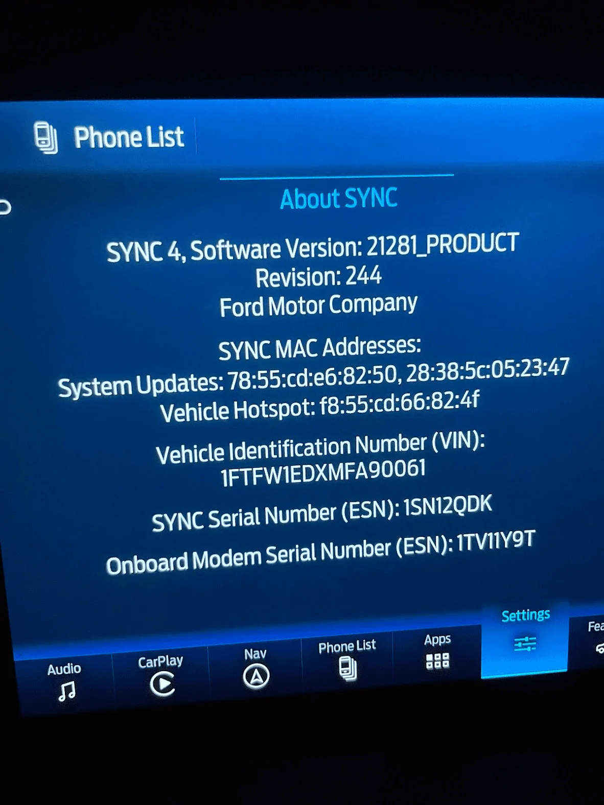

Well, like many here I got my new APIM installed and received a few updates including 2.1.
  1. Now my phone pairing disappears each time I turn off the truck, so I have to repair each time I start the truck.
  2. FordPass does not keep authorization after ignition is turned off and on.
  3. Music album image doesn’t display for Bluetooth source.
  4. Approach detection is sporadic.
Ford F-150 Lightning Power-Up 2.3.0 OTA rolling out Sync Version
Snakebitten
Jun 19, 2021
1,521
923
Coastal Texas
2021 F150 Powerboost Platinum
Hmmmmm
I was at that build and revision and did not experience those symptoms. I wonder if there are other modules that need to be "match up" to get everything to work?
I ask because when I update my APIM I am required to update my TCU as well.

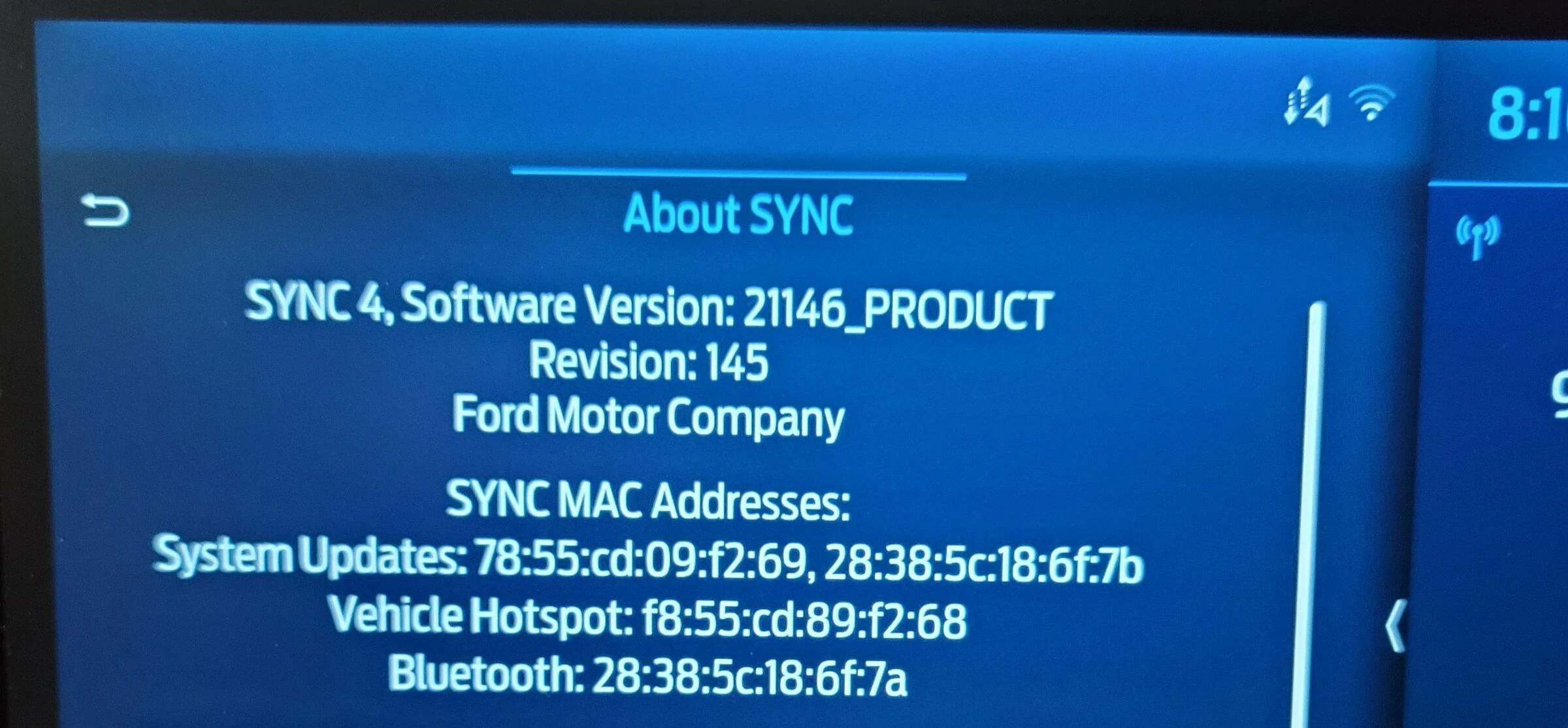

I don't use the speed sign recognition, but I do want my XM to work properly again, so that's a good tradeoff for me. I'm sure everyone will be different. Guess it's too much to ask that we fix one thing without breaking another.
Yep.... Too much to ask. Got 2.3.0 yesterday. Finally. Not to burst the euphoric bubble here.. but XM (technically the radio presets) still broken... Mine started failing in December... something as simple as the right thumb on the steering wheel buttoning up/down thru the presets still has failures. Sigh.
Edit. Rut Rho. Sync is still downlevel at REV 145. Yet Power-Up is 2.3.0. Tried booting a couple of times. Maybe 2.3.0 did fix XM... I can't tell from my truck....

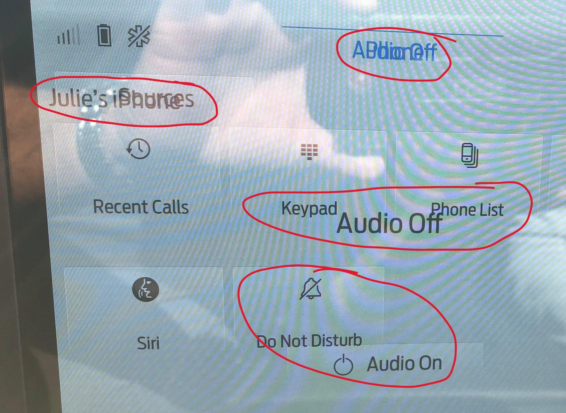

Well I appear to have gotten an update and my issues have increased..... (sigh......)
If it was an APIM update you might need to cycle the truck a couple of times. (shut down and open the driver's door)
If that doesn't kick it clean, soft boot the APIM? (hold the radio off button and seek-forward button simultaneously until the screen goes dark)
HDT05
Mar 18, 2021
86
2021 F150 Lariat FX4 5.0
We tried cycling the truck and no joy.... (it's always when you're on a long trip with no nav all of a sudden) so did a boot... that allowed us to finally delete my wife's phone connection to the system and mine to work.

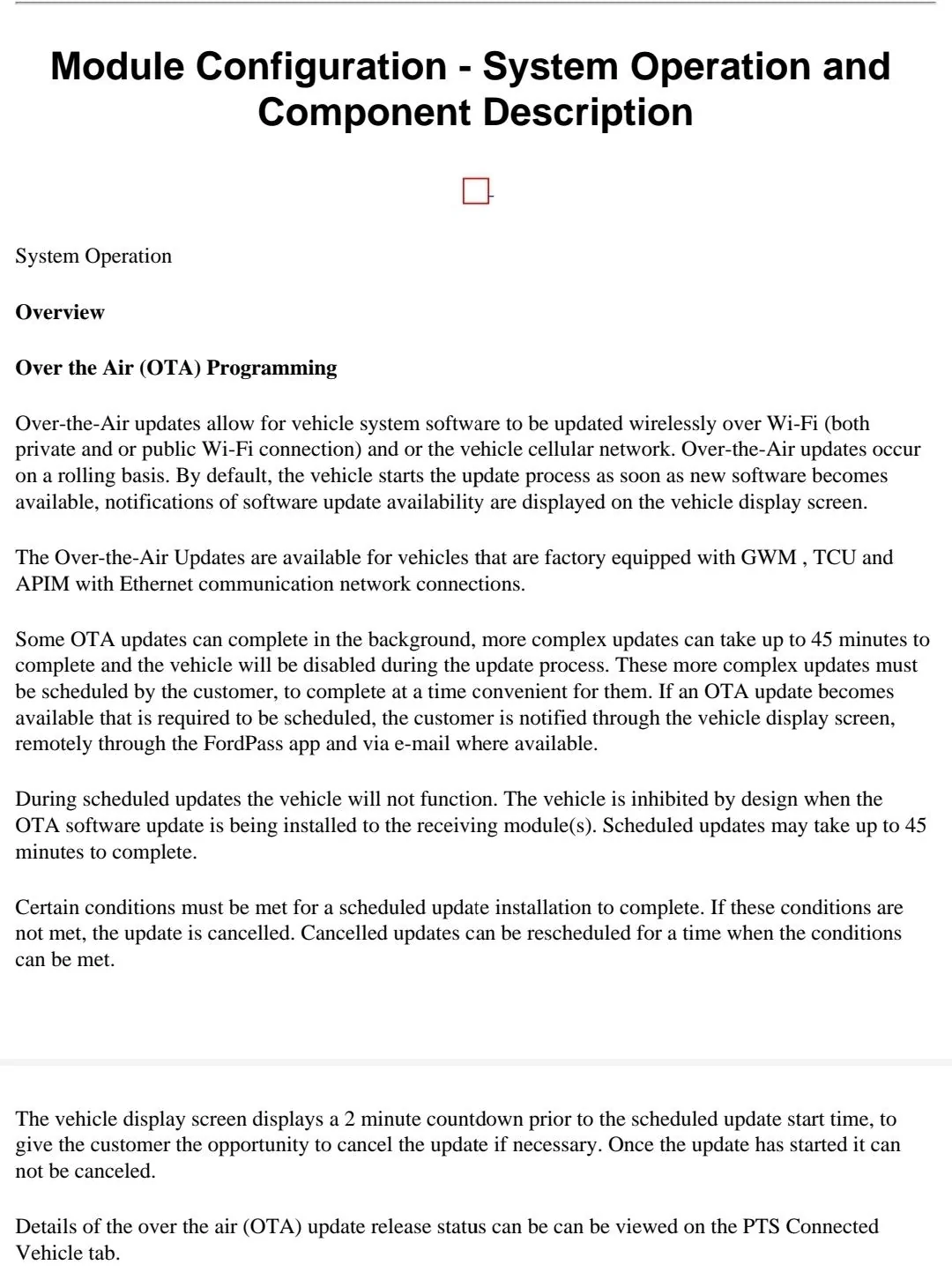

I wonder if this might explain why those that reported that they set a "schedule" for OTA suddenly succeeded at getting the APIM update, while others that did not set up a schedule haven't? If I am reading this correctly, some updates, those that would require the truck NOT to be driven while being updated, are possibly ONLY delivered if "scheduled"?
