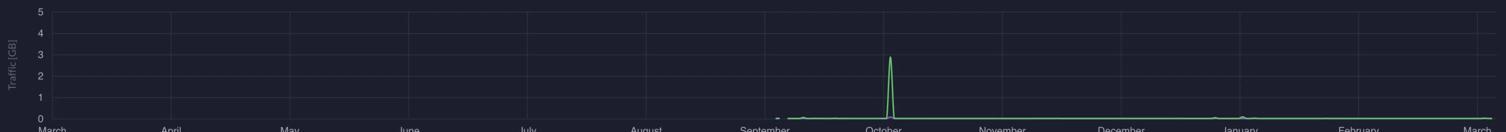

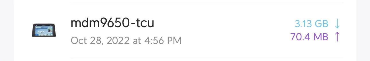

Perhaps the updates are small for a reason, and require multiple downloads vs a single download. Reminds me of torrents, and how it downloads chunks at a time. It could also just download the package that it needs vs the full package that you would get with FRDS. It could even be some type of hybrid system too, and depending your connection speed it will figure out what is faster and use that. I have a 6G up/down symmetrical internet with 4 APs covering my whole house, but my phone signal is usually pretty poor.
Regardless, I did receive a very large update in October, which was over 3G in size:
Ford F-150 Lightning Power-Up 4.2.1 - Precondition Alert failed updates IMG_2290
Also, I didn't start doing much data/logging retention before. This is the full graph showing downloads starting on 10/1/2022. As you can see, there are very minor spikes along with the way, but nothing like the 3G download in October. I picked up the truck in July 2022, and went on vacation shortly after.
Ford F-150 Lightning Power-Up 4.2.1 - Precondition Alert failed updates Screen Shot 2023-03-29 at 9.57.54 AM
