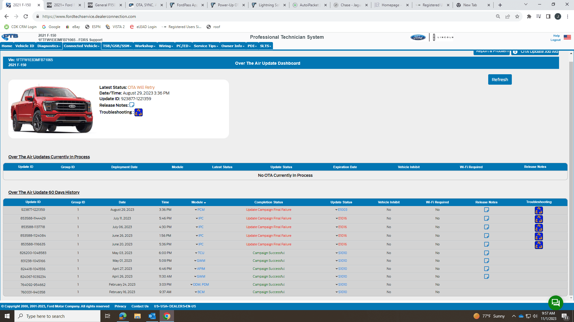

@Minh This is accurate. My truck is incapable of having the IPC updated the traditional way and any IPC updates for me must be CAN'd in the long way. However, that may not be the case for you. If your IPC fails to update with the OTA process, then chances are, it will fail to update via the USB process, as well. Screenshot of my OTA dashboard is below for reference.
Ford F-150 Lightning Power-Up OTA 6.3.0 - Screens, Profiles, Charge Stats 1698847131845
You can ask the dealer to update it for you, but I would not have high expectations that they actually do it. I have seen many cases where a dealer will try to update the IPC. When FDRS says is has to be CAN'd in and it will take 5 hours and asks the tech if he/she wants to continue, they click "no" and don't do it. I can't say that I blame them.

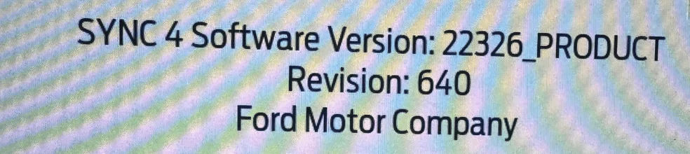

My truck is still on 640. It sat for months because of the light bar recall. There's nothing that can be done? I've tried everything
As far as triggering OTA's go, there is nothing you can do. All those youtube video tips to trigger updates are placebos.
Seems that way. I’m trying to be patient but I like updates!
