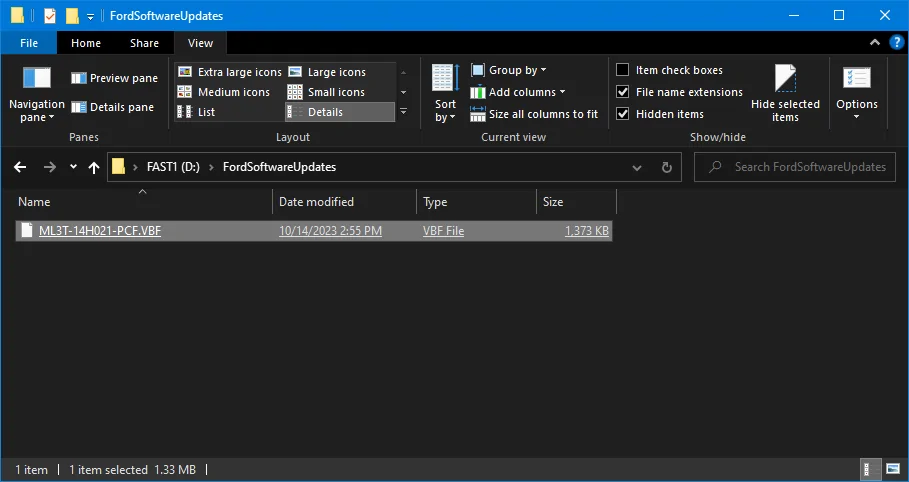

For the Lightnings...OTA 6.2 was 1.33mb. If you blinked you could have missed it.

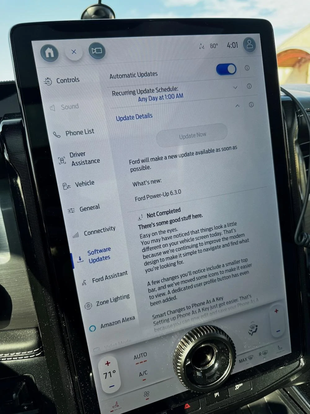

Mine has been showing "Not Completed" for the past two days. How do I get it to proceed? The button is grayed out and I've tried the usual dance of opening/closing doors, resetting the update schedule, turning off lights, opening/closing sunroof, turning on wipers full blast, opening/closing the charge port, driving in circles...still shows the same thing?
I usually do updates with FDRS so my experience with OTA updates are limited but I'll be ecstatic if they start coming through OTA on time now!
Mine as well...but since I did the update with a USB drive it doesn't really matter. Just waiting for that TCU update now.

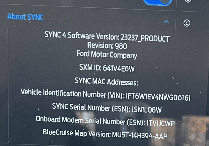

The dealership did not update any software in your truck before handing you the keys unless there was a "stop-sell" or other requirement to do so. Trucks and cars are sold to customers everyday with available updates pending.
The "Apple Maps enhancement" you refer to was a component of the OTA 6.3 APIM (Sync) update which would have resulted in your Sync version updating to Sync 980, like this:
