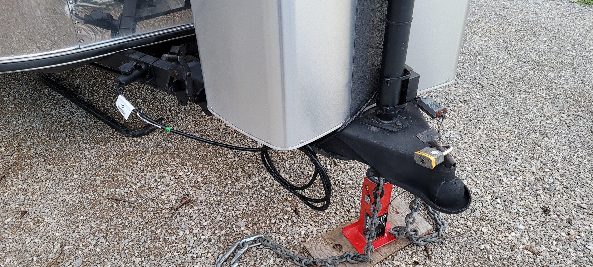

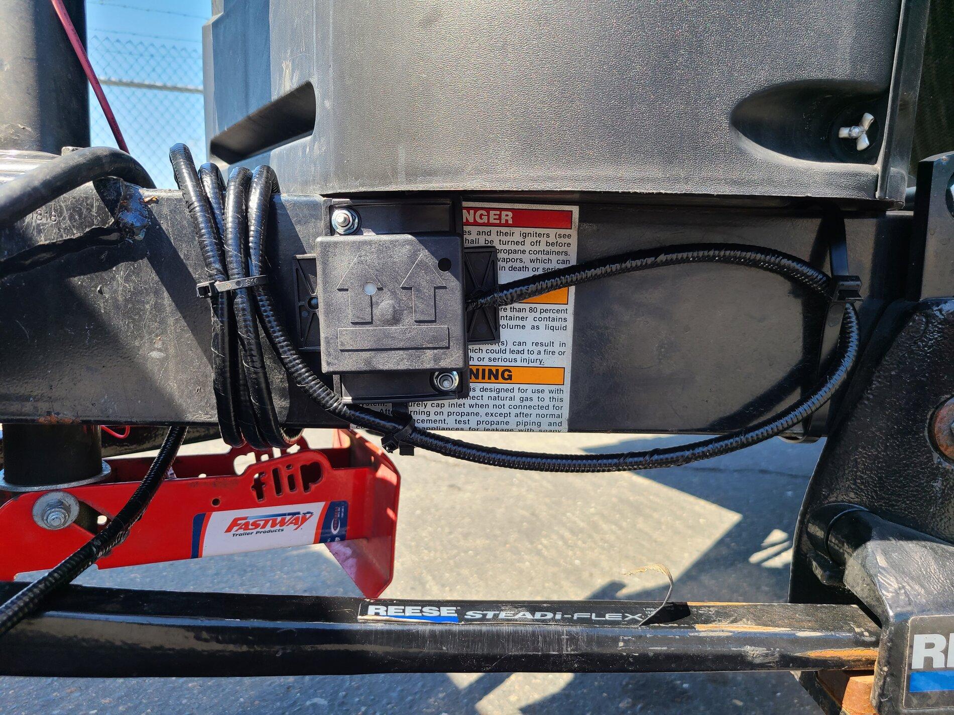

I really really hated to have to install this, was hoping the sticker software update would come but I bit the bullet and just installed the damn thing.
I tried to hide it under the propane tank housing but I couldn't zip tie there. So I put it forward a bit (so much for the warning label!) to the front of the propane tank to make it easier to unplug the cable if ever needed. The orientation forces the initial cable to go backward, so I made a gentle 180 for strain relief using another tie. Then cinched the excess length together around the tongue frame. UGLY!
As far as setup in the truck computer? Was SUPER simple compared to the sticker. I only had to drive straight, then make one left turn 90 degrees and it was DONE. I did a practice backup once into a spot and everything worked great.

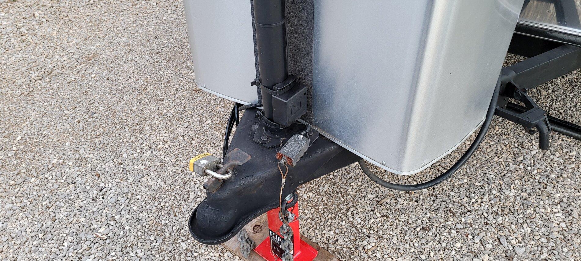

Here is my setup securing the back up sensor. I zip tie it on the pole jack. I don't really want to use the double side tape method as my camper A frame is not wide enough for the sensor. The sensor still work mounting this way and the backup assist is awesome ?.
