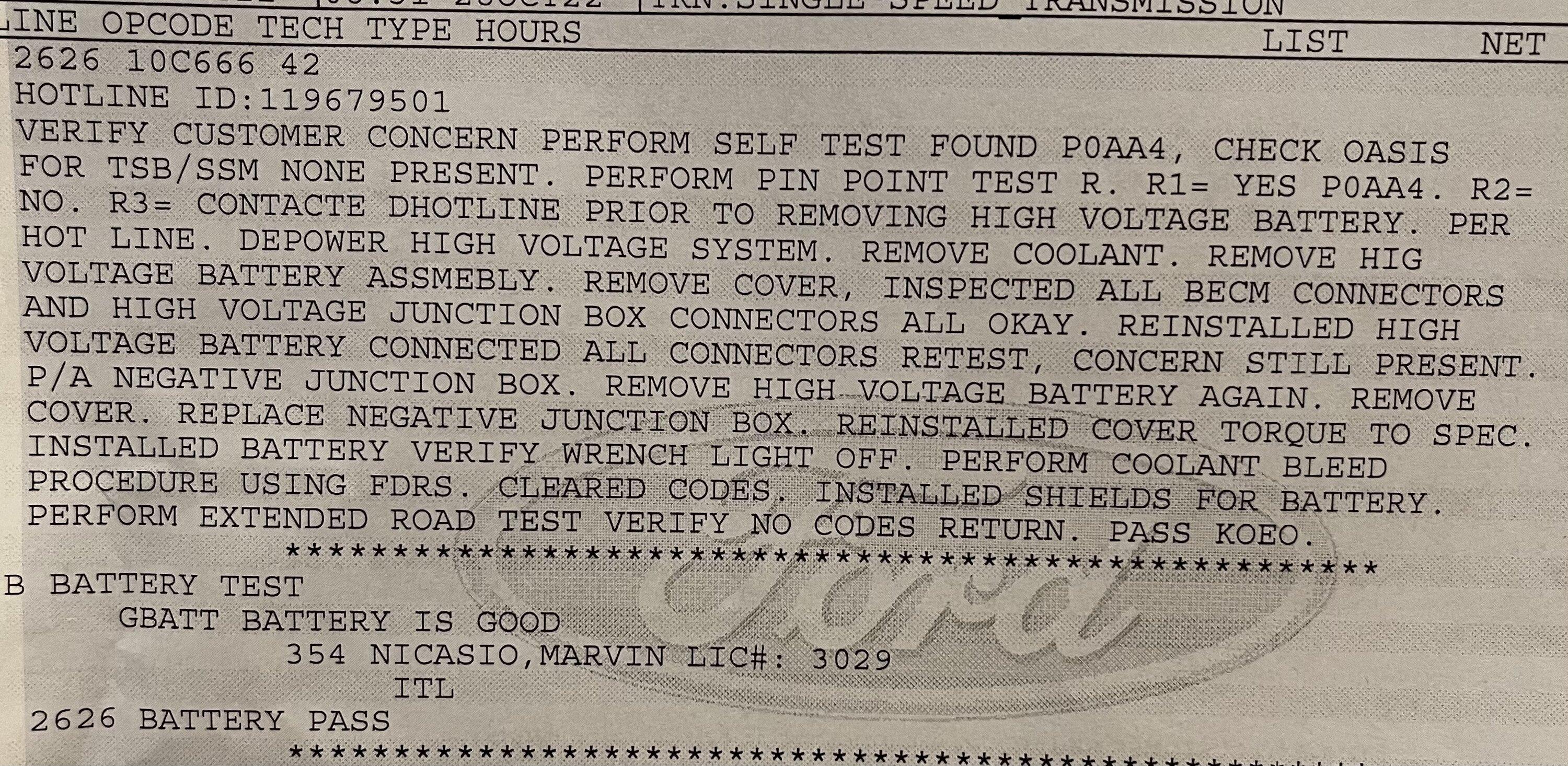

Got my truck back today. Seems like extensive work has to be done to get to these junction boxes. I assume the module as a whole has to be replaced, hope @Ford Motor Company can get some useful failure analysis from the defective junction box because nothing was found to say what caused the fault. Worries me that it could happen again if the module itself is not the root cause.
So far truck feels like new driving and the first DC fast charge was successful peaking at 140kw.

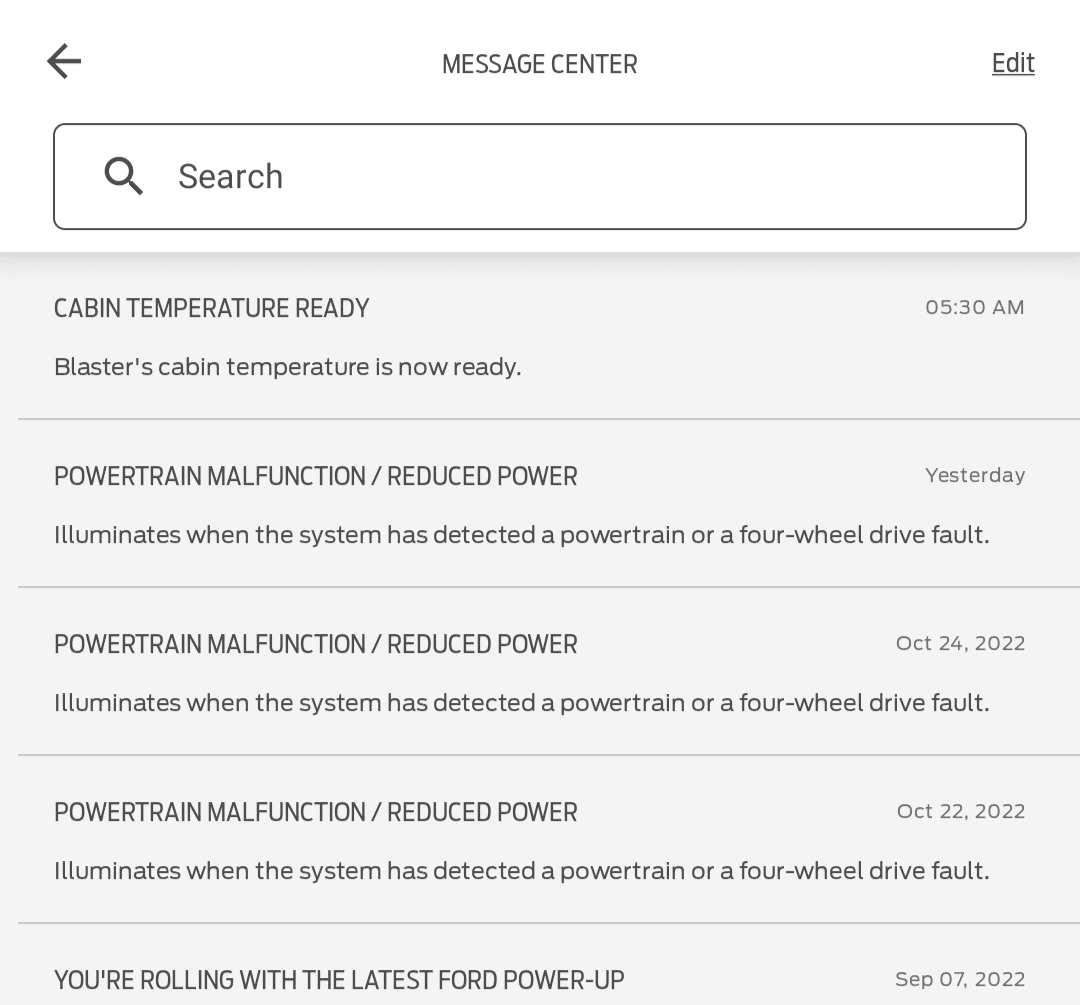

I've had 3 of the same error messages sporadically in the last week, local dealer is backed up with winter tire installations...which is a joke to think this shouldn't take priority, they are trying to squeeze me in next week. I'm contacting another dealer to see what they can do in the meantime.
Sounds a lot like the HVBJB like the MME with AWD & GT/GTPE is experiencing.
Hopefully Ford learned not to brick and strand the customer when the contactor gets stuck like the early MME had before an OTA update.

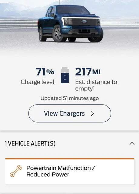

Well here we go again?? I received my MME last week after the HVBJB replacement and today just received this for the truck. Hopefully I can make it to dealer if not get it towed there and have it inspected. I will follow up soon.
#1 I have to get this towed because it will not go faster than 15 mph
Ask for the DTC code, as I said before mine didn’t impact my performance at all but did give me the same alert.
