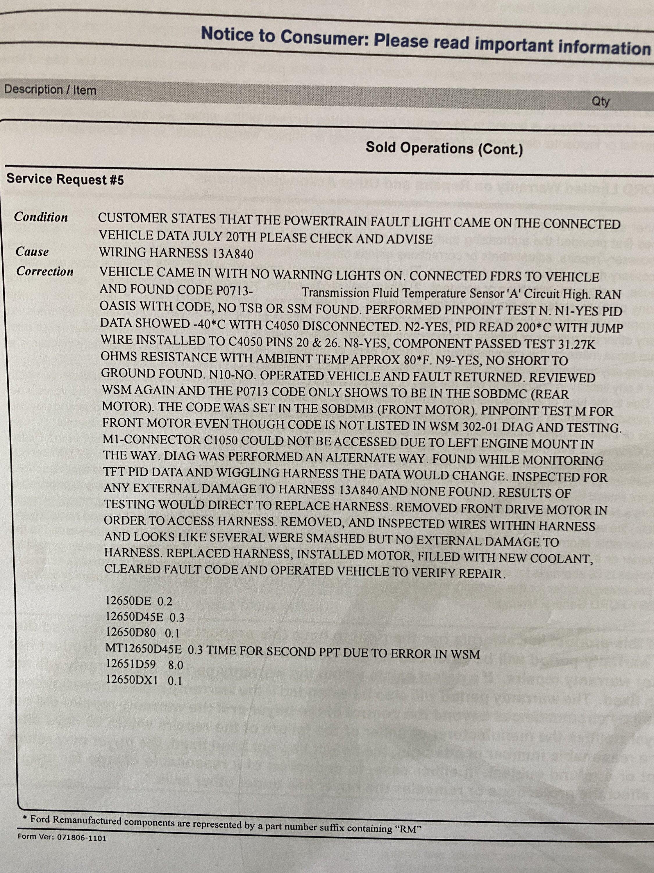

I can offer a mid-issue update:
  • Local dealer, Mossy Ford, San Diego has EV Techs and they surprisingly had an open appt. available the next day to look at the truck.
  • I started the truck the next day and the error code/light had cleared. Drove normally 6 miles to the dealership.
  • Dropped the truck off and they gave me a new Mustang MachE GT version as a loaner. Nice! (Prefer my F150 though for sure). They told me to give them a week. They said FMC would be paying for the loaner.....
  • FMC took my info from the DM here immediately and next day I got a call from them. Then next day I got a call & an email from my BEV Team contact, he is ready to offer support if needed. It's nice to have them connect even if they haven't done anything just yet.
  • I spoke with service today. Their message: "He has moved onto the steps where he is deciding either an external harness is going to be replaced or that the motor will be dropped and an internal harness will be replaced. I should have those answers later today."
Final Report:
  • Truck was ready 8/9 after they diagnosed and replaced a smashed wiring harness under the front motor.....I have a couple hundred miles on it since picking it up and all seems to be good. Will keep you updated.
  • I'm super happy with the service & communication from Mossy Ford Service and the Ford BEV Team.
Including the service write up for those interested.
Ford F-150 Lightning Powertrain Malfunction / Reduced Power IMG_9355
