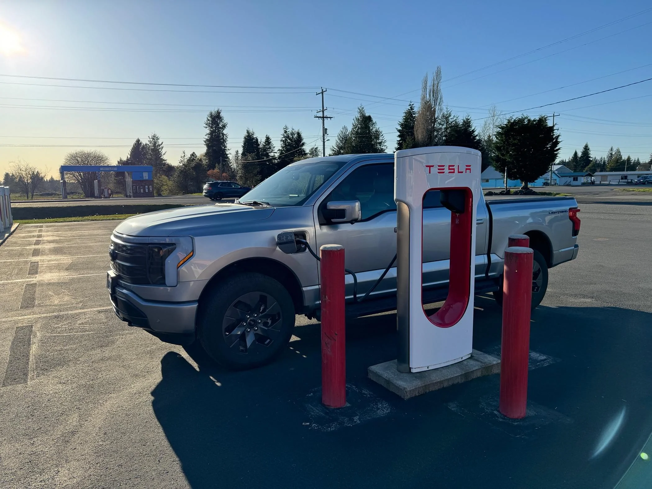

I think I was wrong about preconditioning.
I left on another trip this morning, this time pulling my camper to Las Vegas. The battery has been warm since my first charge this afternoon, and I had to slow down in the face of a 30 MPH headwind to stretch to the Sioux City Supercharger.
On a whim, I flipped to the factory nav when I was about five miles out and navigated to the Sioux City EA station. The A/C was manually switched off, but my compressor started spinning up and I noticed the battery inlet temperature dropping below ambient. I shut the climate off and the compressor was still going, and it stayed that way until I pulled up to the Supercharger a few minutes later.
My battery was a toasty 98º F when it activated and cooled to 94º by the time I got there, and I didn’t notice any throttling. I didn’t see this before when my battery was 95º down in Texas, so maybe it has to be somewhere above that to trigger active cooling? I’ll experiment with this more tomorrow and grab some screenshots.

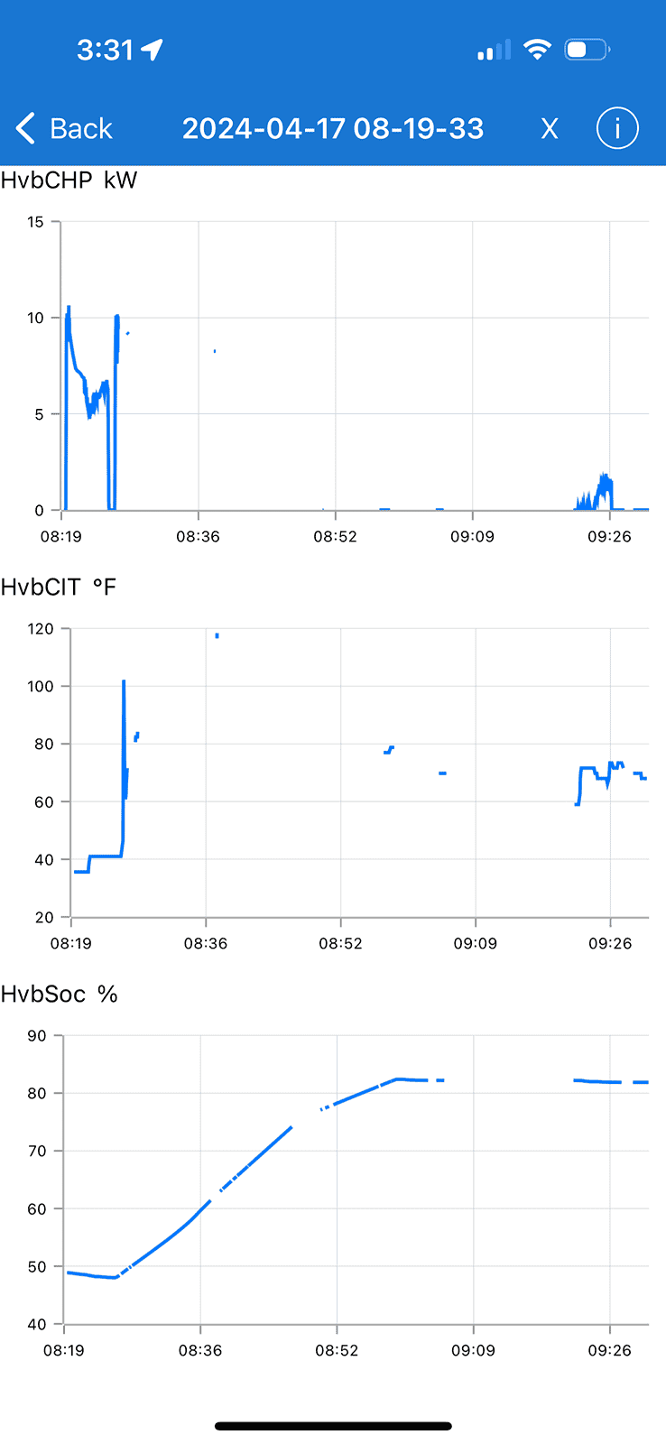

That’s true for cold weather, but not when it gets warm out. I’m coming back on a cross-country trip with my small camper, and I’ve seen lots of thermal throttling down to 100-110 kW when I roll into the chargers with my battery at 95° F.
The truck won’t trigger active cooling unless Its above 93° or it’s plugged in and charging.
