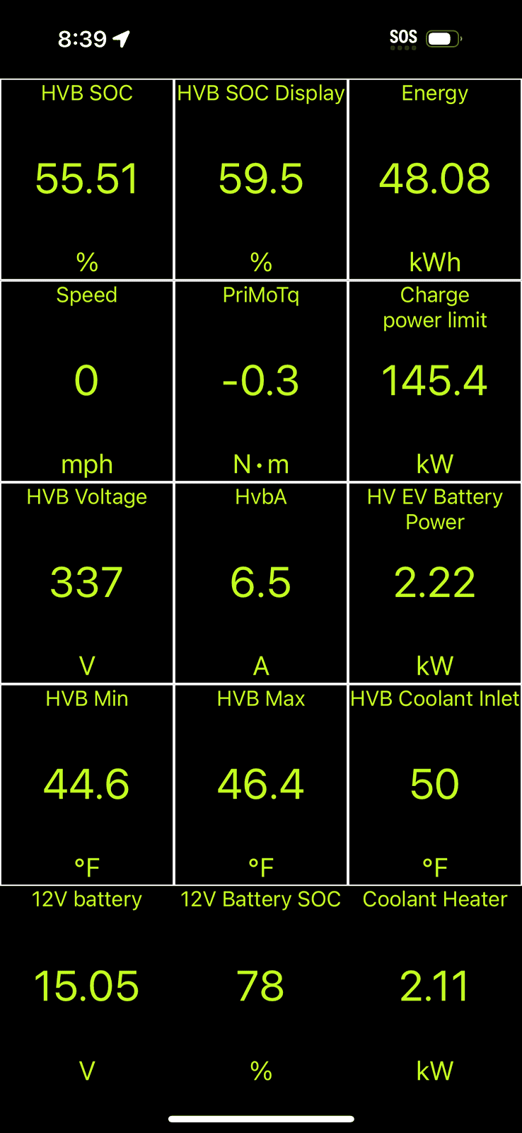

Well of course I didn't save the screen for the coldest test that I did on my most recent trip but here it is on a chilly morning before plugging in with a Tesla magic dock station selected as the destination. With climate control off I could see the coolant heater was taking 2kW. I have seen it take 7kW. Now is it doing it for pre-conditioning or something else I'm not sure.
Unfortunately I did not happen to take a screen shot for exactly the case that we want which is before plugging in, but I did look a couple of times and it seemed to me like it was on based on the numbers that I was looking at.
It was a very short drive to the magic dock so it did not have time to warm up much. I'm also pretty sure that when I didn't put it in as a destination I did not get pre-heating, and it took between five and ten minutes to get up to "full" charging speed.
You cannot precondition to a Tesla charger at this point.

This was a Tesla magic dock in Forks, WA which is shown as CCS and appears in the list of nearby chargers (which is pretty small in Forks.)

Still can't condition to it to my understanding.

You're the only one that believes this. When you made this point previously, others pointed out that they believed you to be wrong. Someone asked for proof, and I posted something Ford had put out ABOUT THE LIGHTNING:
https://www.f150lightningforum.com/forum/threads/a2z-tesla-and-charge-fault.18671/post-383938
He’s not the only one. I’ve tried in January and April and never noticed any kind of change. Zero action from the compressor or coolant heater as I approached numerous chargers, and the battery inlet temp did nothing.
I can’t say if my truck was capable of preconditioning before January, but it certainly can’t now. Nothing is mentioned in the owner’s manual or any official documentation, so I think preconditioning is a myth.
You may disagree, but @mparz00 isn’t the only one to think this. I hope Ford proves me wrong with a software update.
