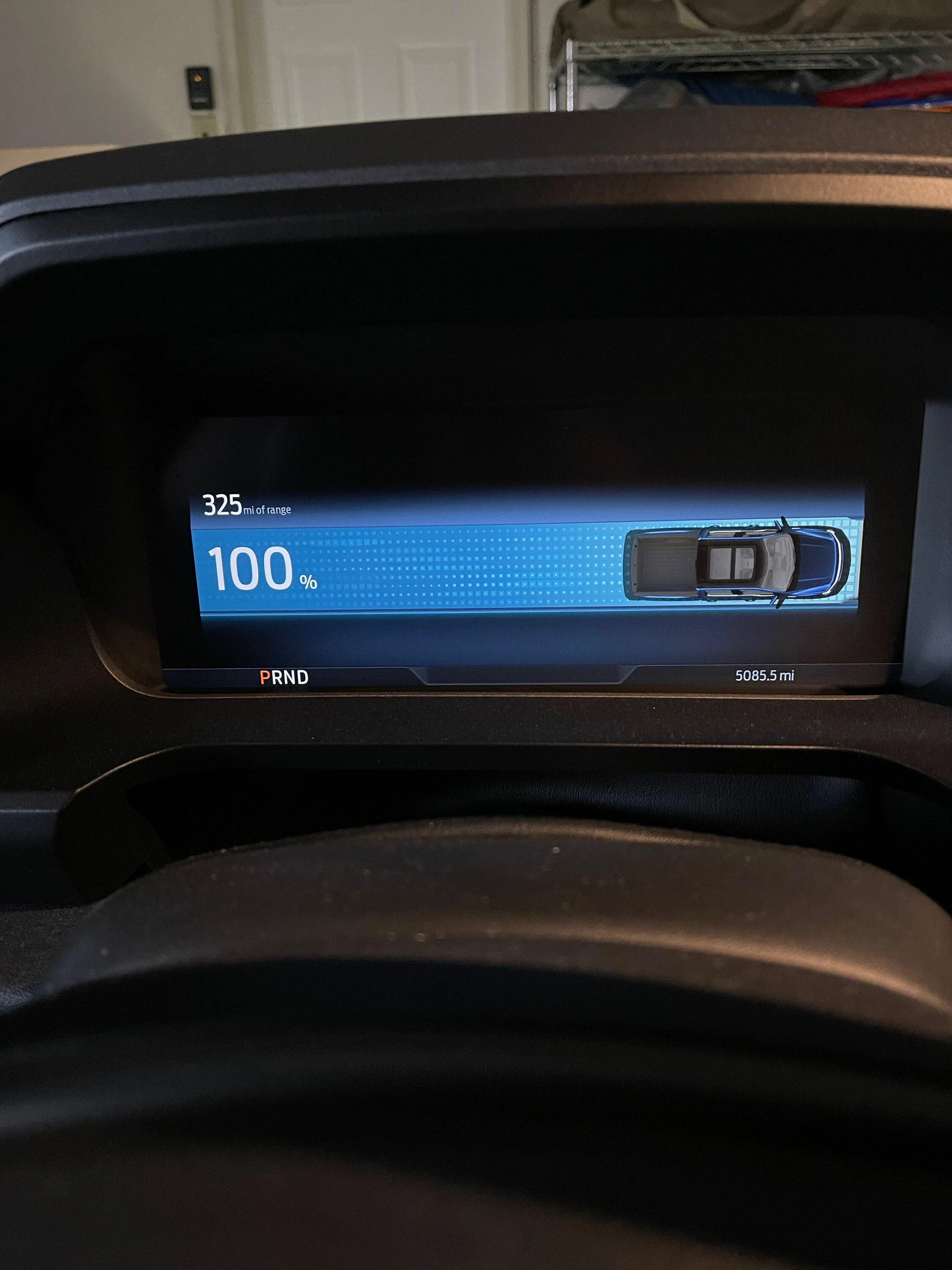

I got this update along with the 4.1.1 update a few days ago. I also have a SR XLT so that seems to fit the pattern on who is getting updates when.
This new update is very annoying. Every time I charge it, the Lightning is giving an unrealistic DTE calculation based on ideal driving conditions.
The previous DTE calculator was much more accurate. @Ford Motor Company please bring back the previous DTE calculator. My truck shouldnā€™t assume that itā€™s going to magically be 80 degrees and that Iā€™m going to putter around town after every time I charge it.

I agree with the optimistic range. It's 15Āŗ and the GOM is estimating 280 miles with a 90% charge. Before the update the estimate was more like 210 miles. Much more realistic range from my experience in the cold weather. I would also like the previous estimates back.
The worst part is that the DTE doesn't seem to be re-learning or adjusting to driving habits, history, trip planning, etc. Just always wants to show me 320 miles at 100%.
Now, when I use the built in Nav trip planner, I have to pre-plan (or re-plan) for a closer charge stop because the optimistic DTE fools itself that it can make it to the next station at 10% SOC. Spoiler alert: it can't. I also charge about 10% more at my "last" stop so I can actually make it home.
This is silly. Is the crowd that screamed "where did my miles go???" actually satisfied with this solution??

I think most here totally agree. It's ridiculous how it went from being very accurate to needing to have a third-party app to plan a trip.

I wish that I hadnā€™t gotten the update. I want to go back. I like the GOM estimates much better in the old version.
Ford F-150 Lightning Priority Update: 22-PU-1009-MIL-DTE Calculation IMG_0868
