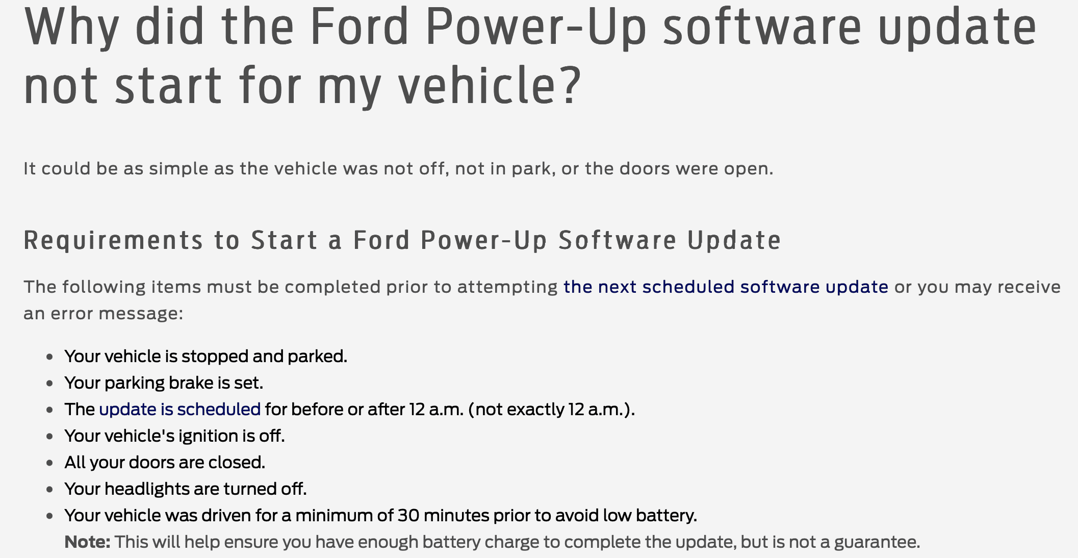

I followed the link from the FordPass App that tells you more about Power-Up installs, and noticed a few interesting things.
Ford F-150 Lightning Priority Update: 22-PU-1009-MIL-DTE Calculation 1677325743662
Based on that, I'm sure all of us me most of that list... we're parked, "ignition" is off, etc.
However, there are a couple of things I don't think I've tried together.
1. Setting the parking brake. Perhaps they want to be sure that with the computer off, it won't roll away?
2. Your headlights are turned off. Mine are set to Auto. Maybe it needs to implicitly be in the off position?
3. Your vehicle was driven for a minimum of 30 minutes prior to avoid low battery (presumably the 12v). I generally drive at least that each day, but perhaps the LAST trip before parking needs to be that long?
Then, apparently ignoring what they just said about must be before 12 a.m. (not exactly 12 a.m.), they have this screenshot completely ignoring the not exactly 12 am rule:
Ford F-150 Lightning Priority Update: 22-PU-1009-MIL-DTE Calculation 1677325817603-
One would ~think~ they would program an exception rule to prevent us from setting a midnight starting time, logic would be"
12:01 am or later
but
No sooner than xx minutes (projected install time plus 10 minutes for sanity sake) subtracted from midnight, this allows the process to complete before the truck turns into a pumpkin.
Next question I have is ..... is it GMT, EST Local Time.....???????
Logic would dictate local time, but if the process involves closing out the procedure by reporting to the mothership, maybe that needs to happen while not breaching 12:00am mother ship time, which might very well be GMT regardless of where the master controller actually sits.
12:01 am or later
but
Very good points.
We know the factory is in EST, but that doesn't mean the server is. Perhaps just avoiding 00 minutes is a safer bet, so whether it adds or subtracts hours, it won't fall at exactly midnight regardless of the time zone.
My next test will be:
1. Take a 30+ minute drive.
2. Putting the parking brake on manually.
3. Turning the headlights OFF, instead of auto.
4. Setting the scheduled download to 5 minutes or so after stopping, so the 30 minutes of driving leaves the high voltage batteries warm, and the 12v at a charged level.
5. Give Jubu more rum and ask for his intervention.

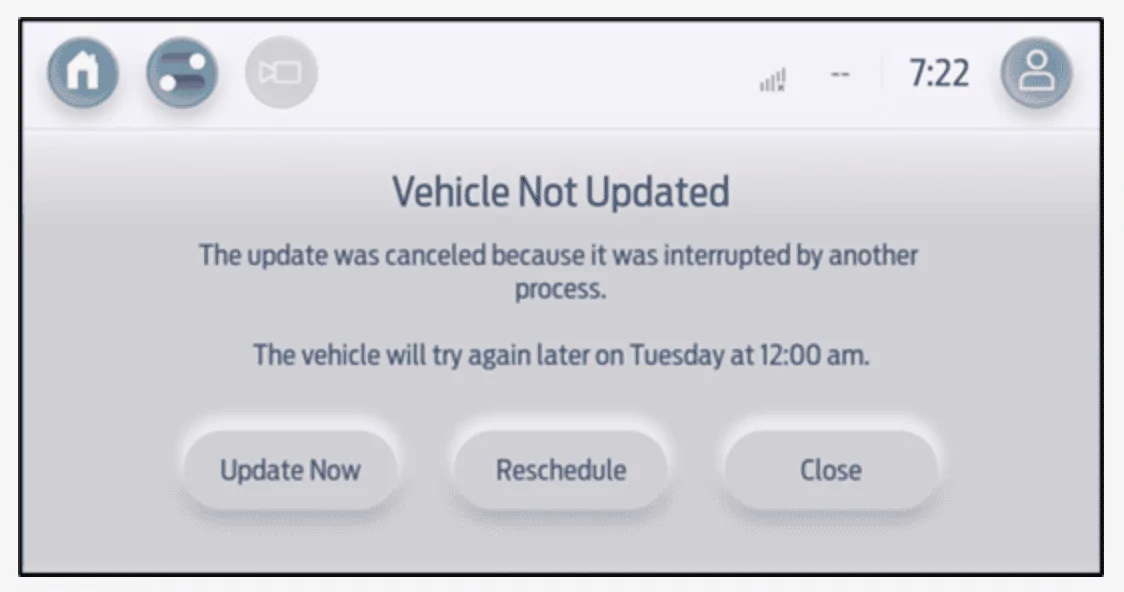

I just sent you the error which is stopping your update. The error stopping it is definitely low battery state of charge.
