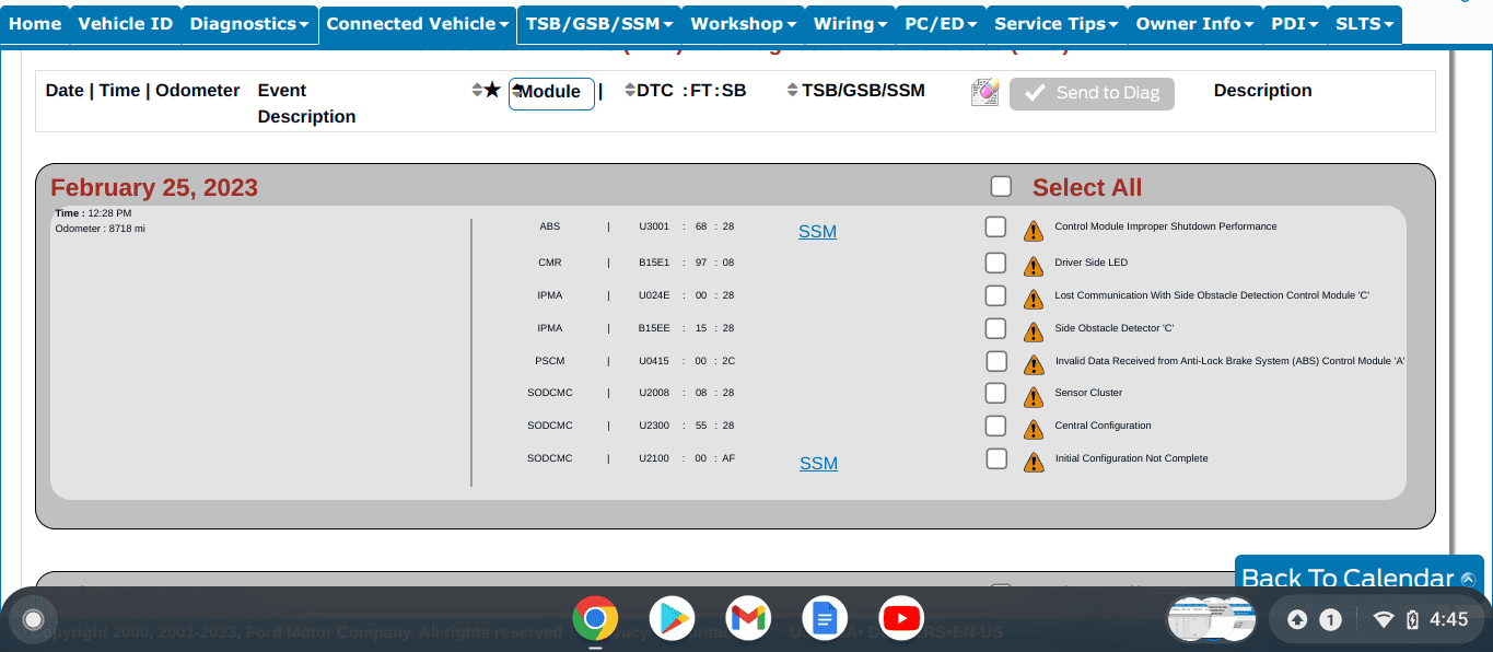

Thanks for continuing to help and support this forum and users. How can the other dealership want to order a gateway, when the answer is truly this easy to find remotely by someone else.
I wish I could help more. I have no idea where the gateway module stuff is coming from. I see no gateway related codes in his truck.

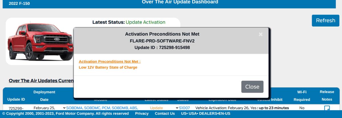

I just sent you the error which is stopping your update. The error stopping it is definitely low battery state of charge.

new update 3/6: tech did not update on 4th trip. Going back tomorrow for 5th trip.
OTA dept sees low state of charge on 12v battery.

I’m just posting to this thread for the update to my experience.
@Ford Senior Master has been helpful. I appreciate time he took to look up my info.
i tried many times with the battery charger - that never helped.
ultimately on 4th trip and 42 total days at dealer they replaced gateway module and a wiring harness. DTE update via dealer and FDRS. Waiting on all other 4.1.x updates.
senior master: on 1st trip in December they diagnosed side sensor error - tried nothing else
DTE downloaded and started failing 2 days before I picked up
2nd trip - they thought replacement side sensor was faulty - did nothing else
3rd trip - diagnosis was faulty wire harness and gateway module
4th trip - install gateway & wiring harness. Told it communicates with side sensor module without error.
now I wait and see what behavior I have with future updates.
