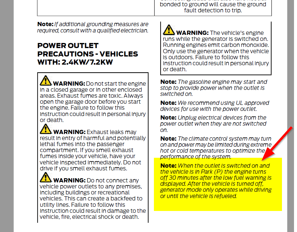

Saw that TFL video when they did electric bike too, in bed of truck . From the manual, generator mode while driving scenario in yellow:
