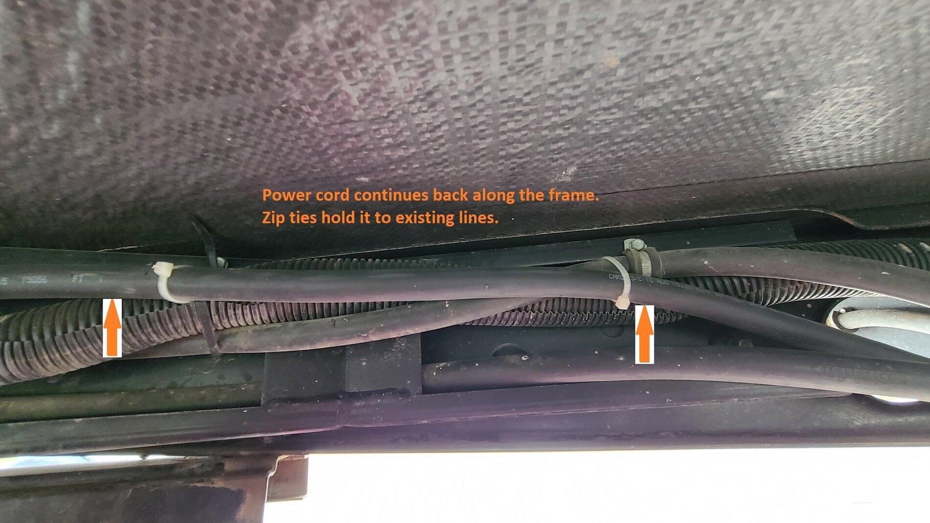

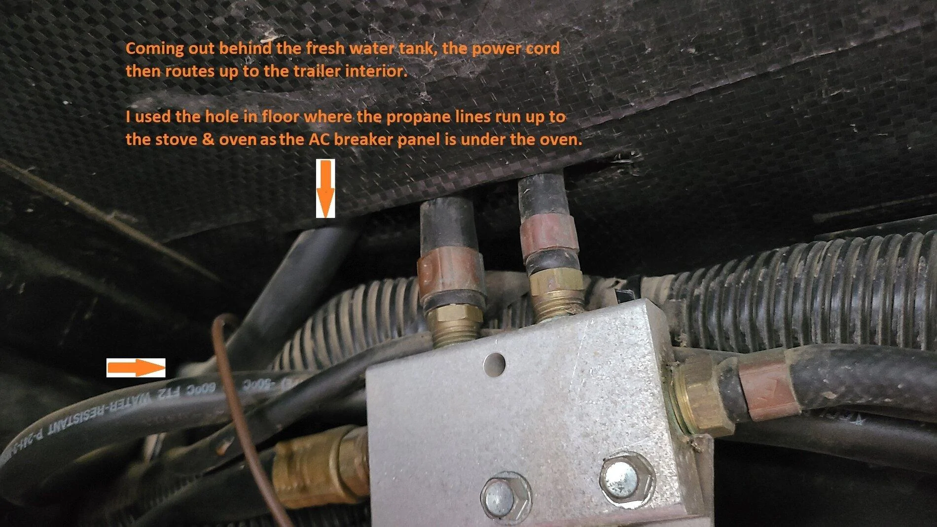

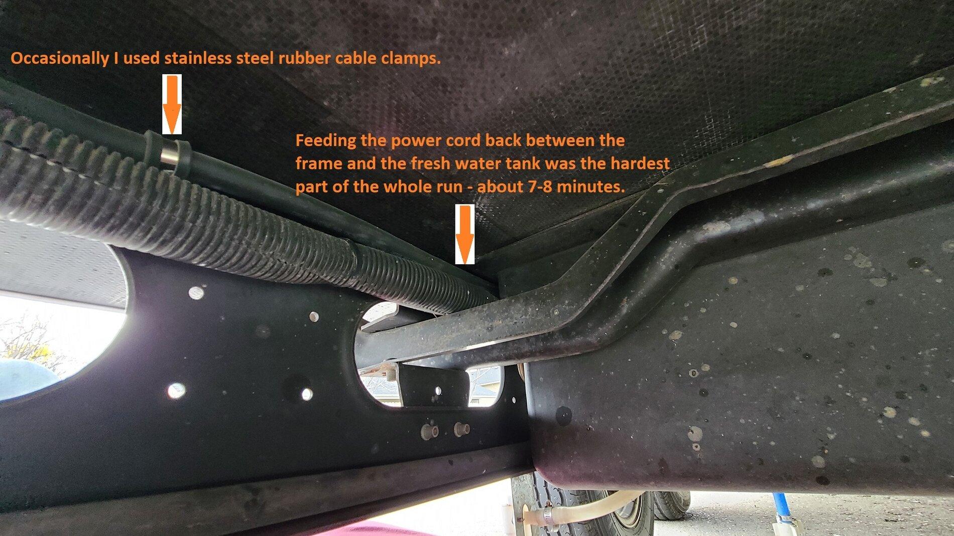

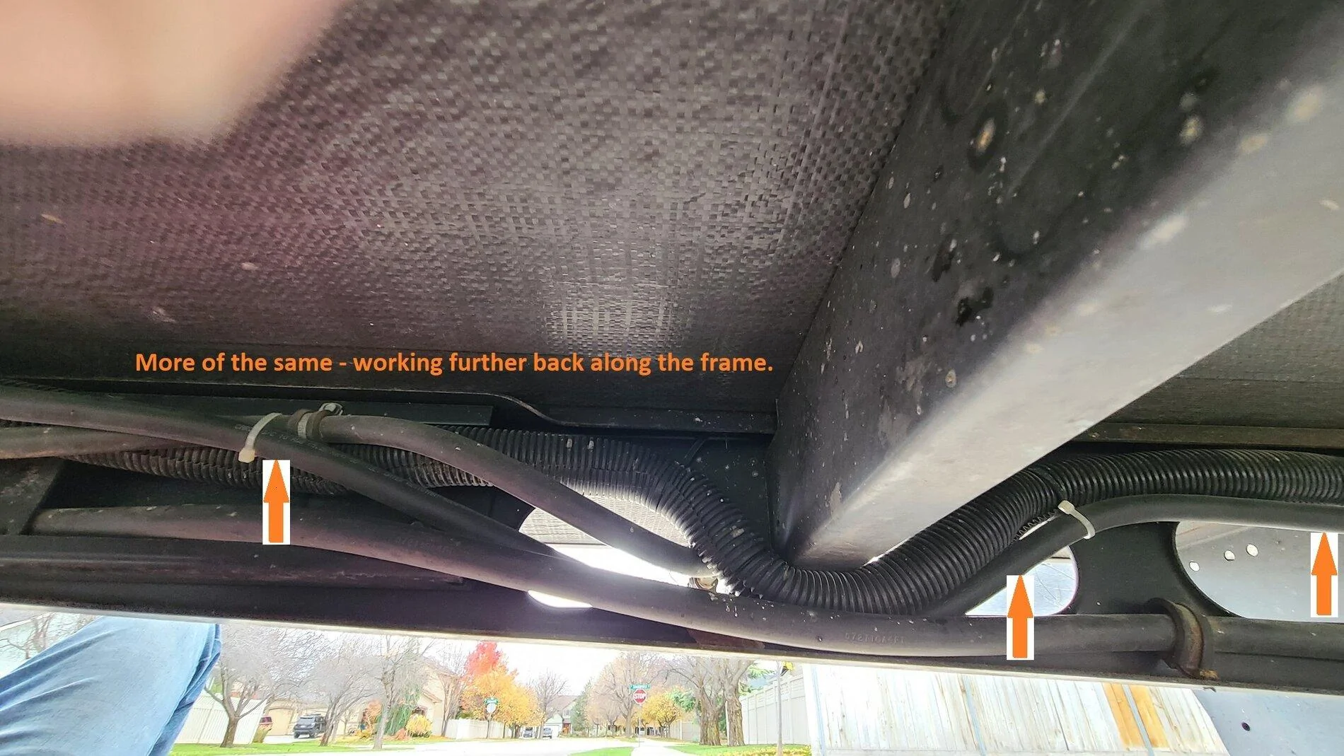

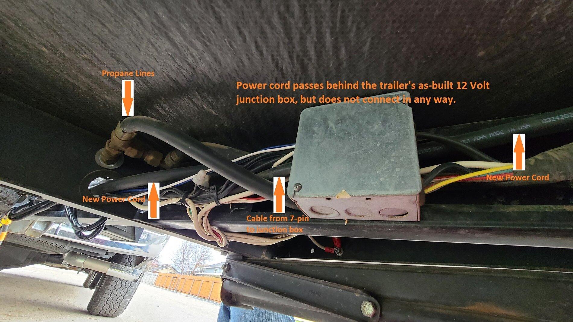

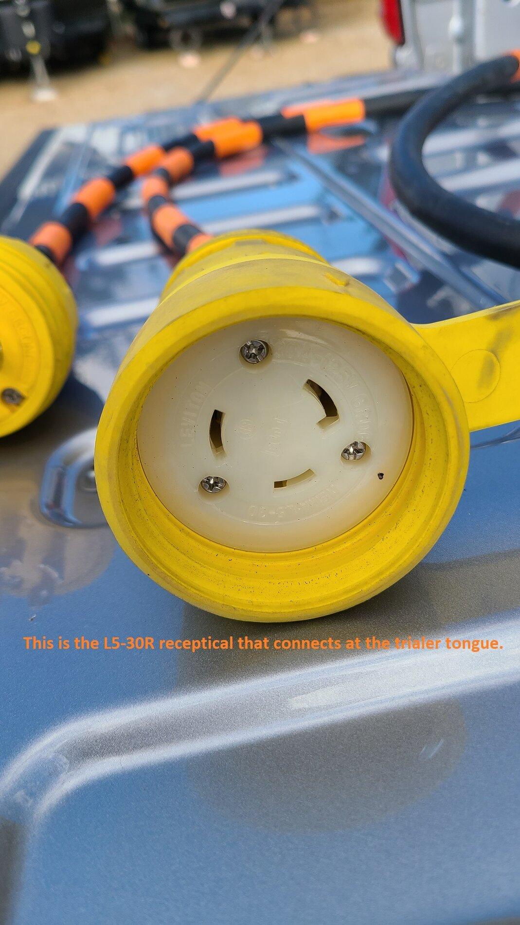

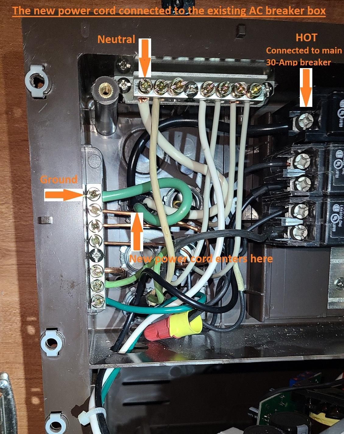

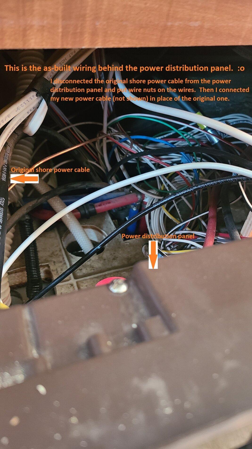

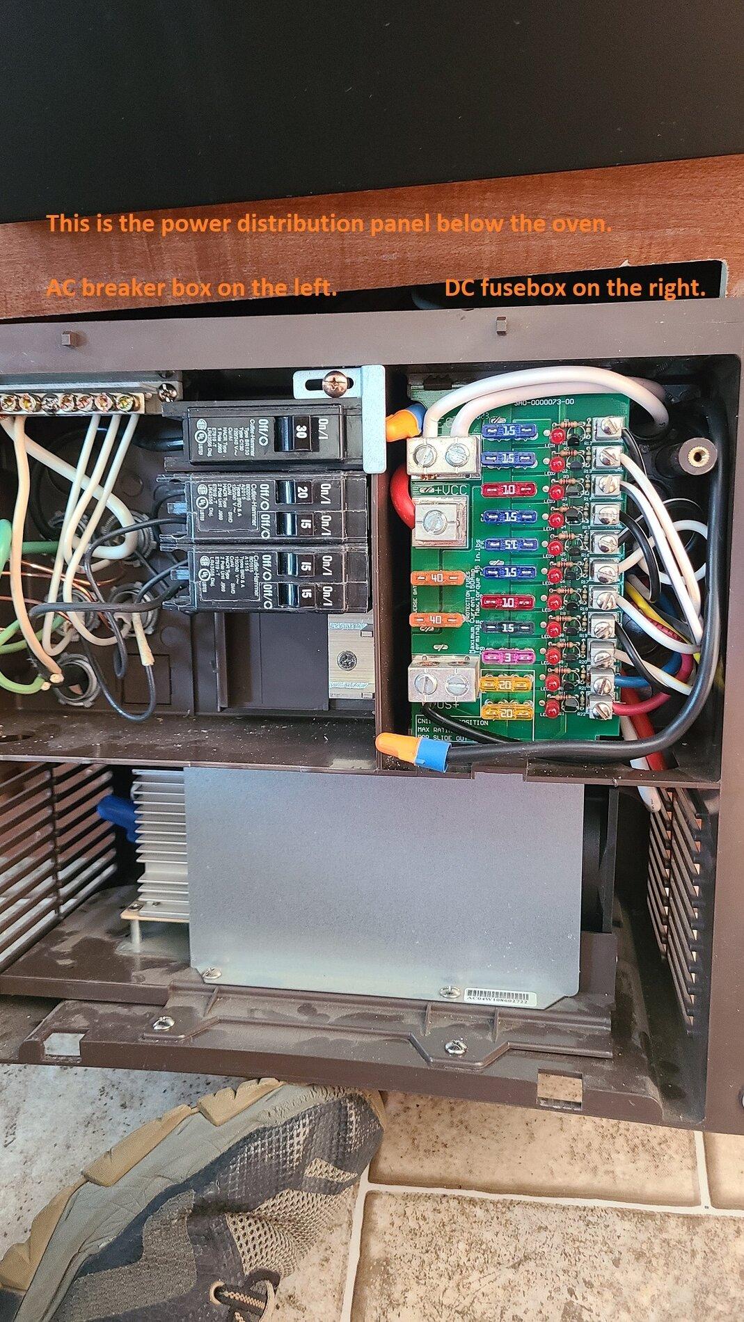

OK, per request here is what I did to get the 120V 30A power inside the trailer.
It was easier than I had expected.
Ford F-150 Lightning Pro Power Onboard Generator 7.2K Powering a Trailer While Driving -- IT WORKS! 20211105_170834
Ford F-150 Lightning Pro Power Onboard Generator 7.2K Powering a Trailer While Driving -- IT WORKS! 20211105_171625
Ford F-150 Lightning Pro Power Onboard Generator 7.2K Powering a Trailer While Driving -- IT WORKS! 20211105_171701

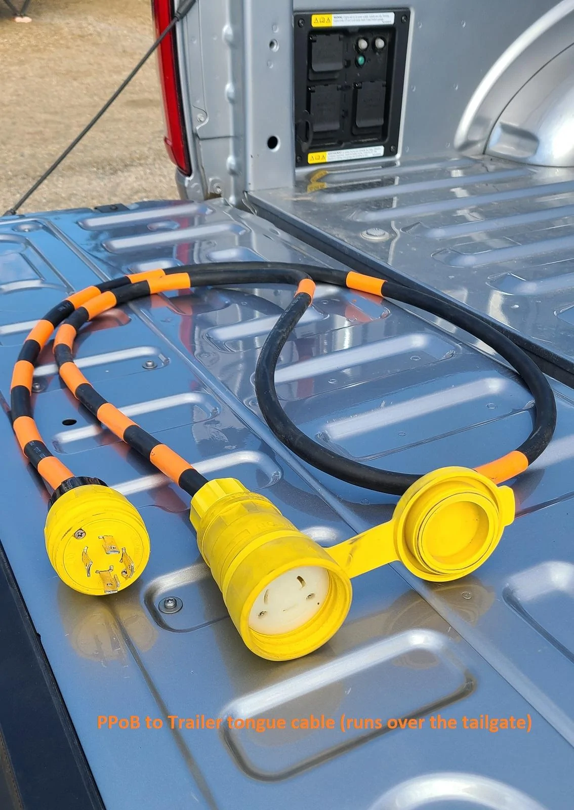

Actually, my early design iterations included a transfer switch - and I even bought (and returned) one. Then the light bulb went on and I realized I was making things harder than necessary. Shore power from a RV park pedestal can simply connect to my new power cord's connector up on the tongue.
Now all 120V power now comes to the trailer from the front, be it PPoB, RV park shore power, or even an extension cord from my house. Our RV's original shore power inlet is (as explained in the pictures) is disconnected from the trailer's AC breaker box and is no longer used.
For that first trip I used the same shore power cable that we have always used. I just connected to the new connector on the tongue instead of original one on the side of the trailer. For next spring I will make a longer shore power cord (say 40 feet) using another of the watertight connectors.

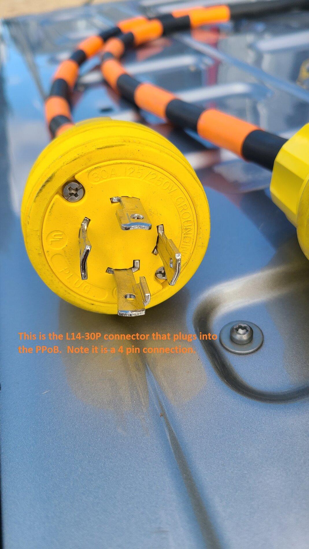

The L14-30P connector that plugs into the PPoB has 4 pins (ground, neutral and 2 hot leads). However if your trailer has 30 Amp service like ours, you would only use 1 of the hot leads of the L14-30P as the power cable has only 3 conductors. In other words, connect the ground wire to the ground lug, neutral wire to neutral lug, and the hot wire to only 1 of the 2 hot lugs. The second hot lug goes unused.
If your trailer has 50 Amp service I believe you would use a 4 conductor wire - however I didn't research 50 Amp so you will need to do so yourself.
