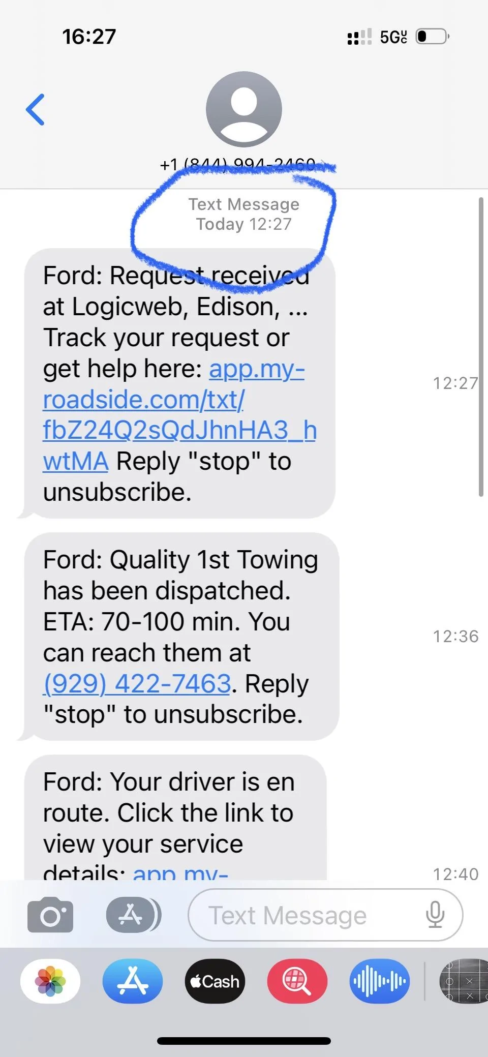

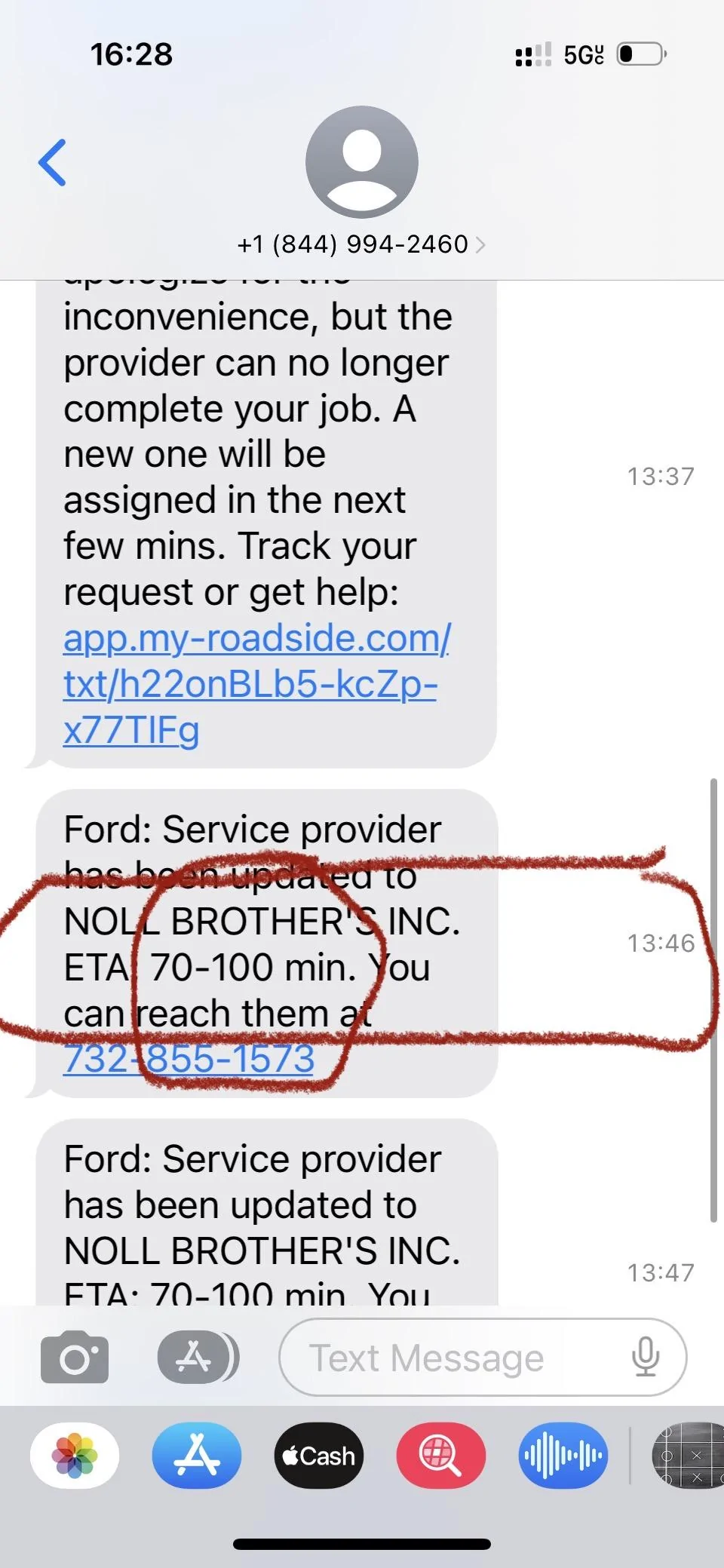

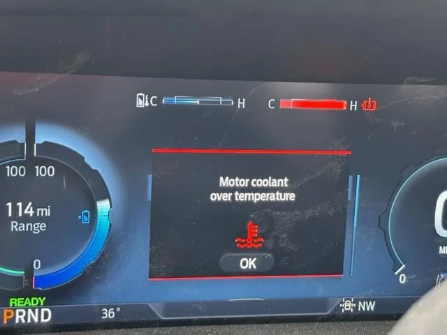

Was parked outside for over an hour in 37 degree weather. I started the truck to this error .
Called ford roadside and waited for an hour to have the tow truck company call and tell me an hour late that Ford never approved the payment for the tow. After back and forth with Ford Roadside and waiting in freezing weather for over 2 hours I gave up on Ford and I found my way home

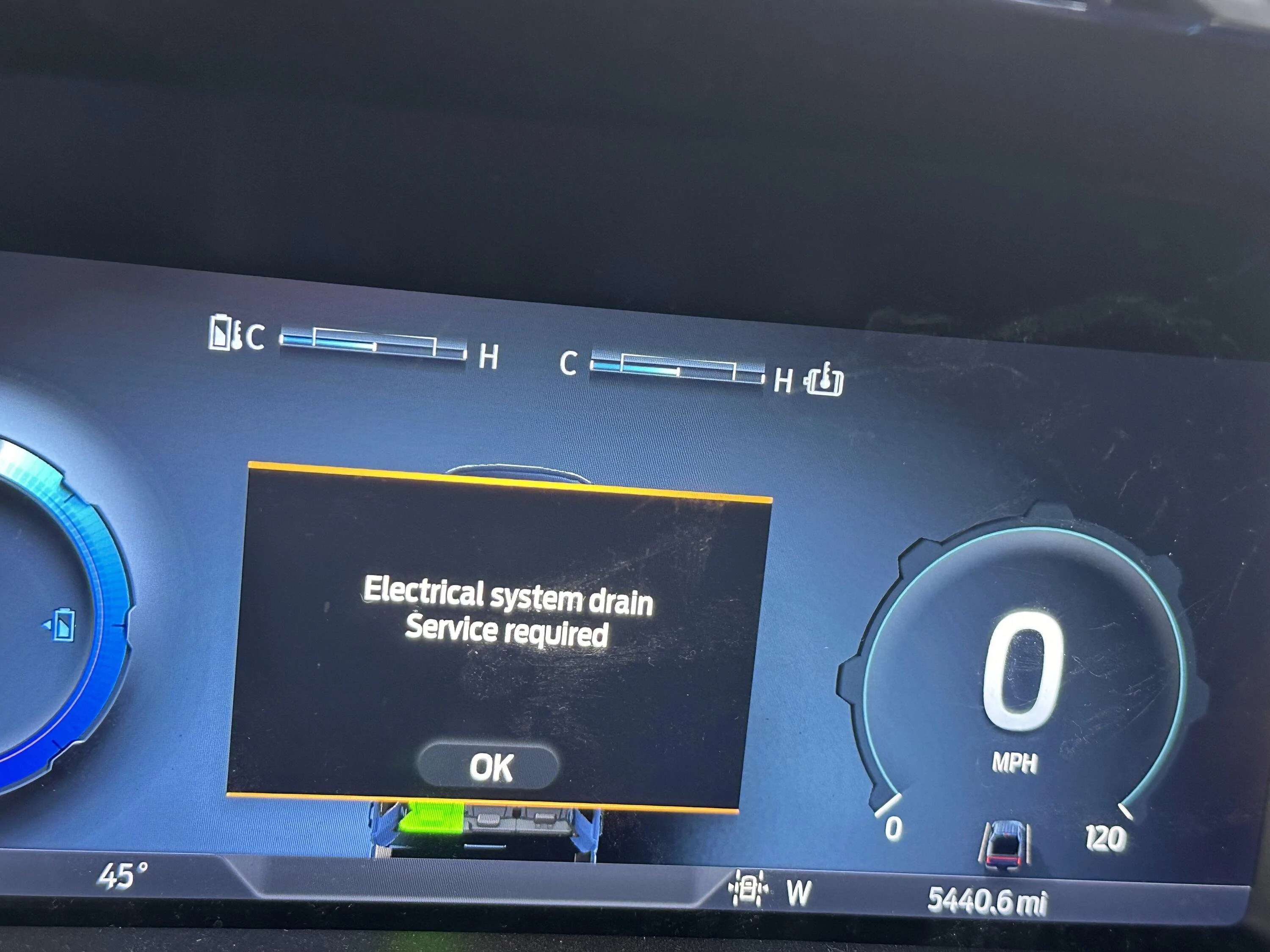

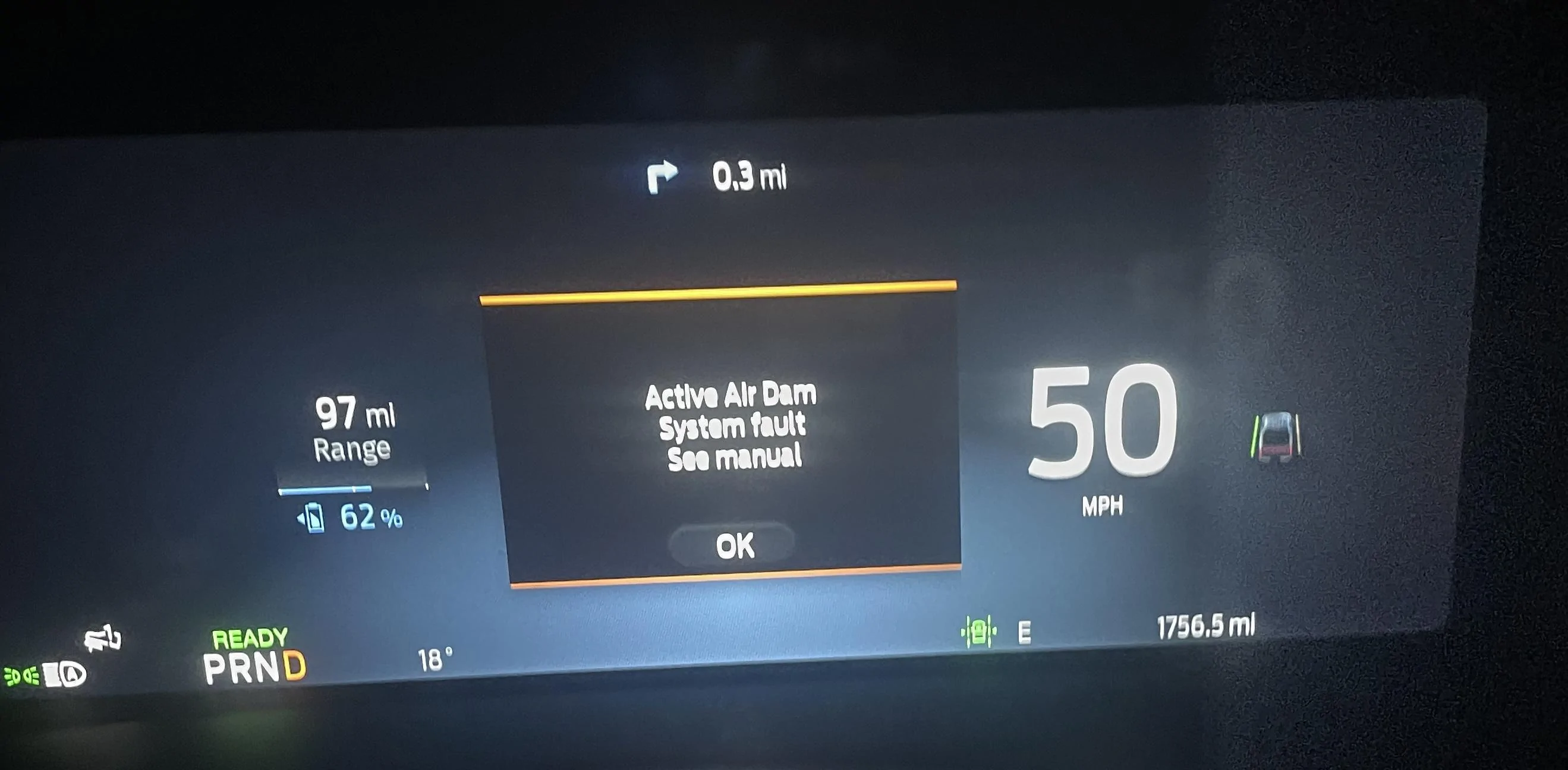

The screen flickers almost once a week and becomes non responsive at least once a week.
Other error messages I received have been attached.
I can’t really trust this truck do the reasons shown here.

Nothing you posted, but the overheating message, is rare.

Check 12v battery connections and grounds.
The overtemp is a sensor problem, could be caused by 12v problems or could be the sensor itself.
Did the dealer fix it under warranty?

Agree - motor coolant warning and the high temp red meter is rare.
Check if the coolant fluid is not leaking.
Take it to a dealer for a quick top off if needed.

Bring your truck to the dealer for proper diagnosis & warranty service

I got the same motor coolant warning on my 2023 Lariat ER (1,250 miles) yesterday, moments after starting the truck in my driveway. Have you found an answer as to the cause? It resolved a few hours later, and the dealer now is keeping my truck for however long it takes them to see the problem re-appear.

I didn’t get that error for the next 3000 miles. I called ford corporate this afternoon.
They are taking that vehicle to my local Ford dealer for service. Let’s see what they find.
