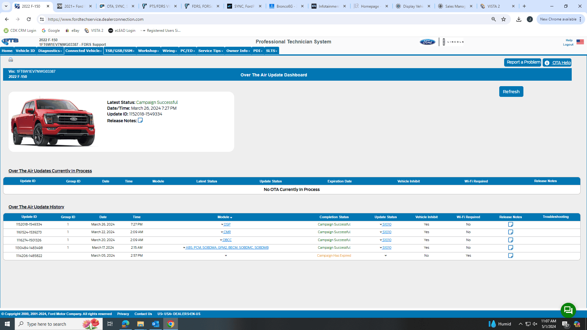

Please check mine, want to make sure I can use the Tesla chargers. 1FT6W1EV7NWG03387
Yes, you got the update for that on 3/20.

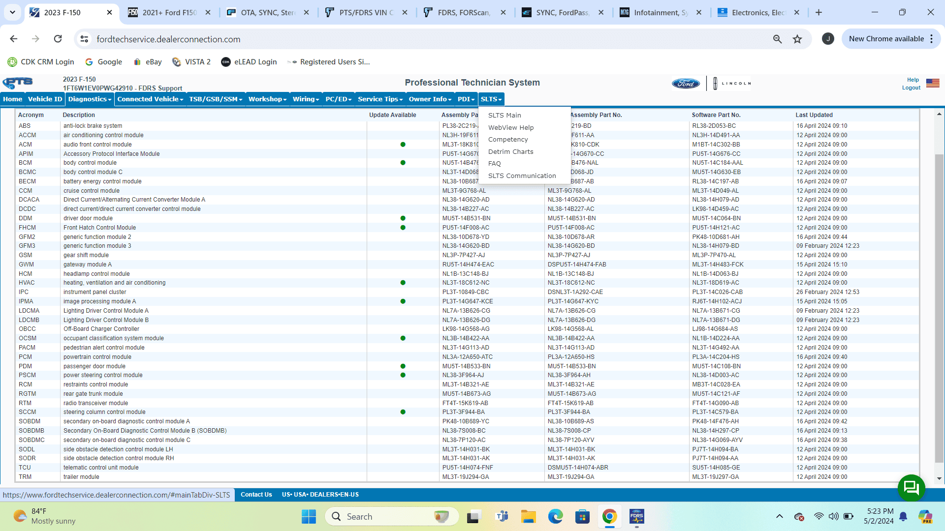

1FT6W1EV0PWG42910
I wonder if there are still outstanding updates after dealer visit..specially IMPA
Yes, this is what you show pending:

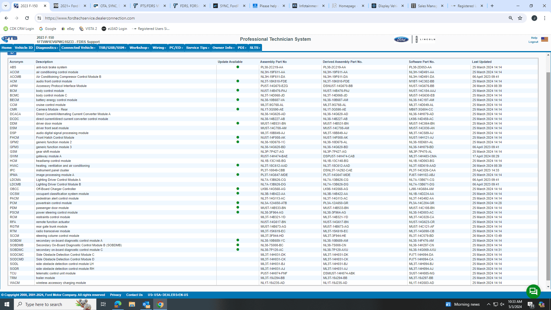

My bad homie. Fat fingered the VIN 1FTVW1EV6PWG10233. I wanted to know if I have any updates outstanding. I purchased the truck back in September and am still on 4.2.1.2.
Modules pending updates are below. You also have APIM, GWM and TCU updates pending that are not shown in this list.
