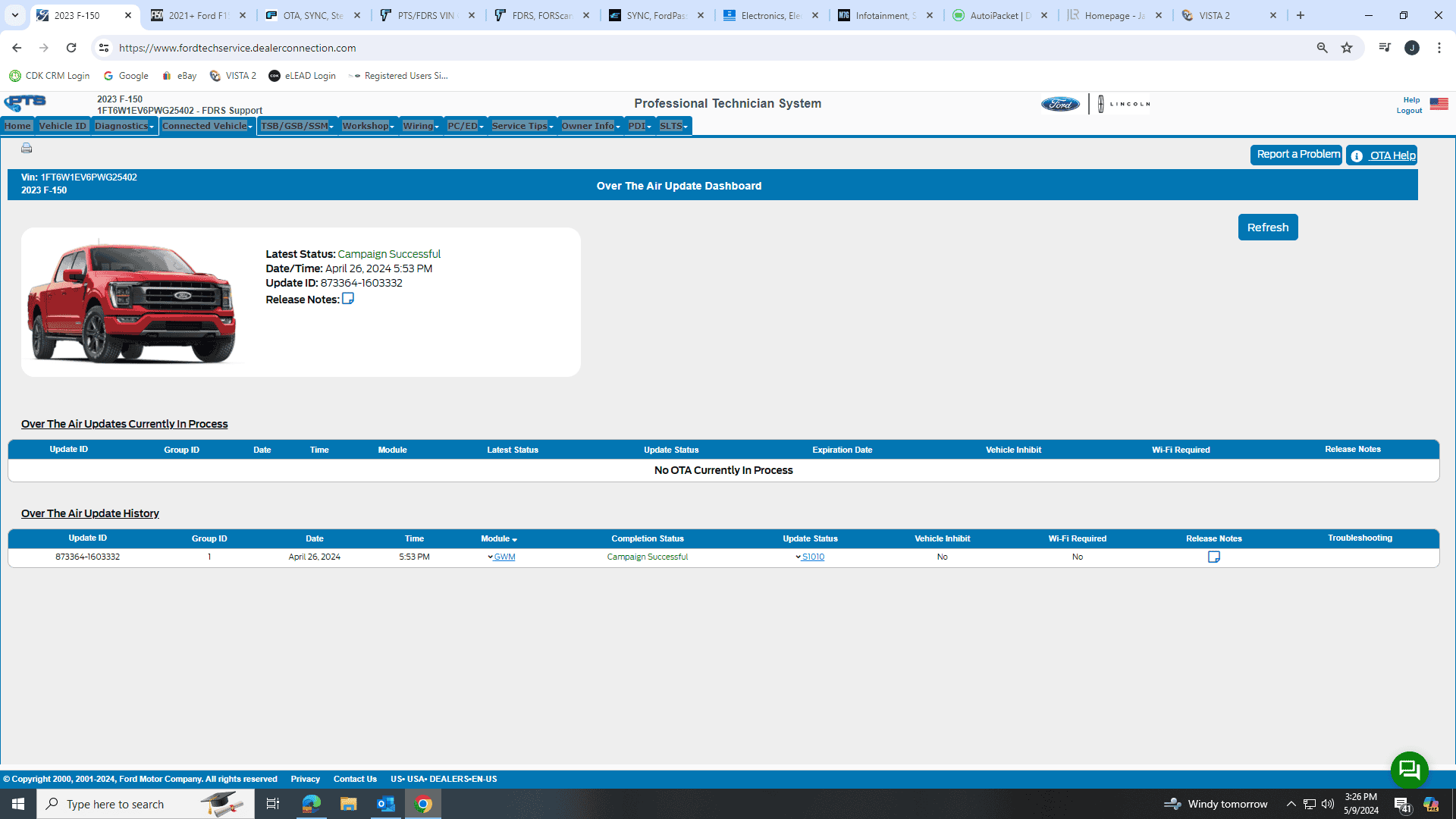

I’d appreciate your checking 1FT6W1EV6PWG25402 for pending updates. I bought the truck April 5 and received 4.2.1.1 April 26, although the truck still says “Ready to download” for the update status. I’d like to know if I have anything else pending and if 4.2.1.1 actually installed. Thanks!
That update went through and you can ignore the message you are seeing. No other OTA's have been sent to you since that one yet.

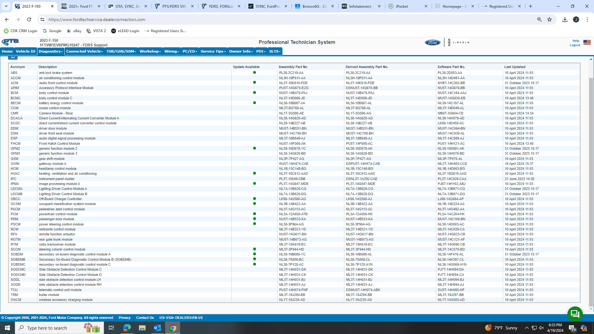

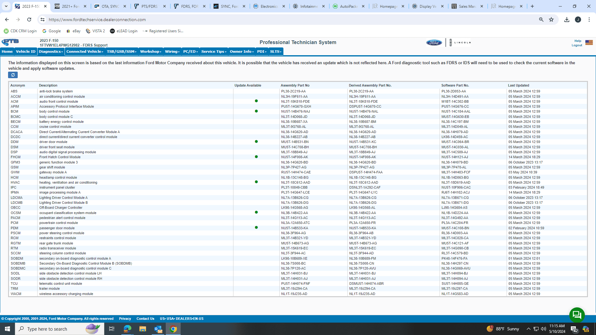

Feb build date; not OTA's sent yet but the truck is talking to the cloud just fine. Pending updates are below:
I am struggling to understand how to read this. My dealership is saying all available updates have been applied. I see a lot of April 10 “Last updated” on this report. April 10 was the date that I took the truck into the dealer to have a frunk problem fixed and they said they updated a bunch of modules.
So on this report, I see some Green dots under “Update Available” where the “Last updated“ is April 10 2024. If there is a green dot, doesn’t that suggest that there is an update available, but not installed?
Other green dots beside modules that show as last updated in Oct 2023.
I read this report as every line with a green dot is an update that needs to be installed. Is that not how I should be reading this?

@tbkfan Green dot means the module has a pending update. Ignore the dates on the right in terms of what you are trying to know. That is the last date a particular module reported itself to the server.

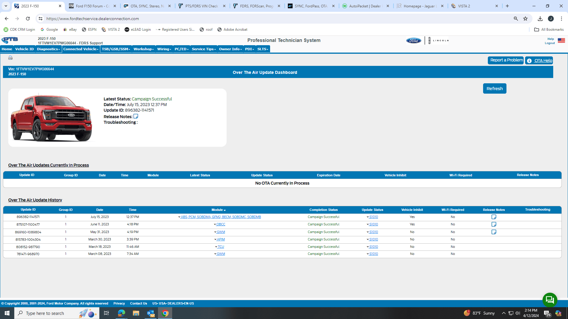

Just bought this used ‘23 Lariat SR. I’d love a check when you get a chance.
1FTVW1EL4PWG12982
rugedraw
rugedraw
Javier
Dec 14, 2021
1,779
2,145
Miami
Auto Sales
1FTVW1EL4PWG12982
OTA history only shows one minor connectivity update, but the truck is on the latest Sync version and does not show a lot pf pending updates. Seems like this truck was manually updated with FDRS at some point. I would not expect a lot of OTA's due to the fact that a lot of the updates have already been done.

Jrunner82
Justin
May 9, 2024
Wisconsin
‘23 Lariat SR
Finance
Thank you!!!
