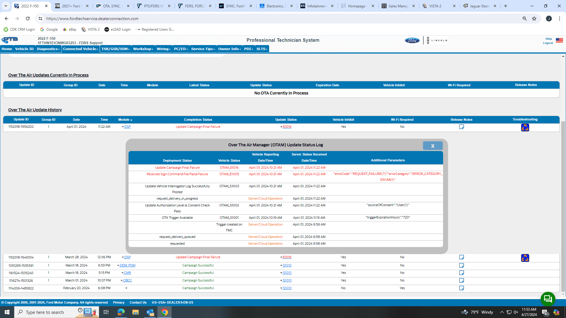

When you get a minute would you give my vin a check please? 1FTVW1EV3NWG03253
My last update failed while it was at the dealer for a few weeks - that was the audio-dc. I got an email today that might indicate I got another update (nothing on the screen) or will be getting one, or Ford has just toasted their communication again and the email has nothing to do with me or my truck.
Thanks !
DSP update 23-PU1024-6CH-AUD has failed twice due to some server related error. Nothing you did wrong or could have done differently. Just gotta wait for it to be resent and hope for better luck next time.

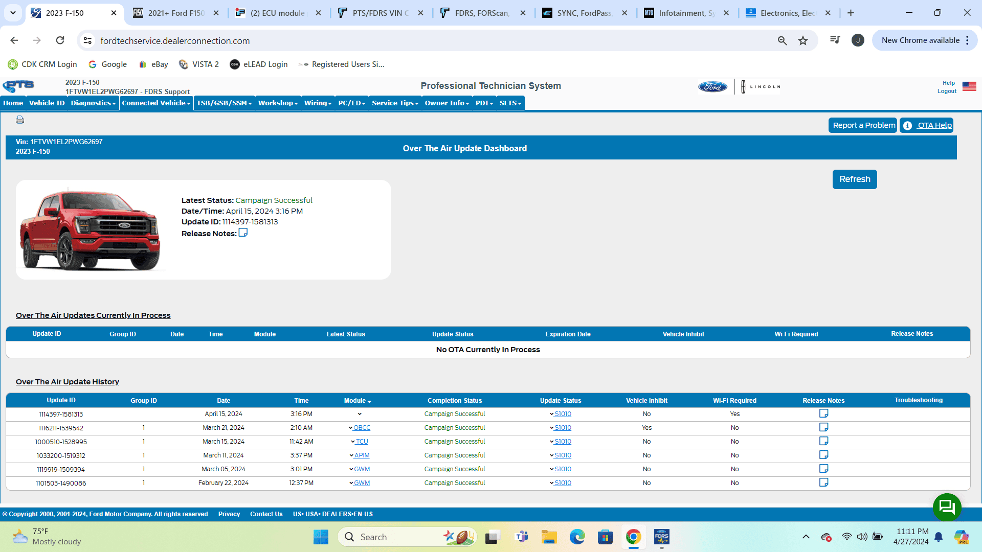

Do you mind checking my VIN 1FTVW1EL2PWG62697
rugedraw
rugedraw
Javier
Dec 14, 2021
1,779
2,145
Miami
Auto Sales
You're on the latest Sync version and have recent OTA history. 6.4.0, the tesla charger update and a minor connectivity update were the most recent three. Still missing a few, but nothing to worry about. They'll come in eventually.

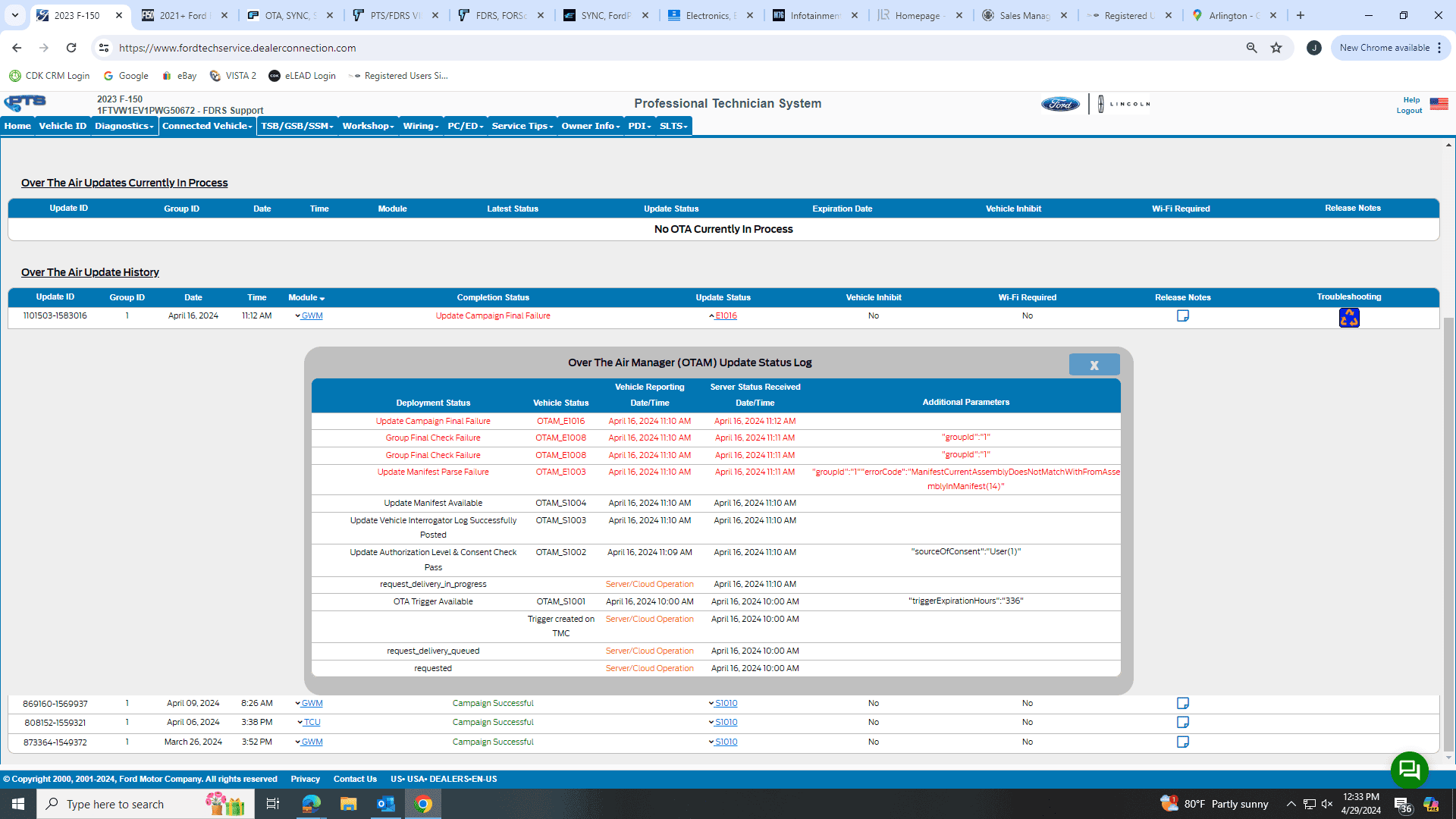

Hoping you can check on things again for me. I currently see this on my screen for updates, but it hasn't done anything with this update and it has shown it for over a week.
VIN: 1FTVW1EV1PWG50672
The update failed due to a manifest mismatch. There's nothing you can or and there's nothing you did wrong. Just gotta wait for it to be resent and hope for better luck next time.

Thanks. Thats such an awesome failure. I'm guessing a dealer visit wouldn't help with this either?

You can try. They'll be able to see the failed update. Not a big deal, imo. You'll get it resent.
