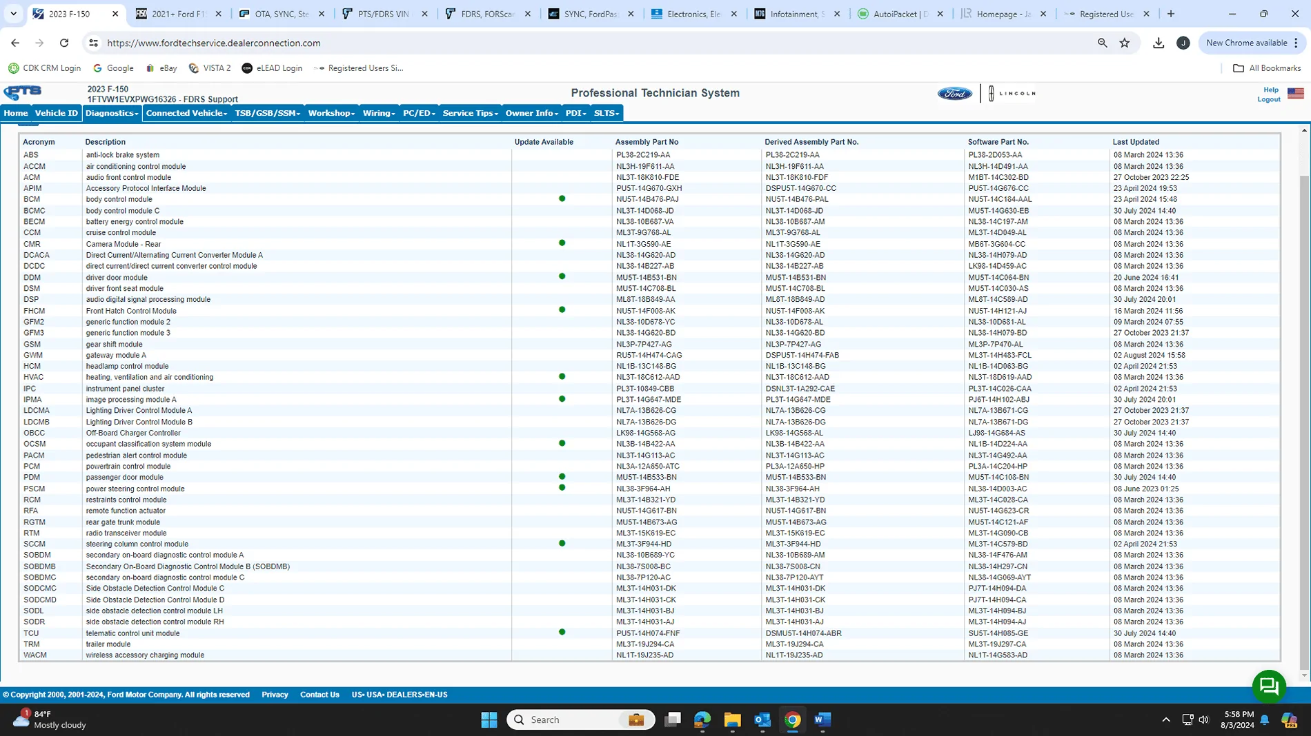

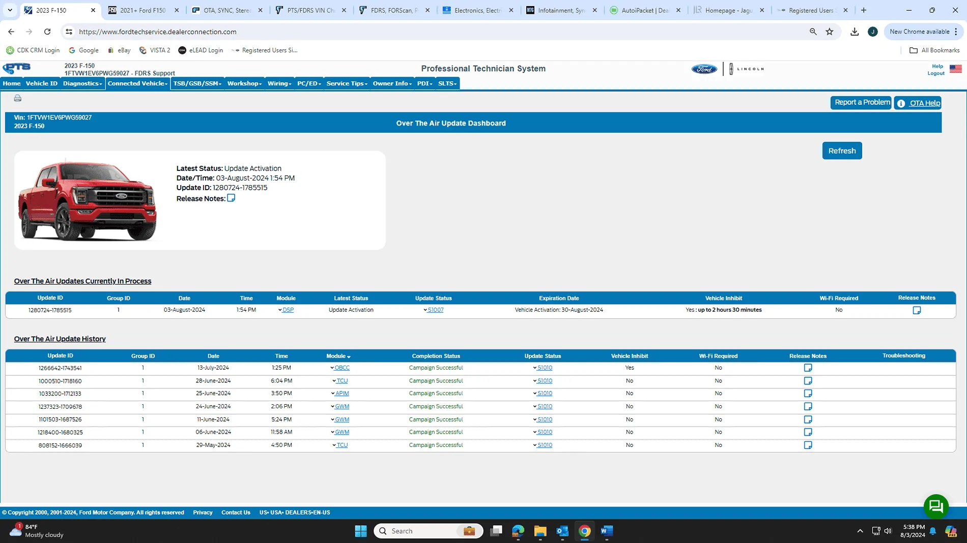

Hi! How about 1FTVW1EV6PWG59027? Been a struggle…
Truck is on the latest Sync version and you have a healthy OTA history. Matter of fact, you have a DSP update in your queue trying to install right now that has failed a few times due to low battery capacity. The charge itself is good being reported at 90%, but capacity is low at 17 of 35. Throw a charger on it overnight, or drive it for a good 20-30 minutes with the a/c fan speed set on 5 to force the LVB to get charged.
Ford F-150 Lightning PTS/FDRS VIN Check Thread 1722721122550-dt
Modules pending updates are below:
Ford F-150 Lightning PTS/FDRS VIN Check Thread 1722721270255-18

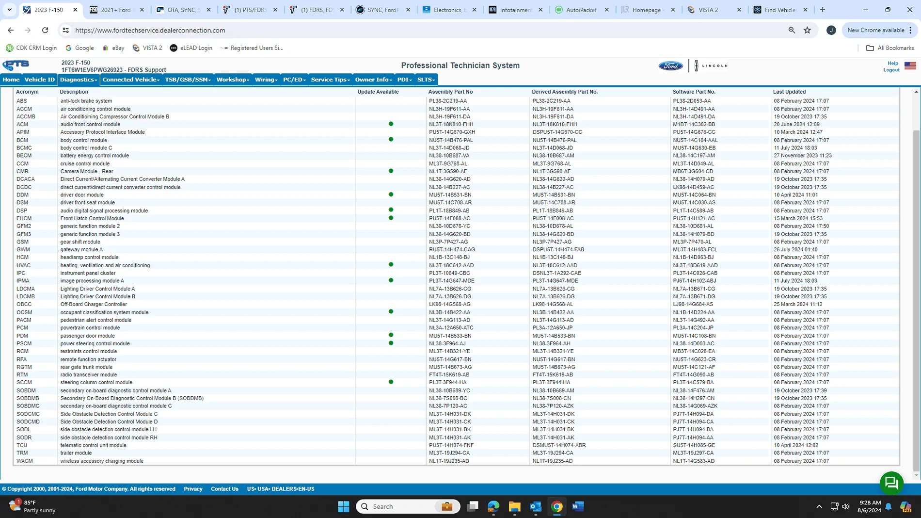

It's been awhile, but somewhat curious. I've started getting updates.
1FTVW1EVXPWG16326
Truck is on the latest Sync version and modules pending updates are below:
Ford F-150 Lightning PTS/FDRS VIN Check Thread 1722722347477-mt
Thank you!! Drove it around and got the update to work.

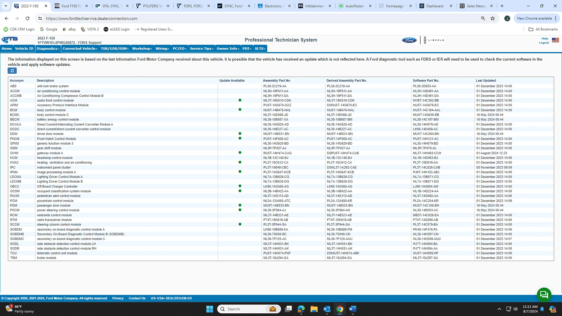

Hello Rugedraw. Thanks so much for your help here. Could I please add mine to the list?
1FT6W1EV6PWG26923
Truck is on the latest Sync version and got a very recent GWM update in June. Modules pending updates are below. Nothing to worry about here.
Ford F-150 Lightning PTS/FDRS VIN Check Thread 1722950943619-ls
