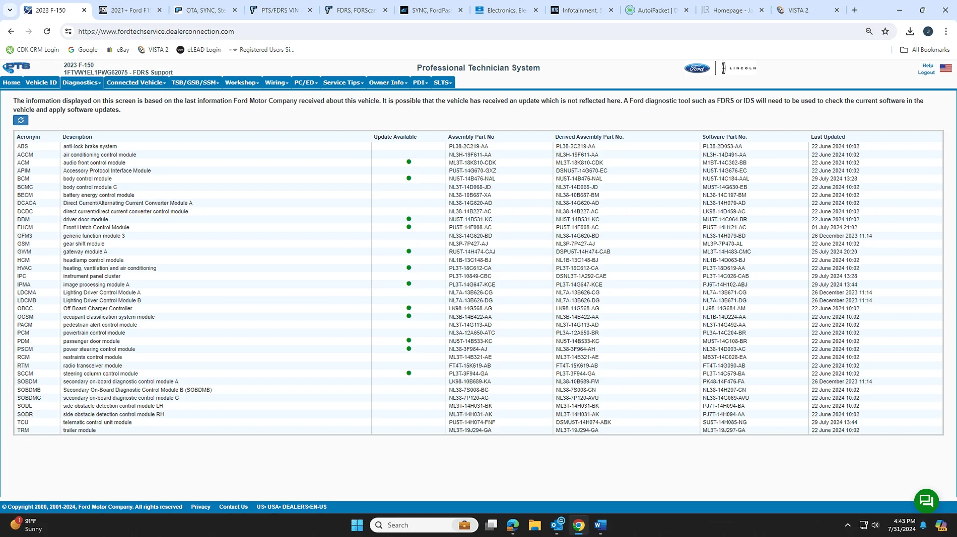

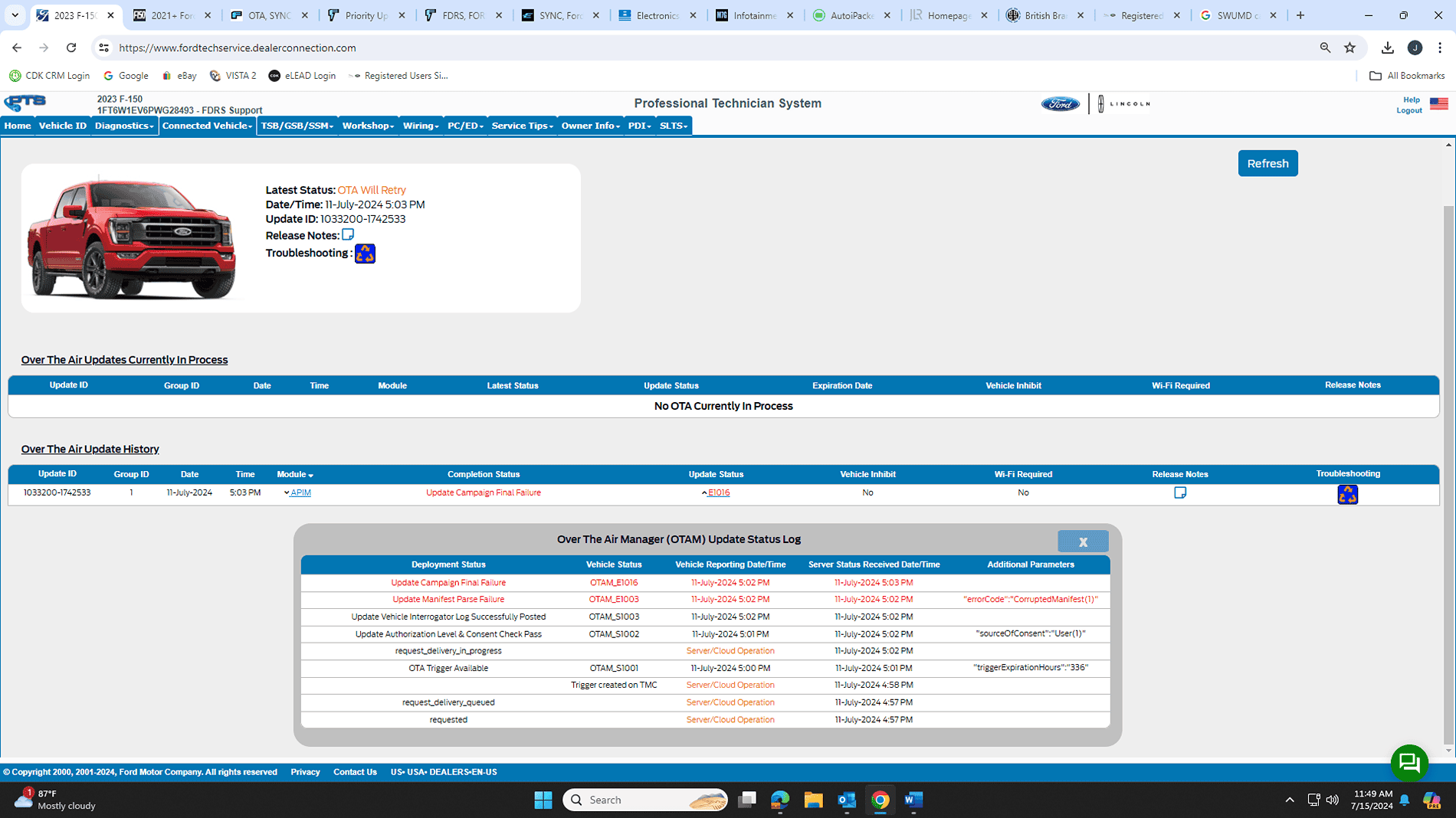

It seems like they did everything that was showing. Your truck is on Sync 22326, and I see they tried updating the APIM a couple of time with no success. The update you are looking for that shows the % is for the IPC. However, that update requires other updates being installed before that one can be installed. Because they were not able to update the APIM, they were able to get far along the process in terms of the key modules that need to be updated before that IPC updates gets released on the server side.
I do not have a good explanation as to why the APIM update failed. What I can tell you is that if it were my truck and I was updating it and the APIM update failed, I would have kept trying until it went through. With that said, they went way above and beyond what they are required to do by doing what they did. You'll have to wait for the OTA process to get you what you're missing.
It failed due to a corrupted manifest. The files the mothership wanted to send were either bad or incorrect. There is nothing you did wrong or could have done differently. Nothing to do but wait for it to be resent with the correct files.

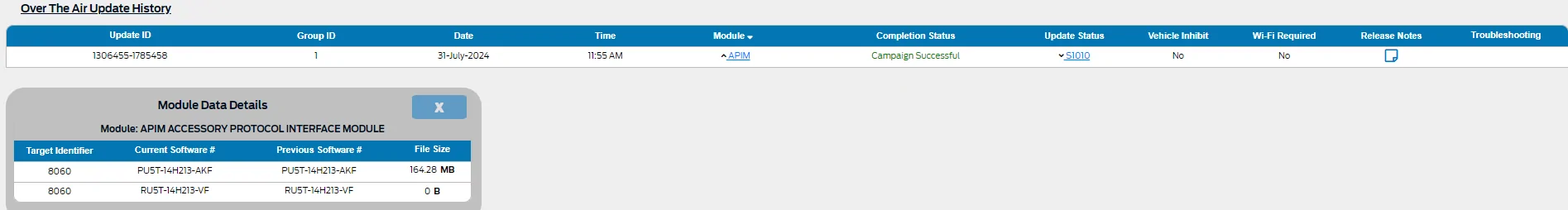

FSE is a field service engineer and DET is the magic software Ford uses that's better than FDRS. When that software is used, it does not record anything in vehicle history so I cannot see what was actually done. However, I can tell you they updated everything. You are only showing a TCU update pending which may have popped up after the fact.
The 2.7.4 OTA you got was originally an IPC update for Job 1 F150's that shipped with the hardware for BC but not the software. That was on of two IPC updates needed to add the animations for BC. However, it was reported again in the F150 forum as a BCM update in November of last year causing a lot of confusion over there. In your case, it is an APIM "update". As you can see below, the file is the same. Chances are, this was sent to you to correct the config in some location of the APIM. I do not know what this is intended to fix.
As far as the IPC not showing the SoC, the FSE would have been the one to address that. Ford would have to release the IPC update on the server for you. The dealer can't help with that. Nothing you can do but wait for it to be released for you at this point.

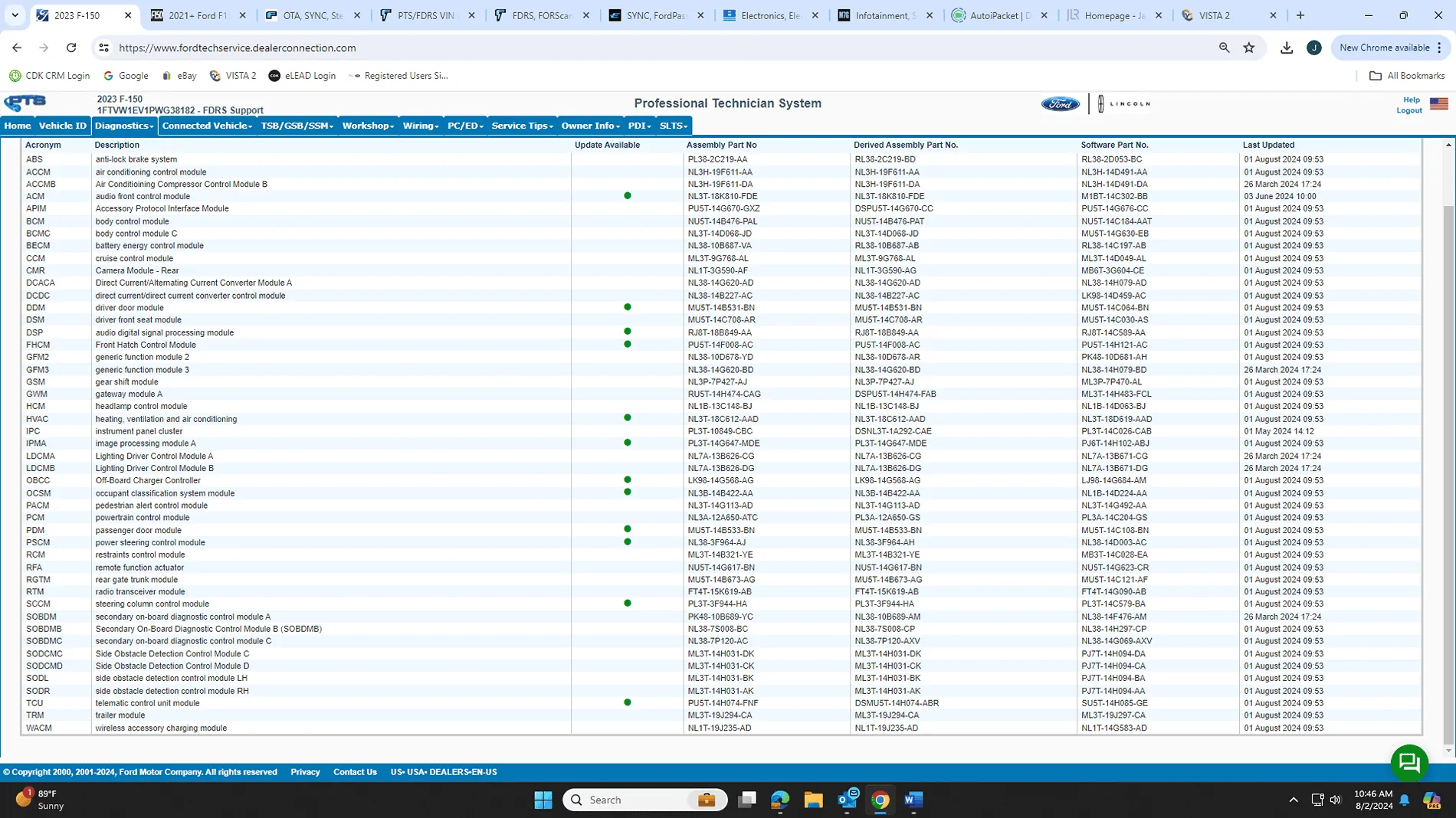

Your list is below. Yes, there are some powertrain updates that are on hold for the Lightnings. What I don't know is if those update address the capped charging issue you're describing or another module will help fix that (OBCC maybe, or that could just be the tesla charger update). Maybe @Mike G can chime in since he is more familiar with the EV's than I am.

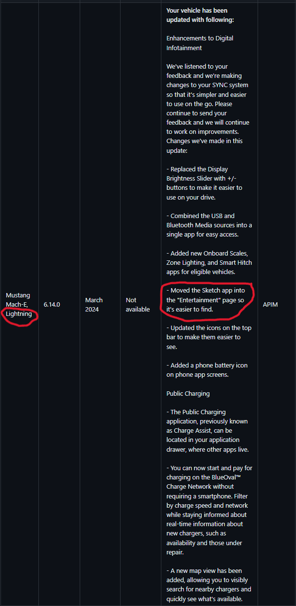

Oh damn I must be overthinking it lol...lemme see if I can understand this. The IT/Research Project Manager in me is coming out it seems!
Ok, understood for the SoC IPC - the benefit of that one is that it's easily verifiable if you have it or not, as it can be seen on the cluster in everyday usage.
But for the others - when you say I "have all those updates already" - if I (or you in FDRS) can't see what historically has been updated how do we know? Is it because they aren't "released" or in a queue for my VIN in FDRS?
Only issue I see with that would be that if Ford hasn't "released" them for my VIN in the first place, then we'd never know if I'm getting it tomorrow or next year, or, more importantly, already have it.
Slightly off topic, but IMO FDRS (at minimum) should show the following:
  • Applicable to VIN
  • Released to VIN
  • Completed
Could be all in the same screen by means of column usage.
For the 6.14.0 one, since it hasn't been made available to F150s/Lightnings...yet I made note of updates from those very release notes that are now present:
  • Sketch app changing location
  • USB/BT media apps being merged together
These are the only changes that I could easily verify to have occurred before and after FSE visit.
Does that mean that portions of updates (like chunks of this 6.14.0) can be delivered via other means (in my case a FSE doing everything under the sun)? Or combined with APIM updates, etc?
I guess it boils down to: how do I have some pieces of the 6.14.0 update, without getting the 6.14.0 update?
