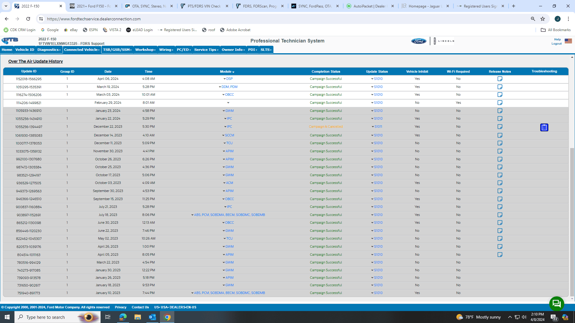

Window sticker is attached and shows no deletes. Your truck seems to be favored by the OTA gods and has a very extensive and healthy OTA history. Only missing 6.13.0 and a few PU updates.

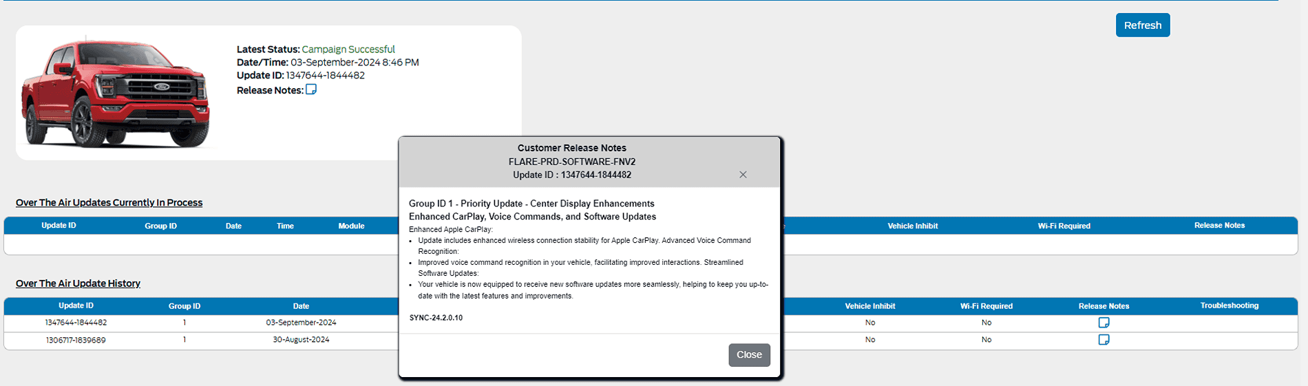

I got your message. The update you got is a brand new Sync software update that brought your Sync version up to 24058. This is the newest Sync version out there.

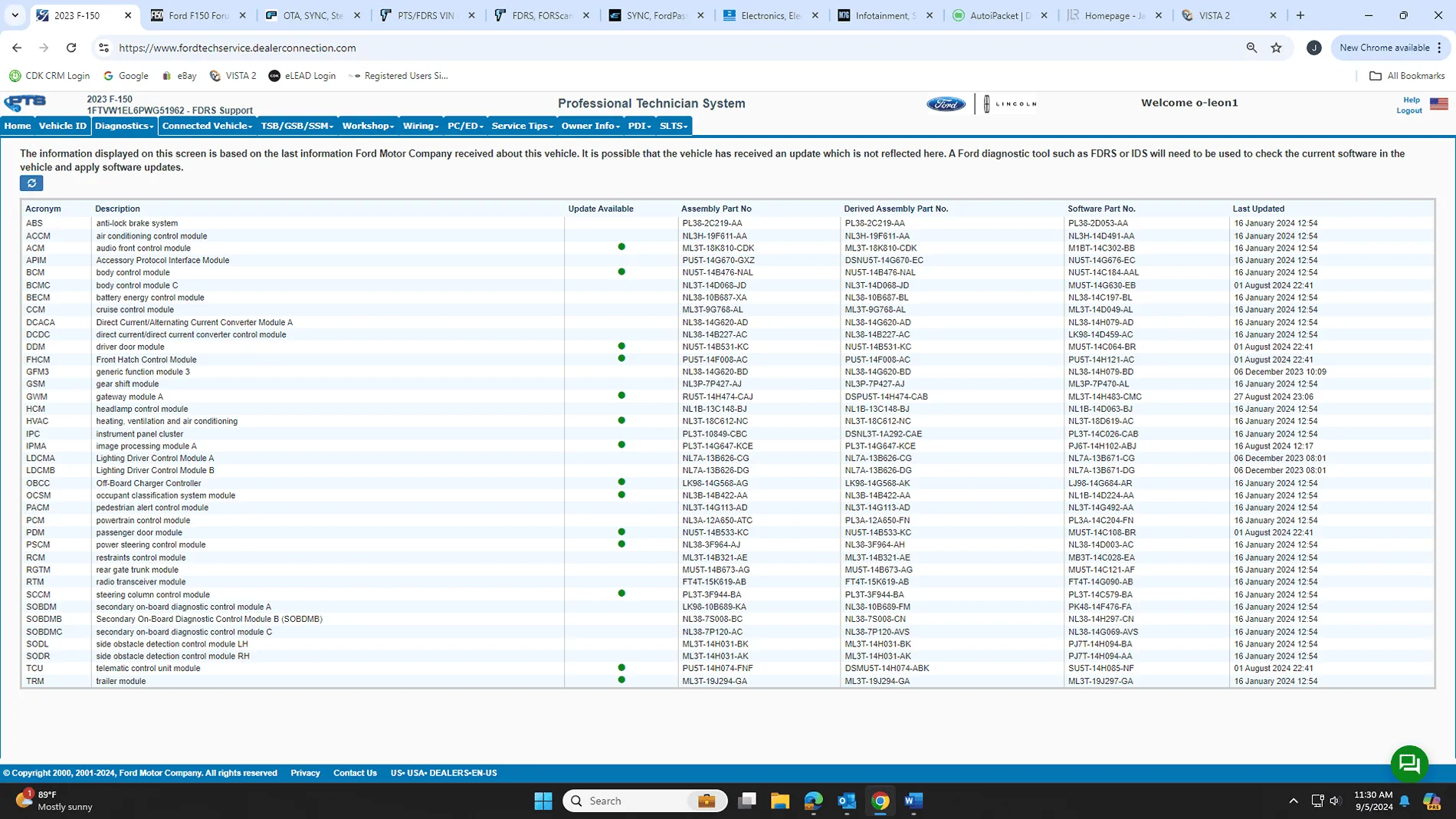

It's on Sync 23159 which is one version behind the latest one. Modules pending updates are below. Once that GWM you see there is updated, it will release more updates for other modules that are not showing an update pending now since some updates are installed sequentially.

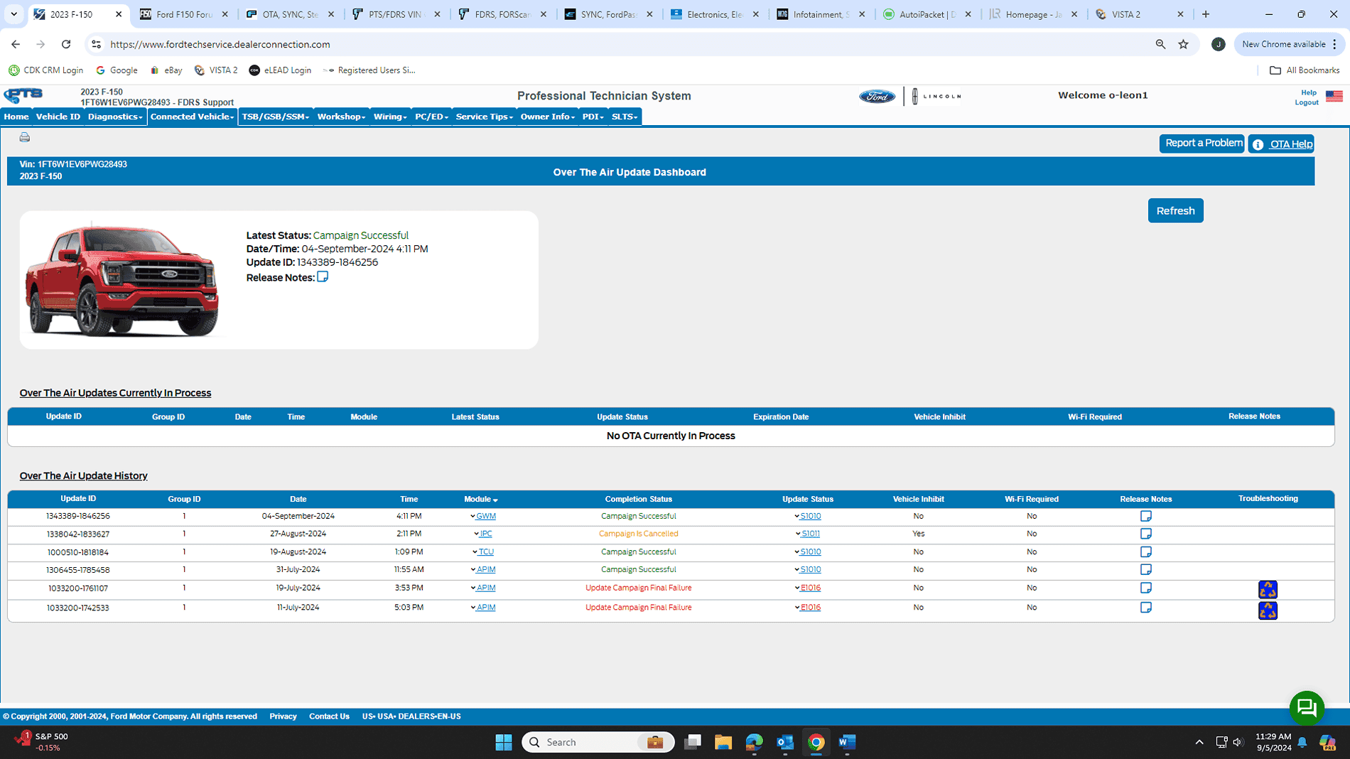

6.4.0 went through. Yu were then sent 6.8.0 which was canceled on Ford's side with no reason as to why. You then got the ECG update sent and that one went through, too.

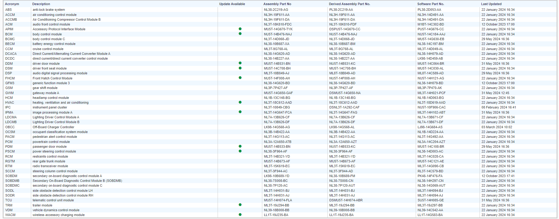

Well, a new Sync update was released in the past few weeks, so now you are two behind. Pending updates are below, but if you're expecting the dealer to do all the updates for you, I would brace myself for disappointment.

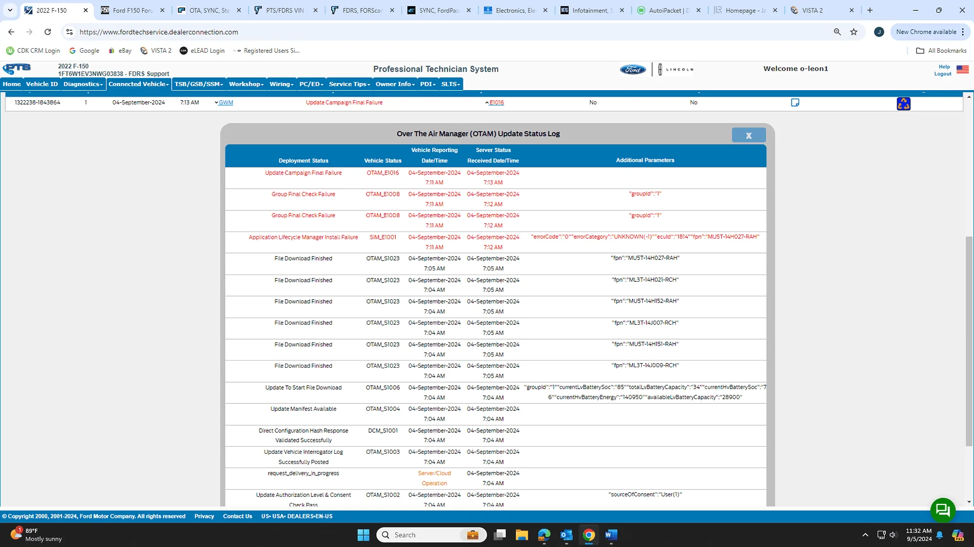

@rugedraw Can you check 1FT6W1EV3NWG03838 for why my last update failed?
The reason it failed is unknown. Literally. It mentions on of the files it downloaded on the same line where the OTA was indicated as failed. Maybe it had trouble writing on the files and it failed? It's hard to tell why when the notes are vague like this, but you didn't do anything wrong.

You are not showing an APIM update now, but it is highly possible that if the GWM you see there is done, an APIM update may be released afterward.
