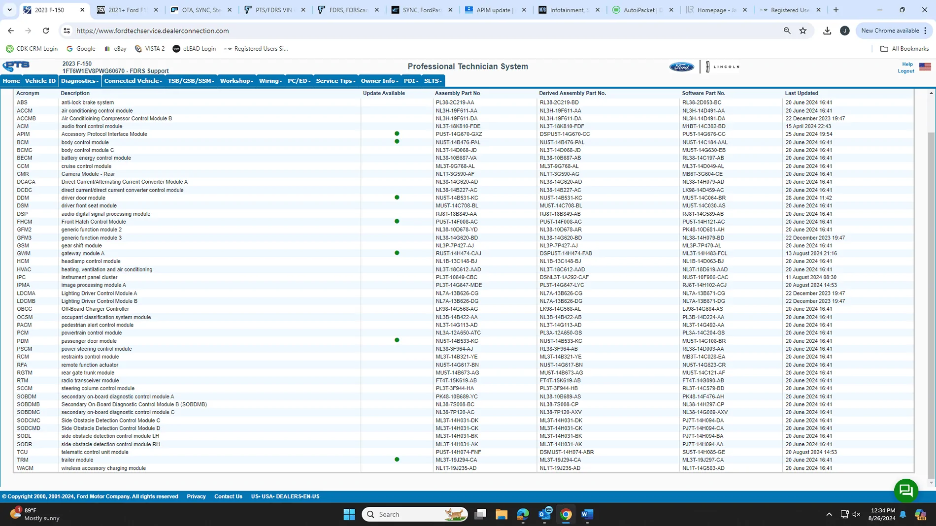

Hello, can someone check to see if there any updates worth paying the 2 day license of FDRS? Thank you.
VIN: 1FT6W1EV8PWG60670
This is what you show pending:
Ford F-150 Lightning PTS/FDRS VIN Check Thread 1724690057458-d3

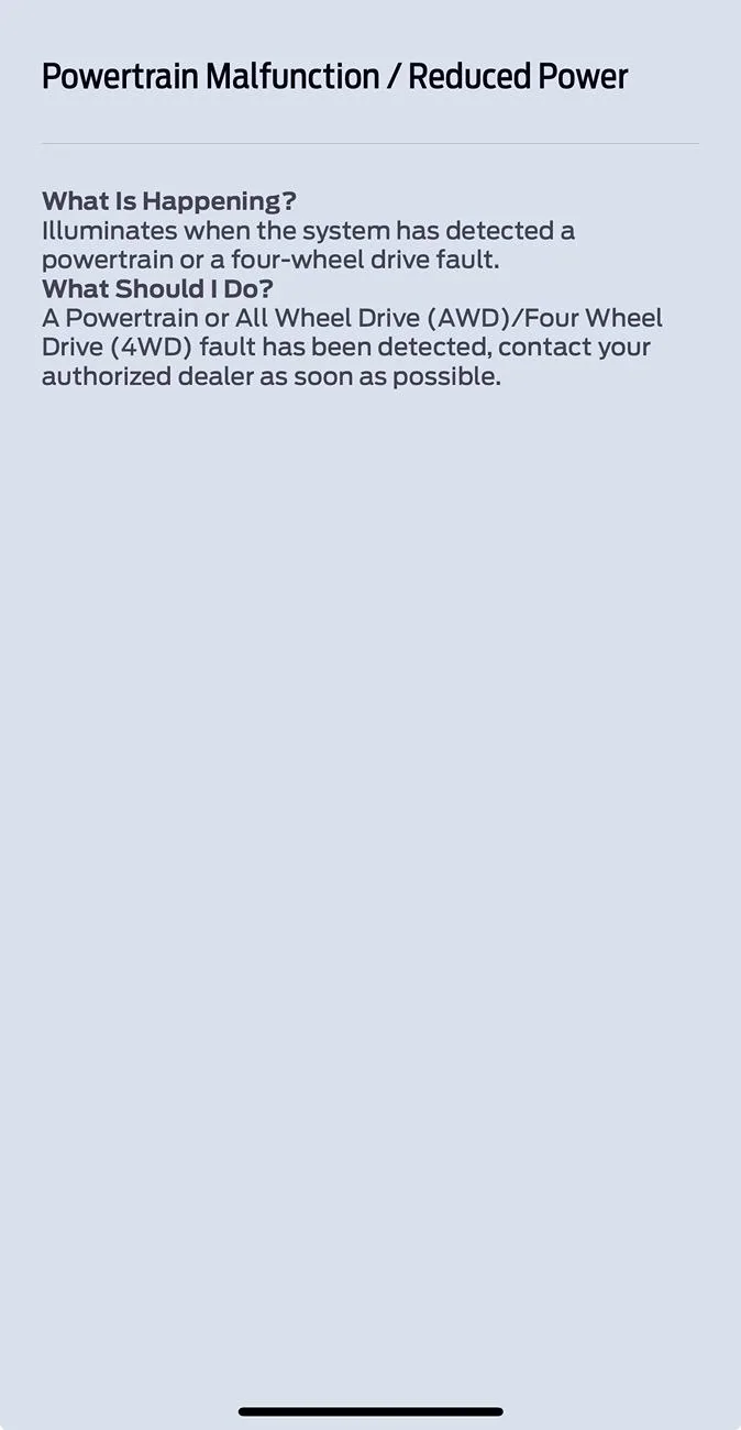

Any one with FDRS able to run my vin to see if this is a one time thing or an issue I need to go to dealer?
My new 2024 gave me a wrench. Hoping nothing
The other day I turned on the truck and I had a wrench light got the push to my FordPass app, four-wheel-drive fault, error, blah, blah blah
Drove to Church parked no problem and when I drove home, wrench was gone no issue since. I only asked because wify has a 21 mache gtpe when we first got it wrench light came on three times and would go away after driving but the fourth time it stayed on and they had to replace a module based off some pin test 🤷🏻‍♂️
Ford F-150 Lightning PTS/FDRS VIN Check Thread IMG_0409

Post or send me the VIN and I'll check to see if I see anything that stands out.

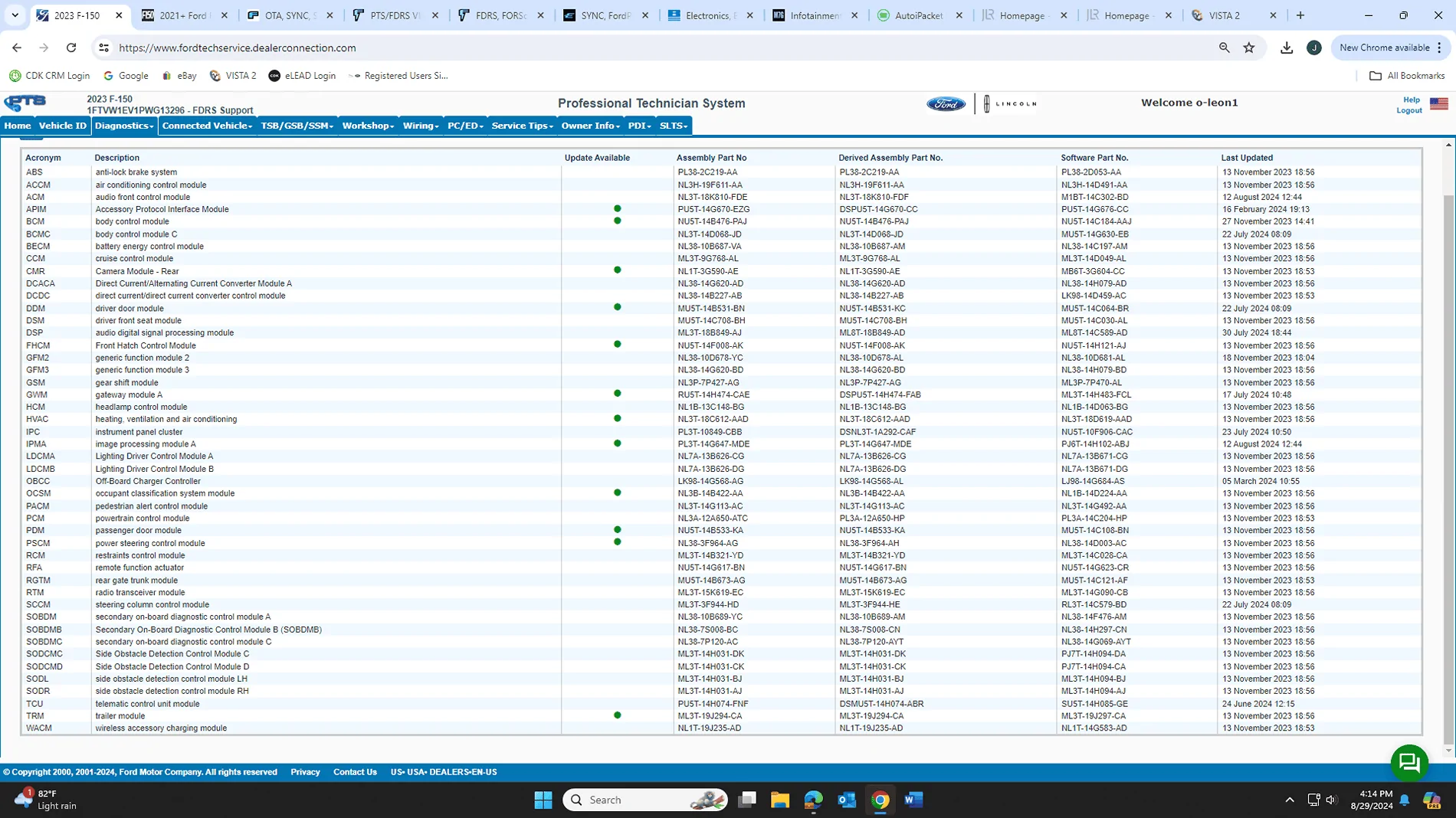

Howdy. my vin is 1FTVW1EV1PWG13296 . can please find out it this has the tesla charger update because I have yet to be successful. Thanks!
OTA history only goes back so far, so I can't see every OTA you've gotten. However, based on the fact that you do not have an OBCC update pending, I am inclined to say you do have the update.

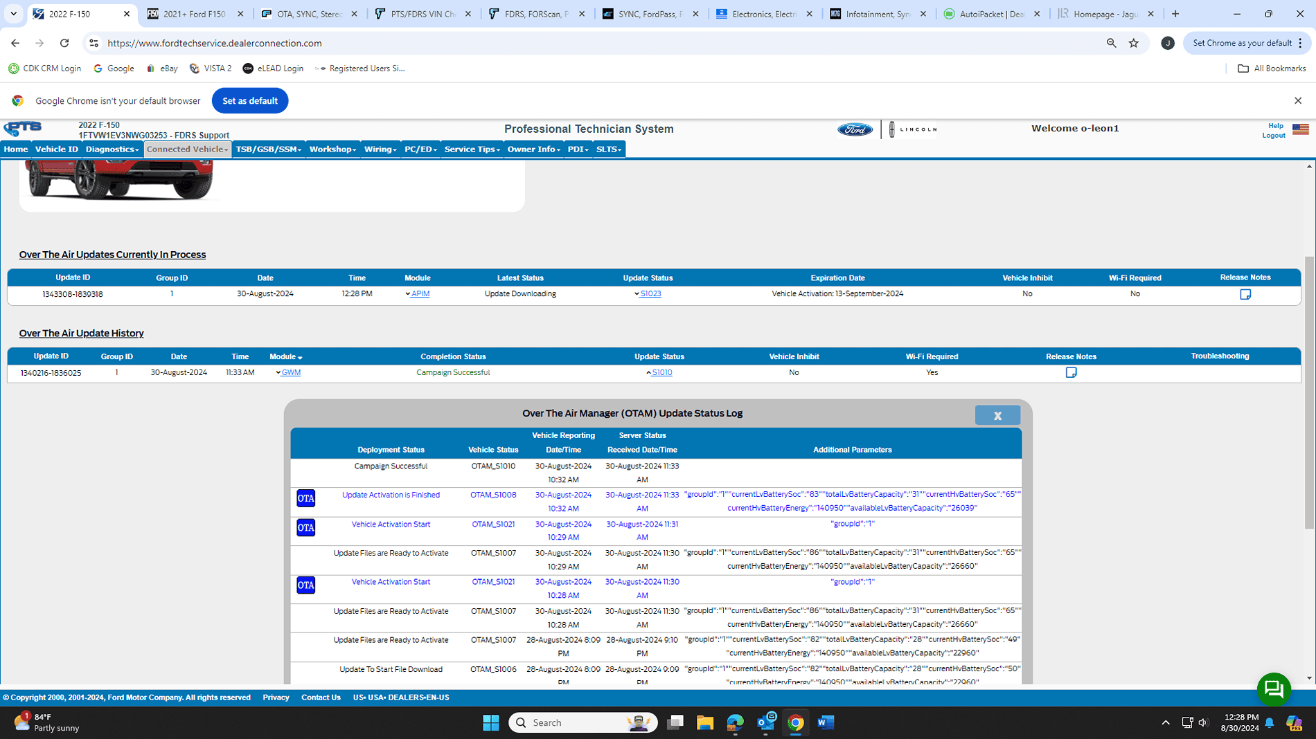

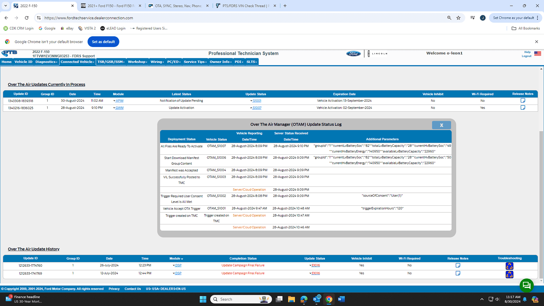

Good morning - wondering if I could get a check on current status - 1FTVW1EV3NWG03253
'22 Lariat - The last update was Audio back in March and it failed. I'm stuck on dowloading for the latest update this week that seems to do a config update. Wifi / no-wifi, rebooting, nothing has made it move again.
You have update and the new 6.14.0 in queue at the same time. The first one needs to go through or fail before the APIM update can attempt. Try rebooting the GWM/TCU with FORScan to see if that helps the config one go through. PTS shows it is ready to install.....can't tell what's holding it up.

Thanks for the feedback. Installed the latest Forscan and headed out to the truck, only to see a message saying the last SW had failed and a new one would be sent. Then I rebooted to No SW, then 6.14 started downloading. So I'll hang with it here and go update the 6.14 thread.
Weird. PTS shows it went through and is downloading the files for 6.14.0 now.
