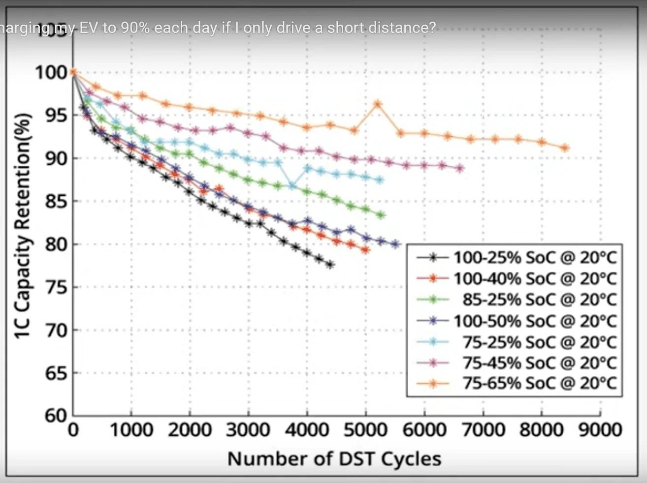

Much of this guys conclusions is based on this chart:
Ford F-150 Lightning Question about real battery capacity, charging to “100%” (notice the quotes) 1703099185420
He says he has talked to people that have published it and he is convince that what they mean by number of Cycles (The X axis) is the number of times each case have gone from top to bottom of their own limits (ex: 75% to 65%) not the equivalent of a full discharge (100% to 0%) which would be 10 times times the cycles for 75% to 65%. If his understanding of Cycle is correct, then his conclusion is incorrect. In other words there is no appreciable difference between these cases if you consider the life of the battery by total mileage.
However if his understanding of the Cycle is incorrect and yellow line goes though charge and discharge 6 times as many as the red line, then there is a reason to go yellow.
