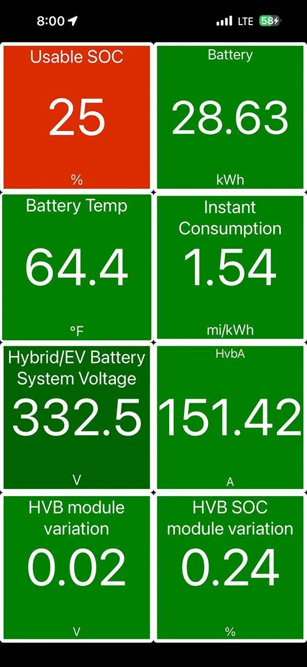

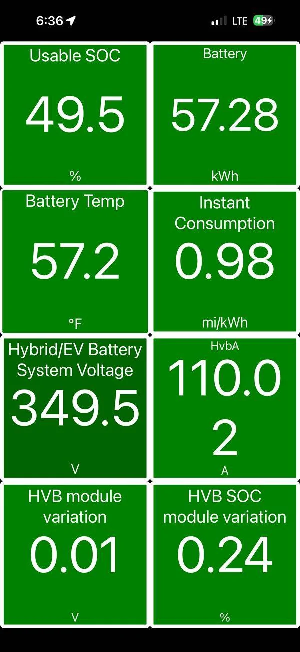

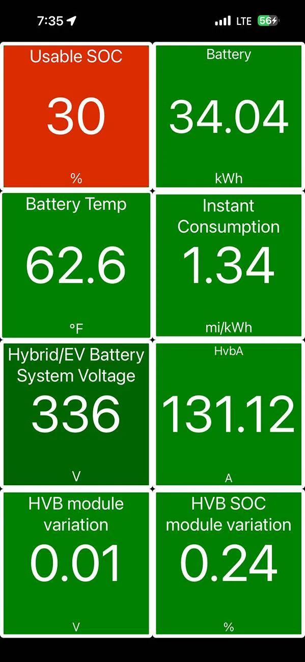

BTW here is screenshots of my dataā€¦.
where is your data?šŸ¤·ā€ā™‚ļø
Ford F-150 Lightning Am I charging to the maximum capacity of the battery and using the buffer? IMG_6754
Ford F-150 Lightning Am I charging to the maximum capacity of the battery and using the buffer? IMG_6769
Ford F-150 Lightning Am I charging to the maximum capacity of the battery and using the buffer? IMG_6761
Ford F-150 Lightning Am I charging to the maximum capacity of the battery and using the buffer? IMG_6770

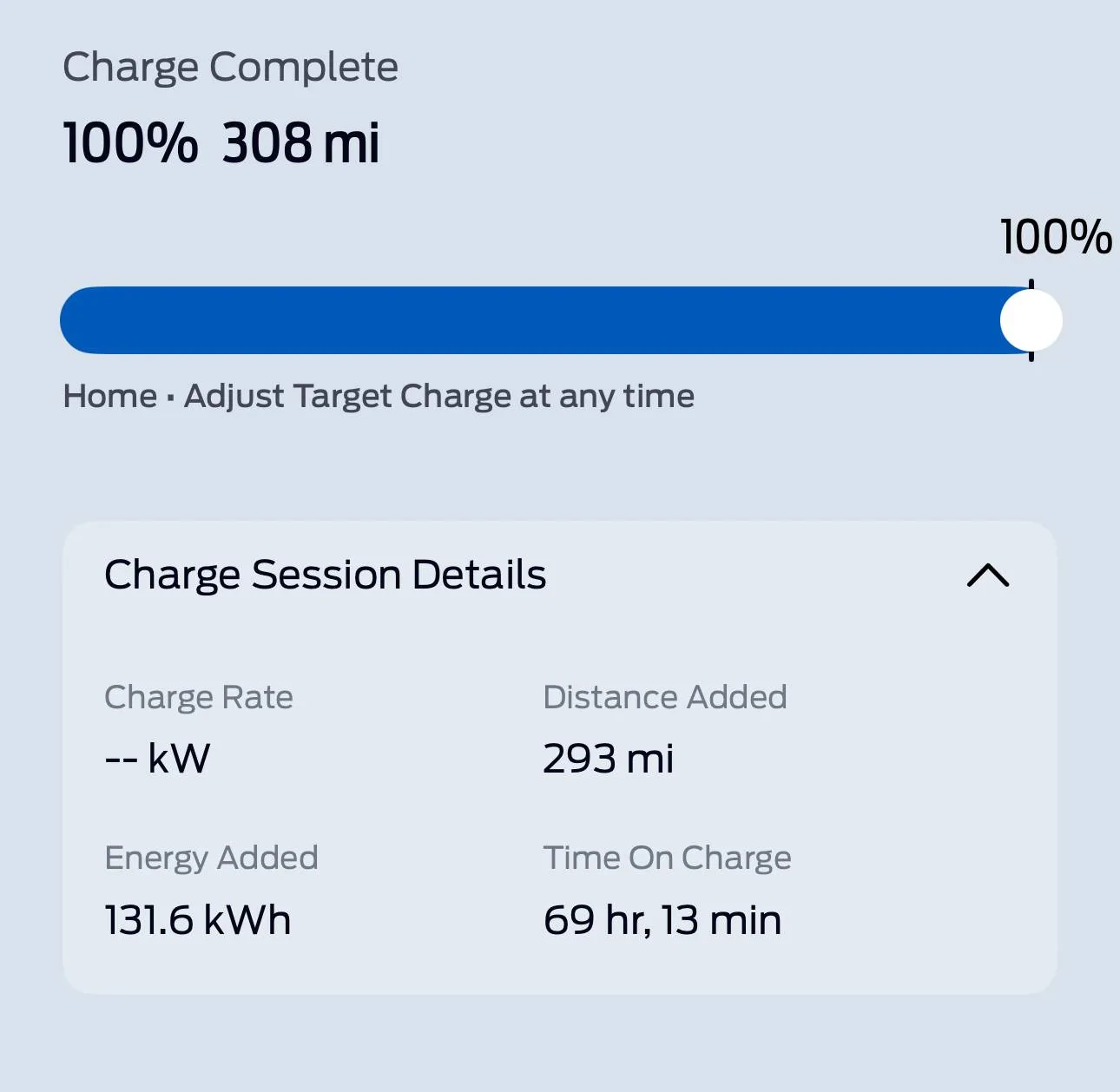

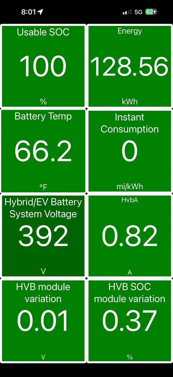

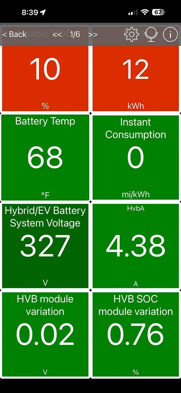

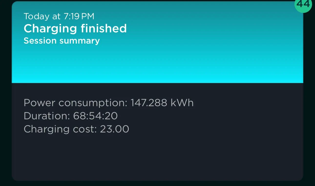

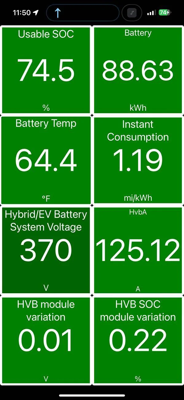

Well was finally able to drain the battery and charge it back up and too balance it. As I was doing some of this while out of town, please ignore the 69 hours that it took as I was modulating my charger remotely to have it finish when I was home.
So drained the truck down to 10% dSOC that was showing 12 kWh in the tank.
Ford F-150 Lightning Am I charging to the maximum capacity of the battery and using the buffer? IMG_6902
Started it at around 10 amps 240v to stretch it to when I was anticipating returning from an out of town trip.
My charger said it was providing power for 68:54 and provided 147.288 kWh.
Ford F-150 Lightning Am I charging to the maximum capacity of the battery and using the buffer? IMG_6937
My FordPass notes shows 69 hours and the truck received 131.6 kWh of power over that time.
Ford F-150 Lightning Am I charging to the maximum capacity of the battery and using the buffer? IMG_6936
From Car Scanner the dSOC is showing 100% and shows only 128.56 kWh in the battery @ 66 deg F.
Ford F-150 Lightning Am I charging to the maximum capacity of the battery and using the buffer? IMG_6939
also looks like the module variation was cut in half.
Battery health is still showing 99.5% @ 17.5 month.
So wish it didnā€™t take as long to actually do it, but battery is closer to what I have seen in the past and ā€œfoundā€ some of the previous lost kWh noted by me and others.
