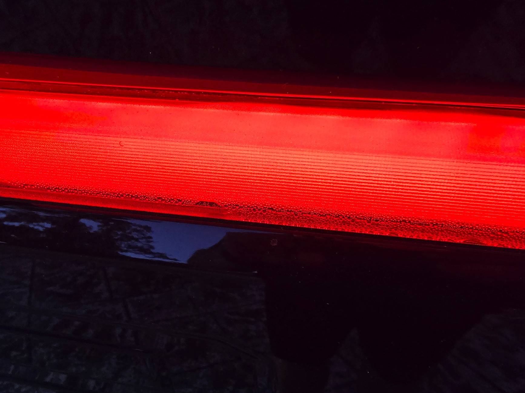

Just dropped my 2022 lariet off for service getting a power train malfunction and decided to get my rear light bar taken care of since it has condensation trapped in it but was told it's not covered under warranty?
Anyone one else have to deal with this? I know there was a recall for 22 and 23 lariats for condensation in the light bar but my VIN doesn't show up under it online.

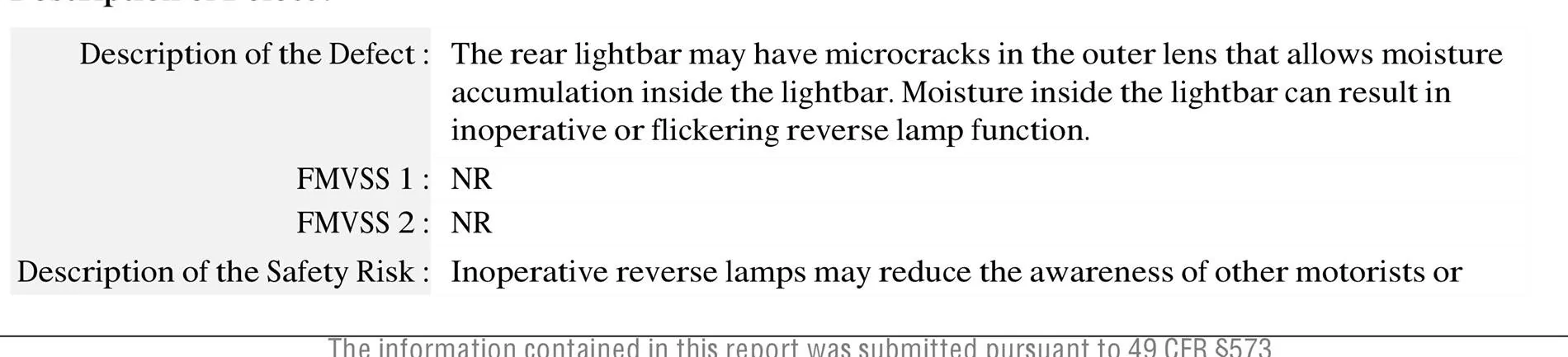

Here’s the official recall:
https://static.nhtsa.gov/odi/rcl/2023/RCLRPT-23V418-7566.PDF
I would first check the part number on the light bar you have. If it matches, I’d point them to the part number and this recall.
If you have the updated light bar, I would file a report with the NHTSA and use the exact same language as what is in the original recall.
Ford F-150 Lightning Rear light bar not covered under warranty? IMG_7190
I’m not a fan of being a pain, but if it was a safety issue then, it is a safety issue now.
That said, I am not familiar with the remedy. It is theoretically possible that the fix prevents the flickering, which makes moisture just a cosmetic issue due to wear and tear and not a safety nor functional issue. If that’s the case I would understand why it wouldn’t be covered.
